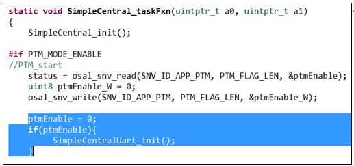

I would like to switch PTM to application (simple central project) by flag.
I follow the guideline to implement UART and PTM on simple central project and also use a flag to disable simple central's Uart when PTM is enable.
UART :(software-dl.ti.com/.../_u_a_r_t_c_c26_x_x_8h.html)
I encounter a problem when I use the following snippets of code.

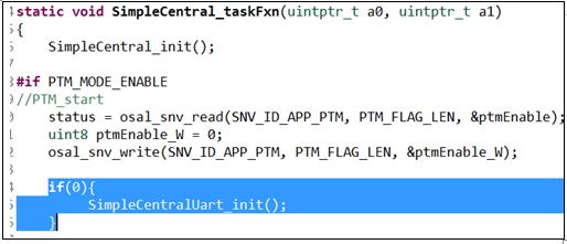

1.if  the if statement is "if (ptmEnable)" and I set ptmEnable to 0, it can not switch to PTM's  UART.
2.if  the if statement is "if (0)", it can switch to PTM's  UART and it  can response HCI command correctly .
Could you please help me to check why PTM's UART  can not when if statement is "if (ptmEnable)" ?

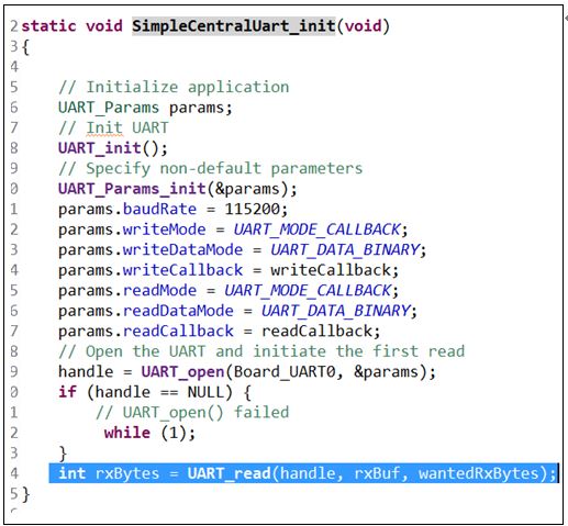

By the way, does simpleCentralUart_init function need to call UART_read ?
<simpleCentralUart_init function>

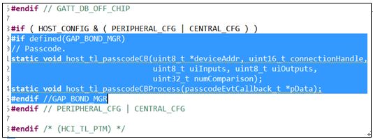

  • Hi Ivan,
    Please see the "known issues and fixes" thread;
    e2e.ti.com/.../770333

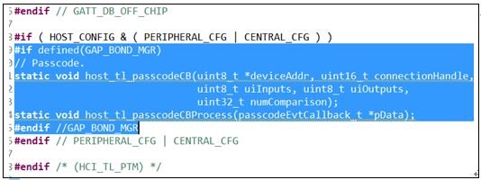

  • Hi Joakim,
    After checked the known issue page, the fixed patch has been implemented in my codebase(simplelink_cc2640r2_sdk_2_20_00_49).
    The problem still happened. Could you please help me to check again?
    <Known issue page>
    <My code in icall_hci_tl.c >
    <My code in simple_central.c>

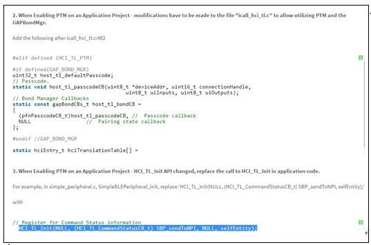

  • Hi. I think there is some missing information from the known issues page. Try also using the following in icall_hci_tl.c when PTM is defined:
    static hciEntry_t hciTranslationTable[] =
      // Controller and Baseband Commands
      HCI_TRANSLATION_ENTRY(HCI_RESET,                                     IDX_CAST IDX_HCI_ResetCmd,                                 HNP,     HNP,     HNP,     HNP,     HNP,     HNP,     HNP,     HNP),
      // LE Commands - Direct Test Mode
      HCI_TRANSLATION_ENTRY(HCI_LE_RECEIVER_TEST,                          IDX_CAST IDX_HCI_LE_ReceiverTestCmd,                       HU8,     HNP,     HNP,     HNP,     HNP,     HNP,     HNP,     HNP),
      HCI_TRANSLATION_ENTRY(HCI_LE_TRANSMITTER_TEST,                       IDX_CAST IDX_HCI_LE_TransmitterTestCmd,                    HU8,     HU8,     HU8,     HNP,     HNP,     HNP,     HNP,     HNP),
      HCI_TRANSLATION_ENTRY(HCI_LE_TEST_END,                               IDX_CAST IDX_HCI_LE_TestEndCmd,                            HNP,     HNP,     HNP,     HNP,     HNP,     HNP,     HNP,     HNP),
      HCI_TRANSLATION_ENTRY(HCI_EXT_MODEM_TEST_TX,                         IDX_CAST IDX_HCI_EXT_ModemTestTxCmd,                       HU8,     HU8,     HNP,     HNP,     HNP,     HNP,     HNP,     HNP),
      HCI_TRANSLATION_ENTRY(HCI_EXT_MODEM_HOP_TEST_TX,                     IDX_CAST IDX_HCI_EXT_ModemHopTestTxCmd,                    HNP,     HNP,     HNP,     HNP,     HNP,     HNP,     HNP,     HNP),
      HCI_TRANSLATION_ENTRY(HCI_EXT_MODEM_TEST_RX,                         IDX_CAST IDX_HCI_EXT_ModemTestRxCmd,                       HU8,     HNP,     HNP,     HNP,     HNP,     HNP,     HNP,     HNP),
      HCI_TRANSLATION_ENTRY(HCI_EXT_END_MODEM_TEST,                        IDX_CAST IDX_HCI_EXT_EndModemTestCmd,                      HNP,     HNP,     HNP,     HNP,     HNP,     HNP,     HNP,     HNP),
      // LE Commands - General
      HCI_TRANSLATION_ENTRY(HCI_READ_BDADDR,                               IDX_CAST IDX_HCI_ReadBDADDRCmd,                            HNP,     HNP,     HNP,     HNP,     HNP,     HNP,     HNP,     HNP),
      HCI_TRANSLATION_ENTRY(HCI_EXT_SET_BDADDR,                            IDX_CAST IDX_HCI_EXT_SetBDADDRCmd,                         HAB,     HNP,     HNP,     HNP,     HNP,     HNP,     HNP,     HNP),
      HCI_TRANSLATION_ENTRY(HCI_EXT_SET_TX_POWER,                          IDX_CAST IDX_HCI_EXT_SetTxPowerCmd,                        HU8,     HNP,     HNP,     HNP,     HNP,     HNP,     HNP,     HNP),
      HCI_TRANSLATION_ENTRY(HCI_EXT_SET_MAX_DTM_TX_POWER,                  IDX_CAST IDX_HCI_EXT_SetMaxDtmTxPowerCmd,                  HU8,     HNP,     HNP,     HNP,     HNP,     HNP,     HNP,     HNP),
      HCI_TRANSLATION_ENTRY(HCI_EXT_EXTEND_RF_RANGE,                       IDX_CAST IDX_HCI_EXT_ExtendRfRangeCmd,                     HNP,     HNP,     HNP,     HNP,     HNP,     HNP,     HNP,     HNP),
      HCI_TRANSLATION_ENTRY(HCI_EXT_HALT_DURING_RF,                        IDX_CAST IDX_HCI_EXT_HaltDuringRfCmd,                      HU8,     HNP,     HNP,     HNP,     HNP,     HNP,     HNP,     HNP),
      HCI_TRANSLATION_ENTRY(HCI_READ_TRANSMIT_POWER,                       IDX_CAST IDX_HCI_ReadTransmitPowerLevelCmd,                HU16,    HU8,     HNP,     HNP,     HNP,     HNP,     HNP,     HNP),
      HCI_TRANSLATION_ENTRY(HCI_EXT_BUILD_REVISION,                        IDX_CAST IDX_HCI_EXT_BuildRevisionCmd,                     HU8,     HU16,    HNP,     HNP,     HNP,     HNP,     HNP,     HNP),
      // LE Commands - Production Test Mode
      HCI_TRANSLATION_ENTRY(HCI_EXT_ENABLE_PTM,                            IDX_CAST IDX_HCI_EXT_EnablePTMCmd,                         HNP,     HNP,     HNP,     HNP,     HNP,     HNP,     HNP,     HNP),
      HCI_TRANSLATION_ENTRY(HCI_EXT_SET_FREQ_TUNE,                         IDX_CAST IDX_HCI_EXT_SetFreqTuneCmd,                       HU8,     HNP,     HNP,     HNP,     HNP,     HNP,     HNP,     HNP),
      HCI_TRANSLATION_ENTRY(HCI_EXT_SAVE_FREQ_TUNE,                        IDX_CAST IDX_HCI_EXT_SaveFreqTuneCmd,                      HNP,     HNP,     HNP,     HNP,     HNP,     HNP,     HNP,     HNP),
      HCI_TRANSLATION_ENTRY(HCI_EXT_RESET_SYSTEM,                          IDX_CAST IDX_HCI_EXT_ResetSystemCmd,                       HU8,     HNP,     HNP,     HNP,     HNP,     HNP,     HNP,     HNP),
