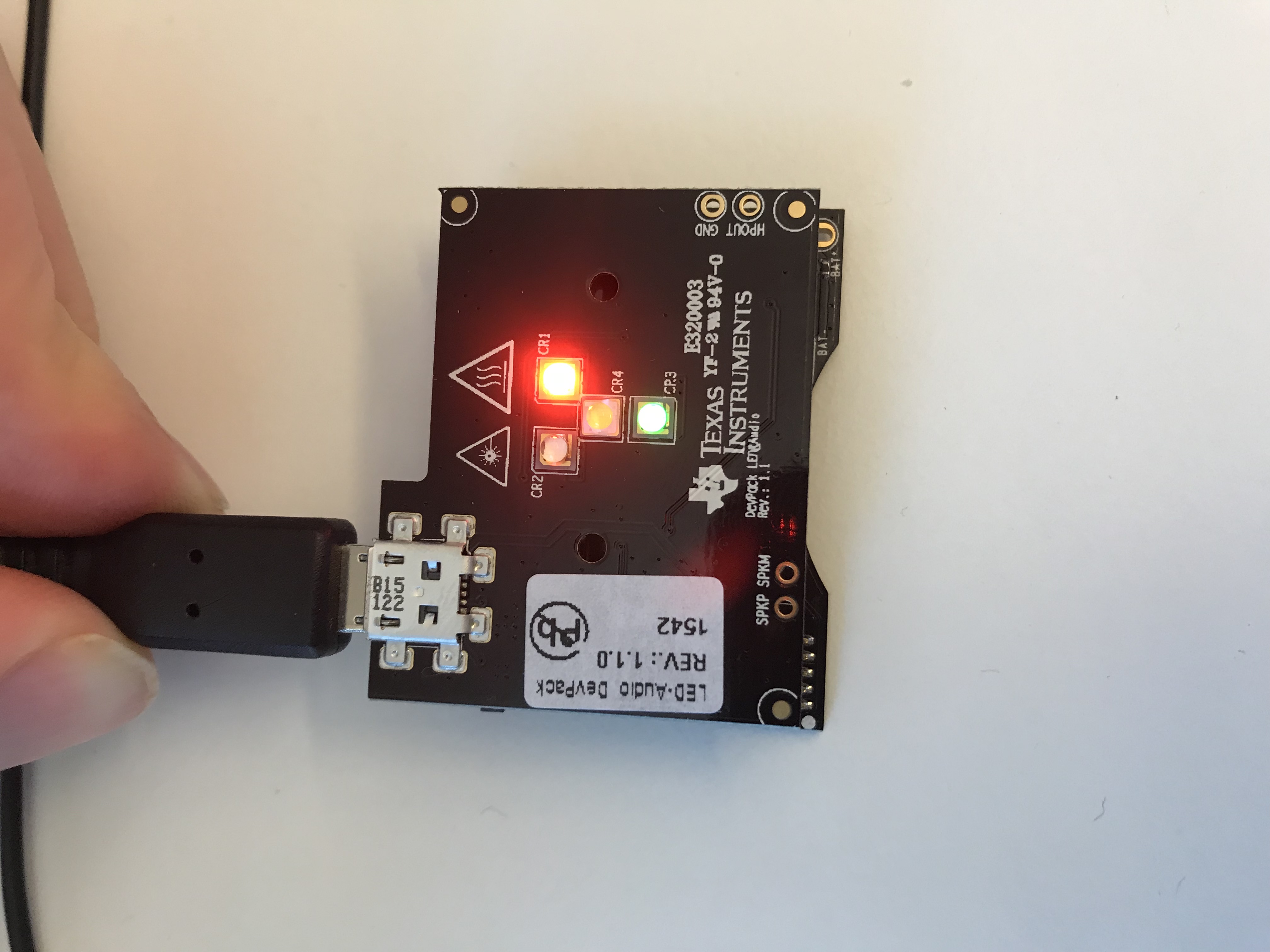

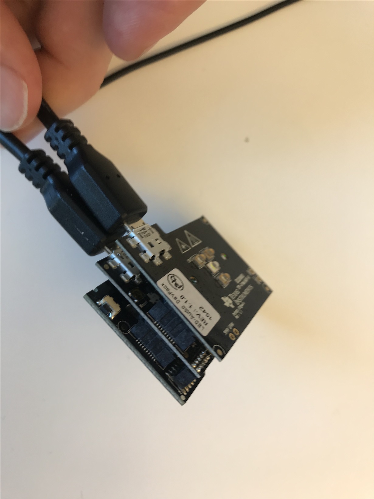

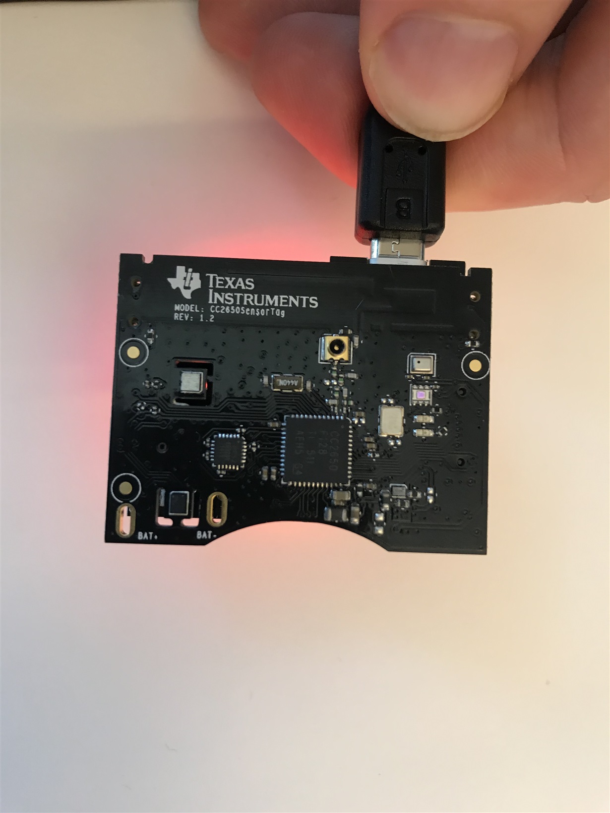

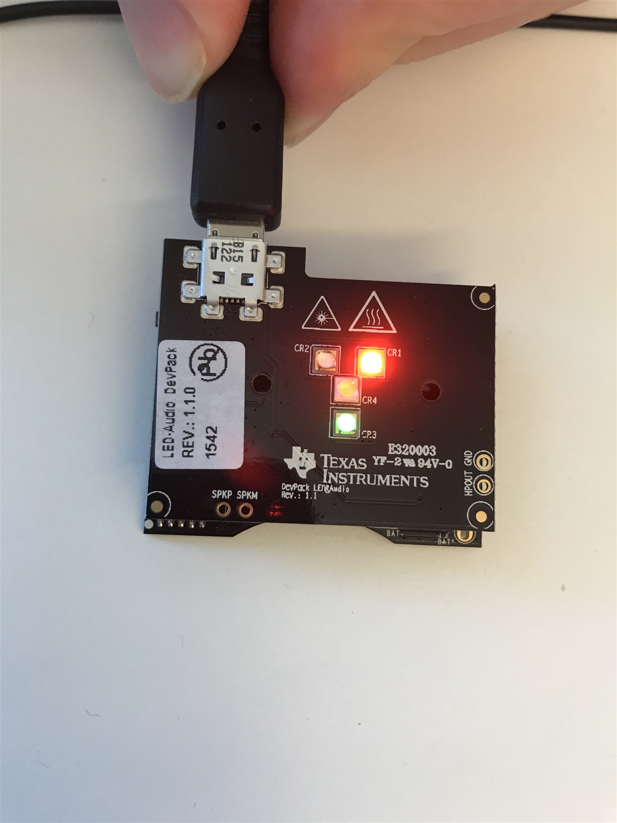

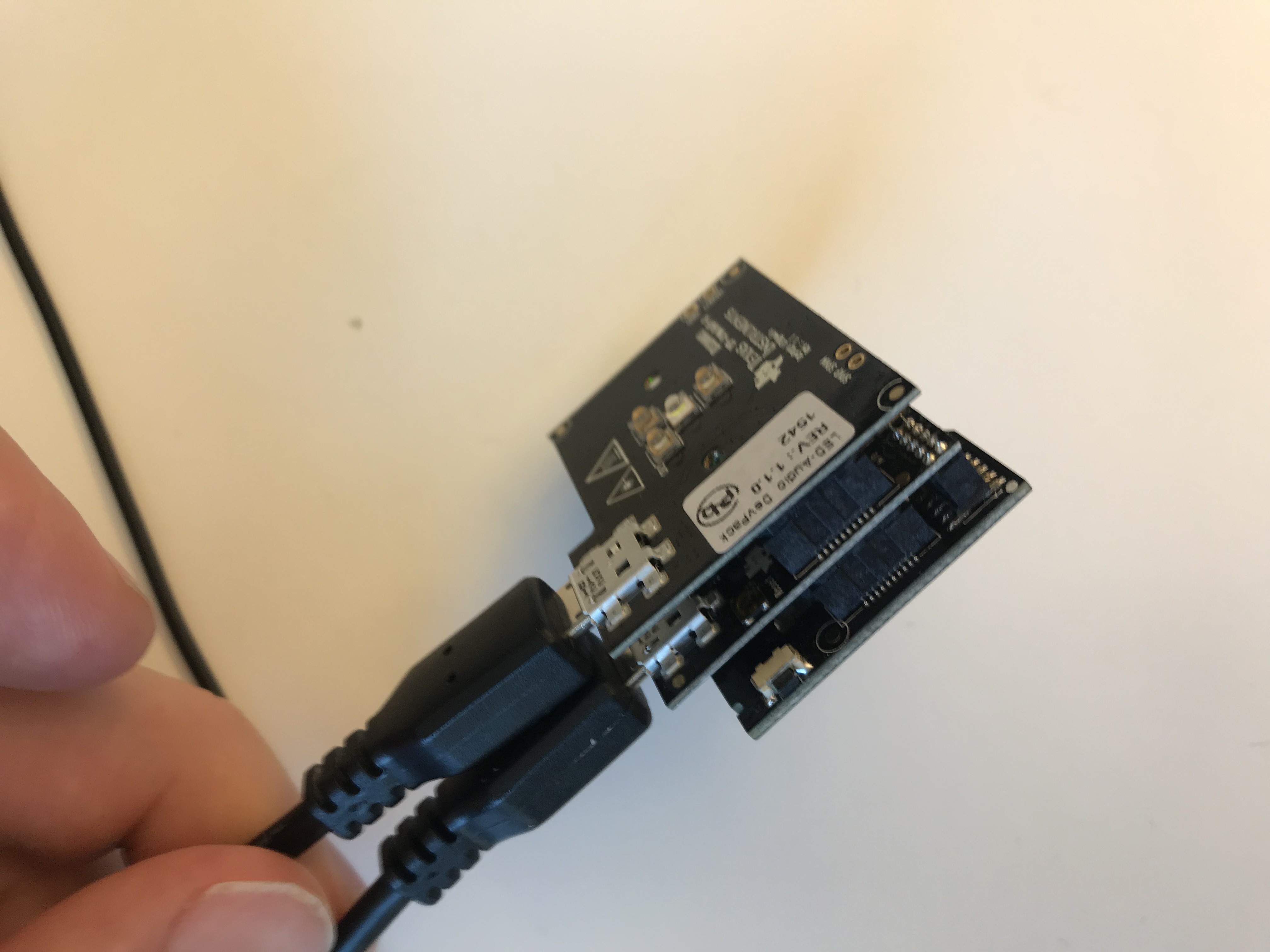

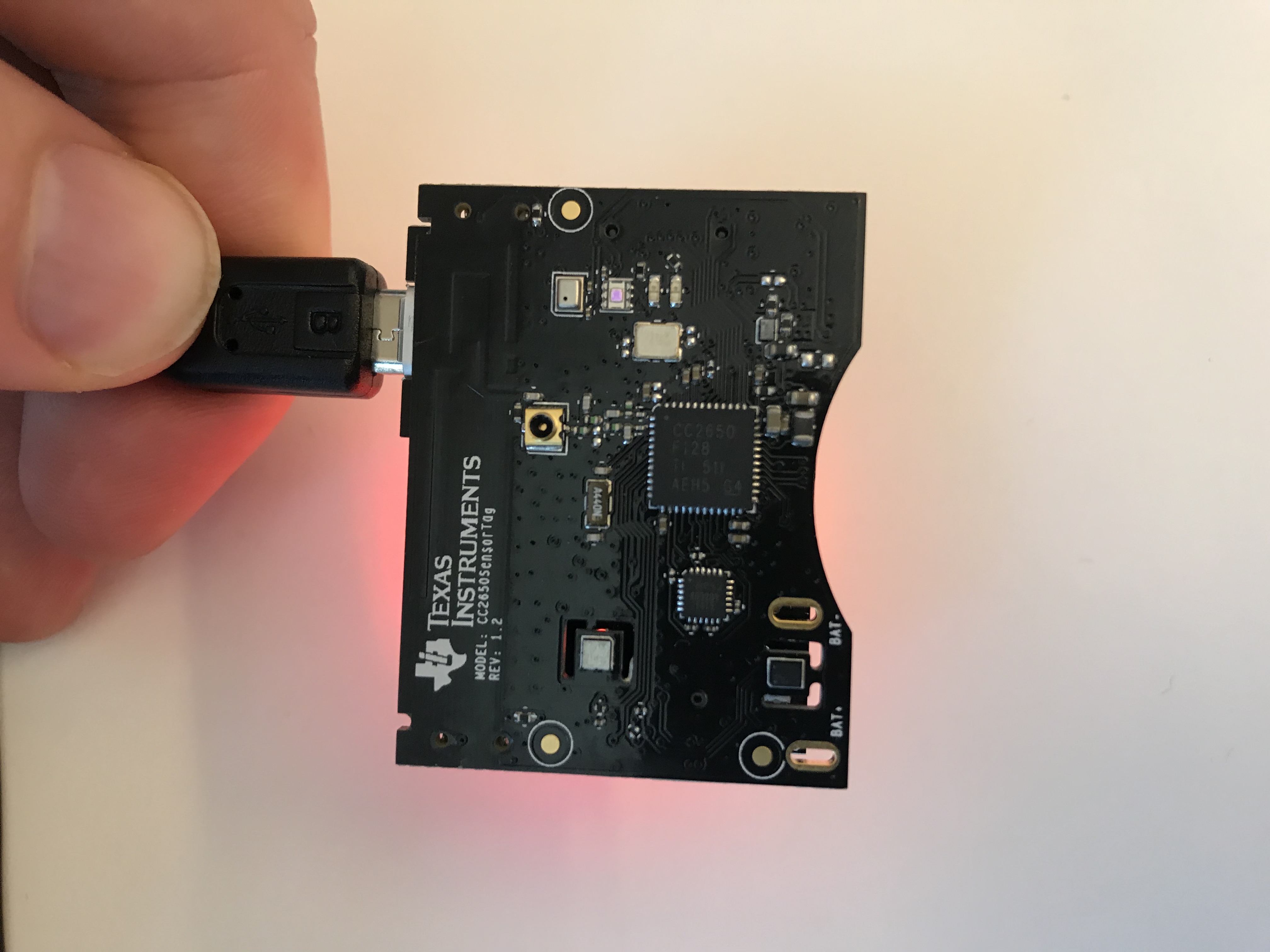

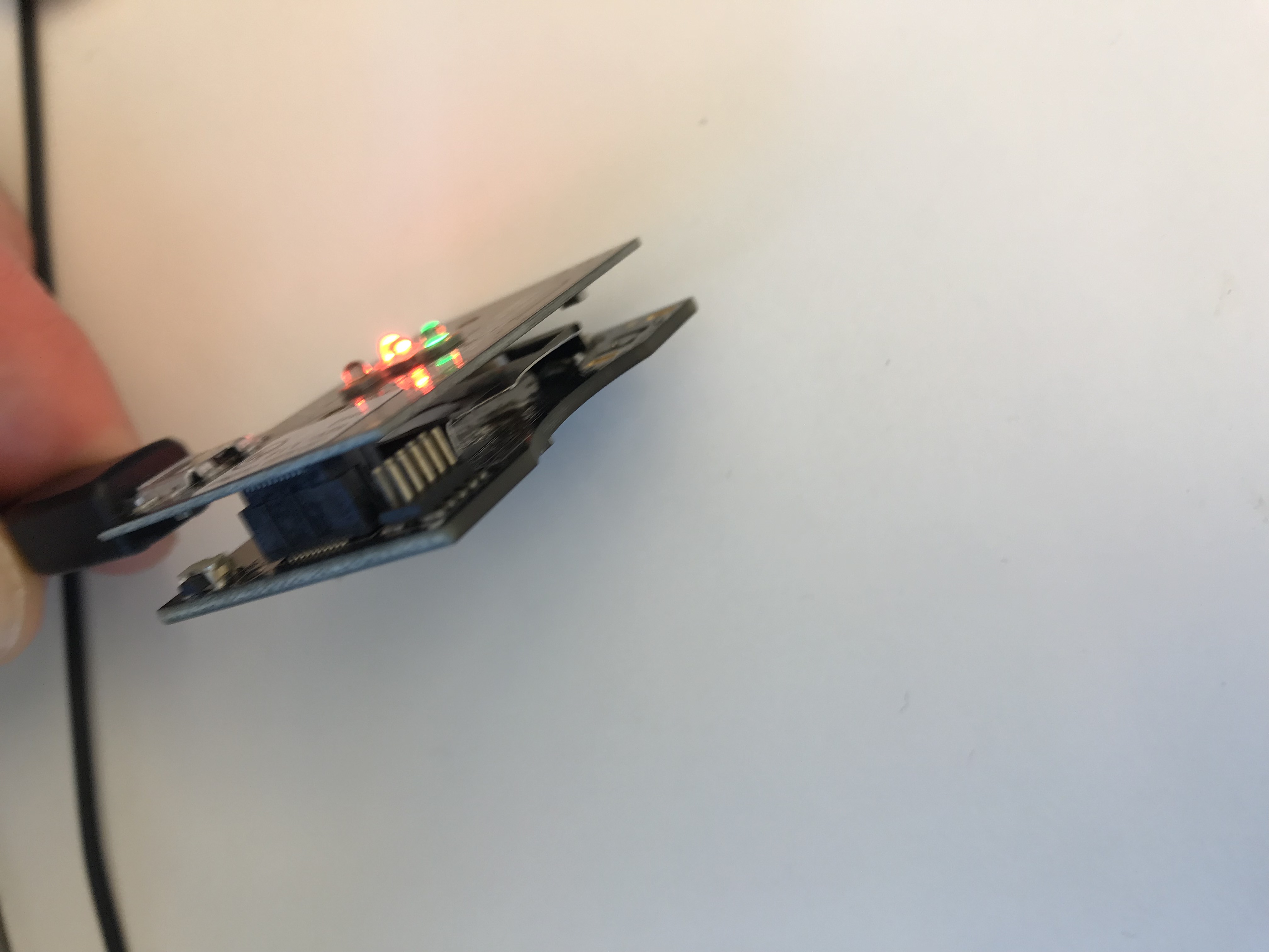

    The reason I asked you to test the latest sdk was in case there was a fix for your issue. I found out there is only a dedicated example for CC2650STK with DEVPACK-LED-AUDIO in BLE-STACK 2.2.1. SO I downloaded it and found some HW to test myself. I could compile, download and run everything successfully with POWER_SAVING enabled. I suspect there might be a power supply issue in your case. The LED devpack needs a separate USB power supply to run successfully. I have attached some pictures of my setup.
  • I used Code Composer Studio Version: 8.3.0.00009 with TI ARM Compiler v5.2.6.

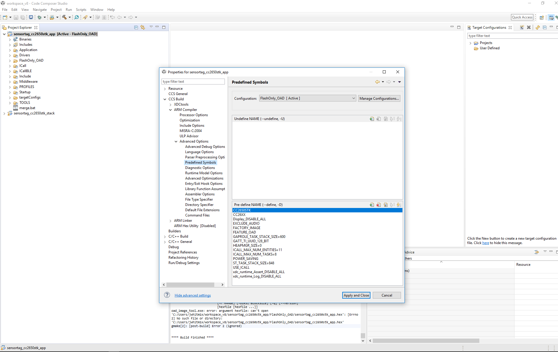

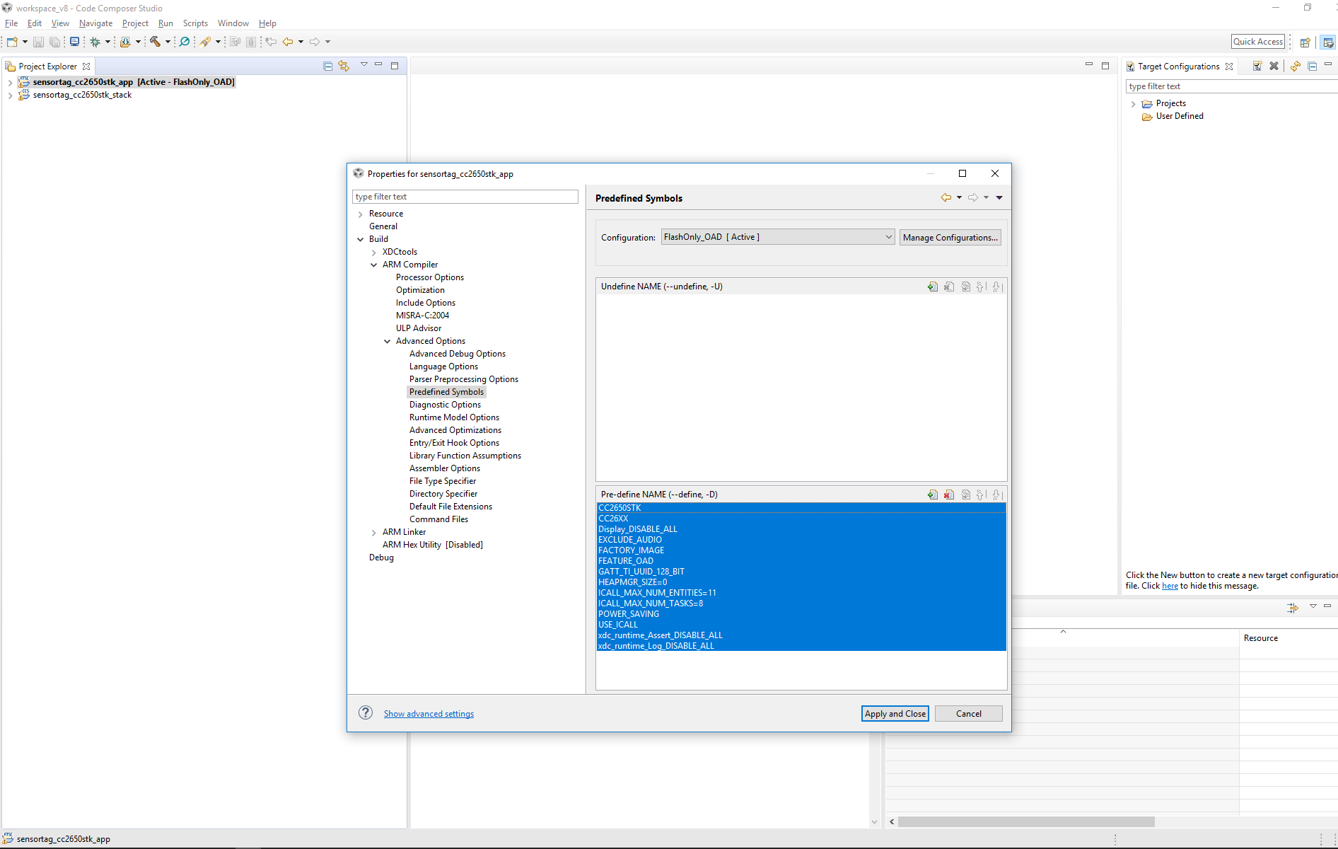

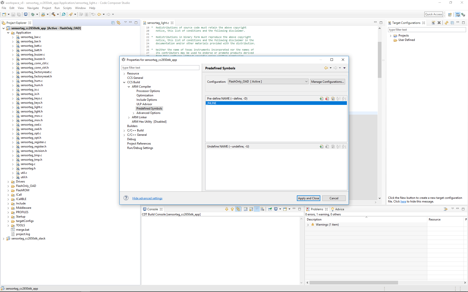

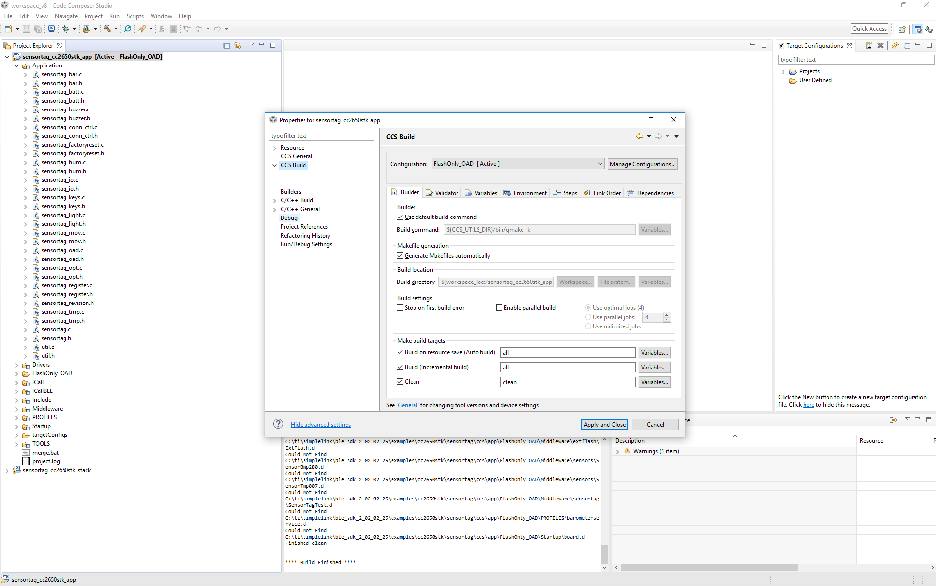

  • Oops - Just to correct my or better describe issues. The default sensortag application does build in BLE SDK 2.2.2.25.
    The problem is when you add "INCLUDE_LIGHT" to the project's properties and add the files sensortag_light.[ch] to the project. When you add those files the project DOES build but it DOES NOT produce an output file to flash.
    So when you augment the project it will build without error but does not produce any output. That might be a problem with CCS? The example project? Or perhaps how I've added sensortag_light.[ch] to the project.
  • I think this might be a CCS issue :(
    When I install the BLE SDK, import the project and build it then it builds fine, and produces output, which I can flash into the device. If I add sensortag_light.[ch] to the project it destroys the project. I can clean the project but after a clean it won't build as there's "nothing to do". Additionally the addition of the files, (without enabling INCLUDE_LIGHT), changes the ability to change project properties. Specifically the "CCS Build" menu has been decimated:
