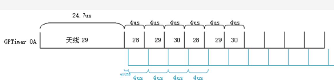

 this is Leison . here one concerns need your help regarding the AoA packet sampling sequence diagram.
above diagram is my understanding for the IQ capaturing diagram .
1.Black draw is the theory time line for every switch when the AoA toggling.
2.Blue draw is the actual time line for every switch when the AoA toggling . and the switch settle down time is accomplished within the 400ns ( DMA9 trigger to GPIO registor 's time). and this 400ns is also included in the every 4us sampling time ?
 if my understanding is not correct .can you pls draw a clear understanding sampling sequence diagram ?
many thanks
Leison

  • Dear Leison,

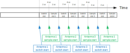

    Your black diagram look correct. Each 4us time slot consist of two parts, one switch slot and one sample slot. In our examples we use 2us switch slot and 2us sample slot. The 2us switch slot includes the time it take from the switching to start until it has settled down.
    Below you see an example with three antennas:
    R.M

  • Hi R.M.
    your diagram i really don't understanding :
    if the sampling duration is 4us with 1/4 us per IQ . there should be another DMA to control the RF switch inside the 4us to prepare for the next antenna 's sampling starting . am I right ?
    if so this DMA work before first 2 us or after 2us donw to start?
    if so this activity will affect the sampling signal ?
    Leison

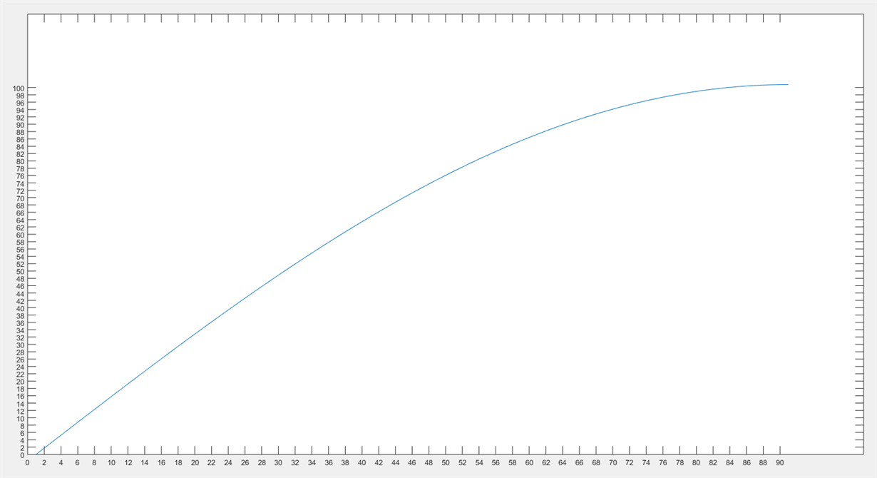

  • Hi  R.M.
      attached is the pic that guildline for the actual angle vs phase difference between our AoA project .but actully when i calculated the phase difference between A1.1&A1.2 . A1.2&A1.3 . it seems the raw IQ we collected is not completely correct: it shows:
      1. A1.1 &A1.2 phase difference  is not close to A 1.2&A1.3.  normally has 20-30 degree gap.what is the reason ?
      2. the phase difference is far away from the standard value of the guildline i attached here . IQ data can't be used directly ?
      3. the raw IQ data should be filterred by some digital signal tools ??
     thanks
    Leison
  • Hi Leison,
    Please find answers to your questions below:
    - The theta values for A1.1 will vary for each sample (typically increase 360degrees/16 per sample). This is the same for A1.2 and A1.3 too. I don't understand you point about 280degrees for A1.2 and how you get 400degrees for A1.3 (max is 360 degrees).
    - LE PHY is using GFSK so the data symbols are filtered with a Gaussian filter but since the CTE tone is a constant 1 symbol this filter do not affect the raw IQ capture.
    - It's the GP Timer that gives trigger every 4us (compare match). This compare match triggers the DMA to write the next antenna switch pattern to the GPIOs. This happens as explained earlier every 4us in the beginning of the switch slot until done with the entire antenna switch sequence.
    No, the raw IQ data can't be used directly. I suggest that you take a look at this SLA:
    dev.ti.com/.../ble_aoa.html
    R.M
