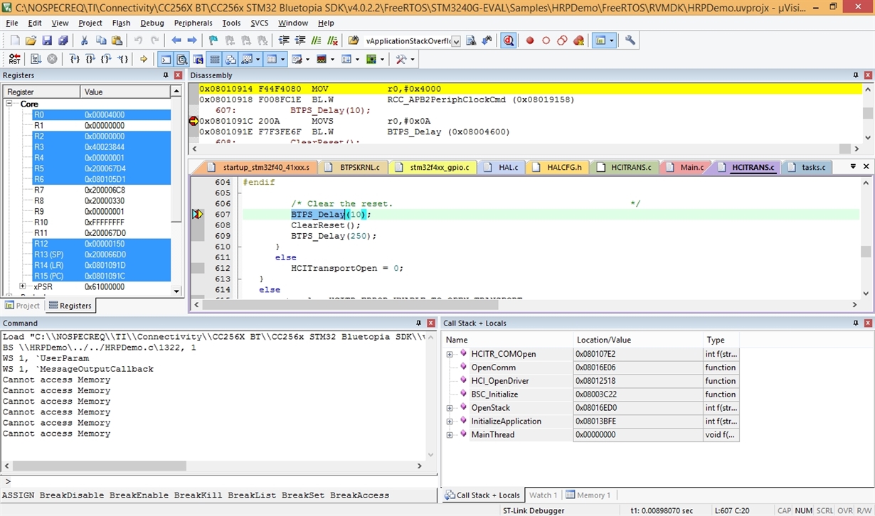

CC2560: BSC_Initalize hangs on CC256x with FreeRTOS
Part Number: CC2560
Same issue as in http://e2e.ti.com/support/wireless-connectivity/bluetooth/f/538/p/446700/1722044
Next debuger step over BTPS_Delay  will cause  HardFault but if next step will be step entering in HardFoult will be postponed.
Heap, Stack memory issues?
