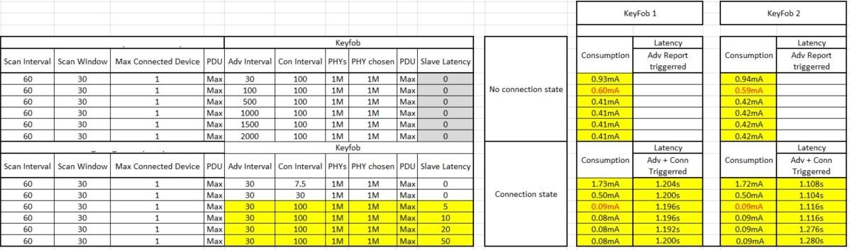

We are checking the power consumption on FOB(peripheral device) with the below conditions.
By the way, there are no big differences between different slave latencies.
I confirmed that the response status of connection parameter update request. You can see the log data through attached log data and pictures below.
Current SW is based on TI SDK simplelink_cc26x2_sdk_2_20_00_36 and POWER_SAVING mode is on.
Even though two devices are in a connection state and connection events continue to occur, I thought that the power consumption should be different according to the slave latency.
Why no big differences at all?
If any, let me know.
Through analyzer, we can confirm that the slave latency operation works.
 8117.slave latency check.zip

    Regarding the slave latency configured, I attach again with a picture instead of excel sheet table to see easily. And slave latency configuration is mentioned on the table with yellow color I posted.
    And, I confirmed that the slave latency and connection interval changes from peripheral device side work well.
    And Master side didn't override it because master just accepts. Just so you know, when more than 1 peripheral device are connected with master side, it will be override.
    Also, as you can see, there are no big differences in terms of power consumption between different advertising intervals conditions without connection state.

    How are you measuring? What type of equipment do you use? There could be an issue with accuracy in the instrument used.
    I checked the sniffer log and can confirm that the slave latency is set to 50 as you described.
  • our HW engineer used Fluke multi meter and Agilent DC Power Analyzer to measure the current consumption of the fob.
    Ji-won

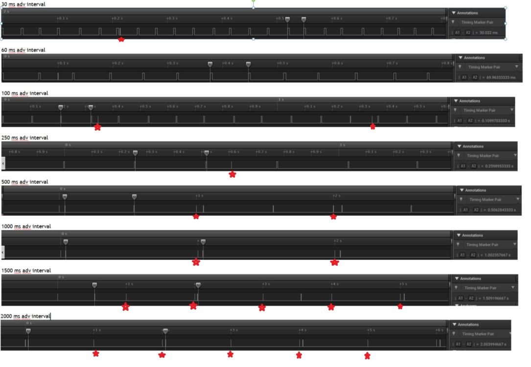

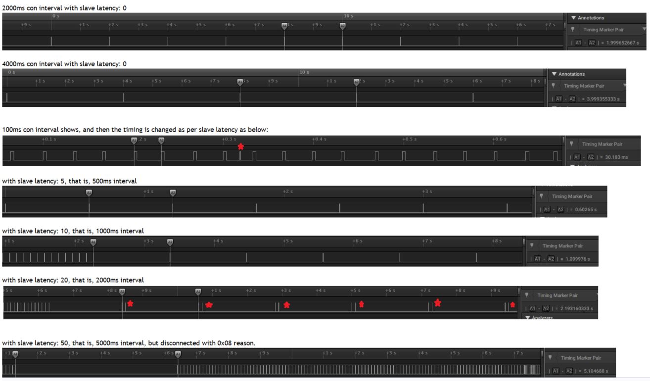

  • Hi Eirik,
    I added GPIO toggle to check if the power saving mode(stand-by mode during advertising or connection state) works well or not.
    So, after POR, it will get high in main(), whenever entering power saving mode, it will get low and high shortly in PowerCC26XX_standbyPolicy() in PowerCC26X2_tirtos.c.
                    /* go to standby mode */
                      TurnOffGPIO(0);
                    Power_sleep(PowerCC26XX_STANDBY);
                      TurnOnGPIO(0);
    I can capture the timing as per adv interval. They match with the adv interval, but, one pulse between the intervals is ticked, I need to understand why it is kicked off. please refer to red star.
  • Hi Eirik,
    Our HW engineer checked at wrong points, so I will close this question.
