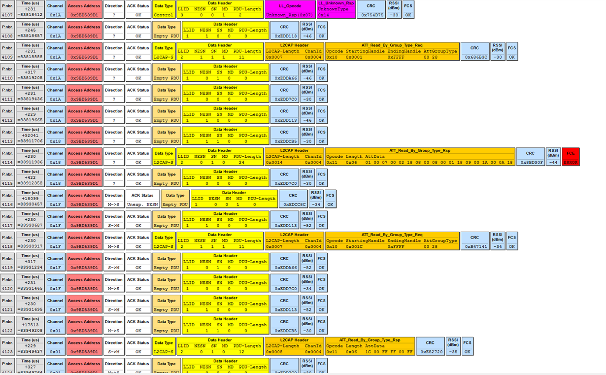

CCS/CC2640R2F: Program crashed when turn off the optimization
Part Number: CC2640R2F
Hi
I have been working on CC2640R2f LP based on simple_peripheral example, and my SDK version is simplelink_cc2640r2_sdk_2_30_00_28.
I have been trying to make the BLE Stack, DMA and PWM work together, but I found out that for some reason I cannot reconnect to the peripheral after uDMAChannelTransferSet and at that time timers haven't be set yet.
After some experiments, I noticed that if I set optimization level to 4 ,the program can work properly. What I am curious about  is that I have tried modifying task stack size and C system stack size before, and it changed nothing. So I would like to ask that what else need to do to make my program work with optimization off.
Wish all help
Alex

  • Hi Alex,
    In addition to looking at the task stacks, you can look at the ICall heap when this happens. Link:
    Did you try pausing the debug session to see if the application has run into an exception?
    BTW, here is a small example of how to use DMA with PWM:

  • Hi Marie H.
    I finally got a sniffer and here is the log.If you want some more detailed, I also uploaded a psd file.

  • Hi Alex,
    Thank you now I was able to download it.
    From the sniffer log, it seems like the slave device stops answering to connection events after packet 4211. The master keeps sending connection events.
    What happens on the slave side? Is it a HWI exception? (Can you try using a debug session and pausing when this happen.)

    I didn't release dependencies because I just used it to reproduce the issue, and the device will stuck upon next connection so I don't think whether release dependencies or not is the cause to this issue.
    I have tried several  android phones and with some of them can reproduce the issue while with the others I cannot connect to the device even for the first time.
    So I think you can get ble scanner from Google Play with a handy  android phone and perhaps you may reproduce the issue.
    To be clear, I tested with Meizu 15 Plus for the most times.
