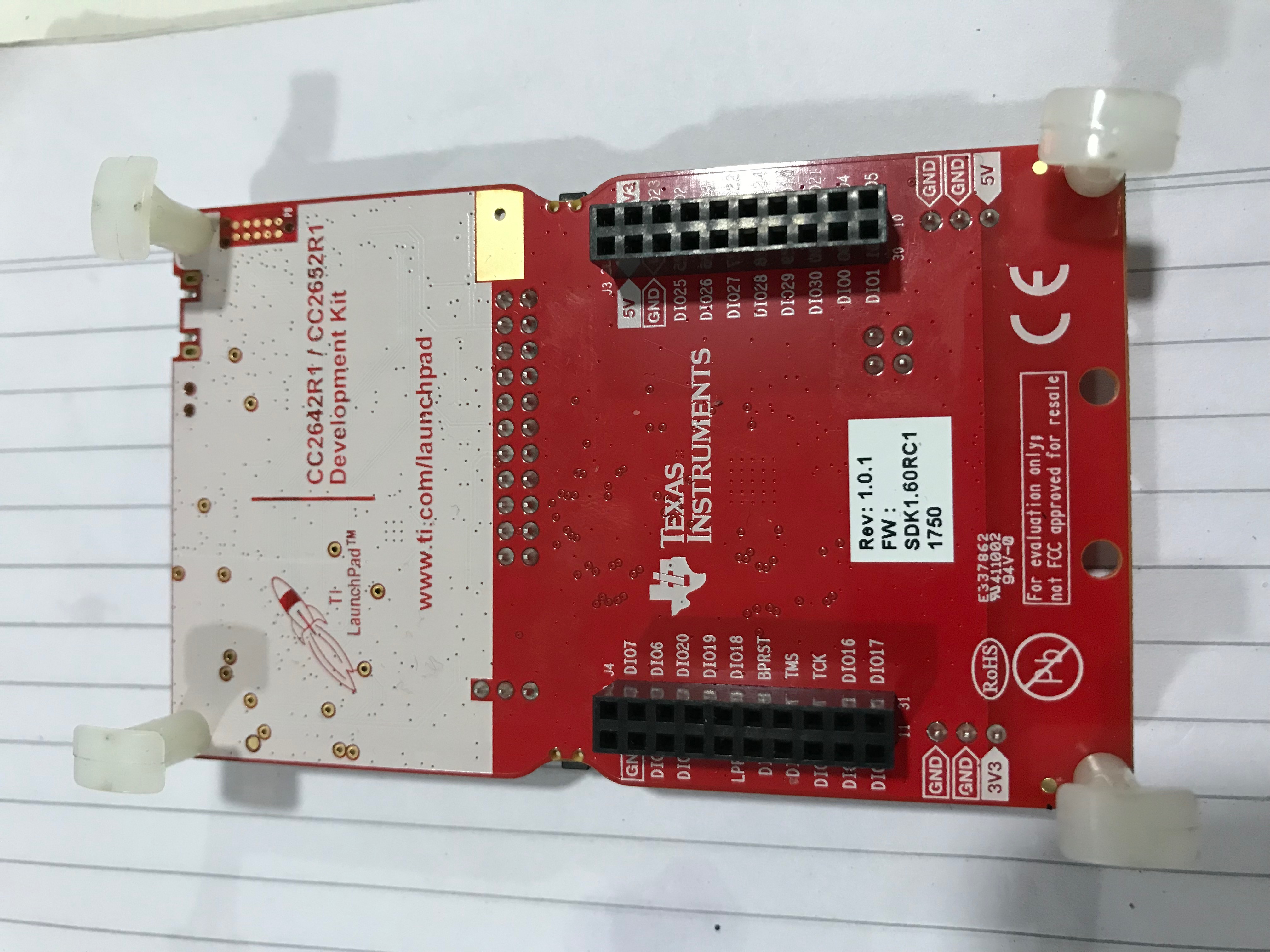

  • Hi J Lindh,
    I tried new SDK V3.10 (simplelink_cc13x2_26x2_sdk_3_10_00_53). But i am not able to run the default code or even simple peripheral default hex file with my launchpad.
    My launchpad details below:
    CC2642R1/CC2652R1 Development Kit
    Rev: 1.0.1
    FW: SDK1.60RC11750
    Can you please help here? I tried to debug the code, it build successfully not giving any error but not advertising or doing any thing. This issue coming with sdk V2.40 and V3.10, but older sdk V2.30 built working succesfully.
    Please find some attached screenshots.
    Your launchpad is featuring the engineering release of the CC2652R. I would recommend you get a new revision launchpad which has the silicon version compatible with SDK 3.10/2.40.
    Aslak
