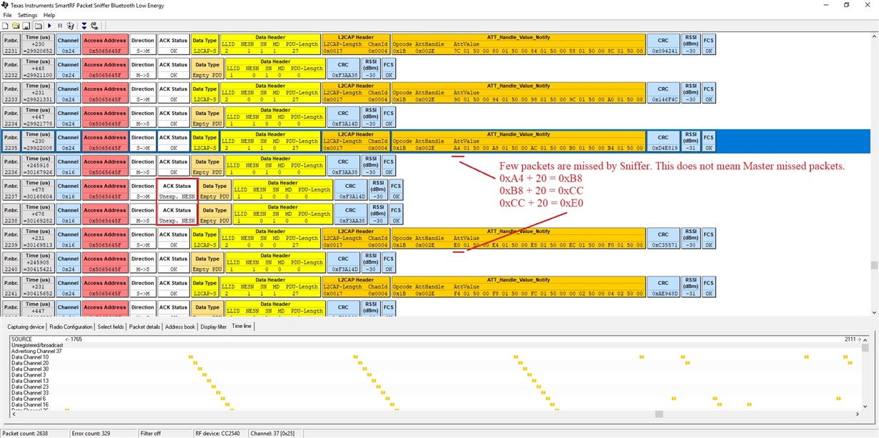

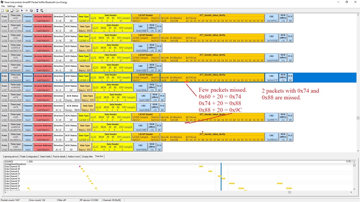

    4) With respect to Notification, I did few experiments. I kept Connection interval min/max as 10ms and 250ms. In each packet I am sending 20 bytes. I see few packet misses. As show in below snapshot,
    0x24 + 20 = 0x38
    0x38 + 20 = 0x4C
    0x4C + 20 = 0x60
    After 0x60 I am seeing only 0x9C. Here two packets are missed. Is this something not able to buffer at stack level. If yes, how to detect the error conditions. As part of GATTServApp_ProcessCharCfg() under SimpleProfile_SetParameter() do I need to pass "taskID" as simpleBLEPeripheral_TaskID rather than INVALID_TASK_ID.

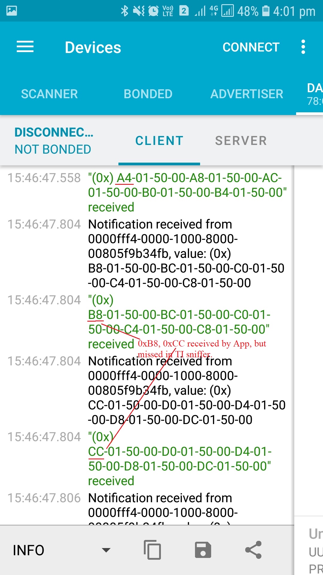

    4. In your screenshot, I see that packet 1038/1039 show Unexpected NESN, which means that the sniffer actually missed the packets. Are you able to populate an array or such on the receiving side to verify?
    Thanks a lot. I got what you meant. TI sniffer may miss few packets receiving. This does not mean App did not receive. I saw the log file and all packets are received.
