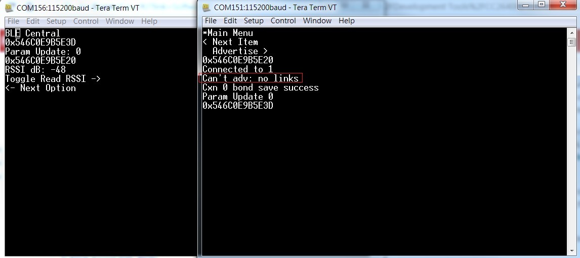

  • I connect the Multi Role with my BLE Scanner. When this it connect, the Simple-Central not found device
  • When it connects with your BLE scanner, does multi-role send advertising for simple_central to scan/connect?
  • I connect APP -> MultiRole and it works. Now I click on BT1 of Simple-Central for discover the device, but not found nothing.
  • Do you use sniffer to check if your multi-role sends adverting when it connects to your APP.
  • My goal is to connect SimpleCentral to Multirole. I have to turn on the multirole LEDs via the simplecentral. These are always connected to each other. If I come with the phone, it doesn't find the MultiRole. But is it possible to make this type of connection?

  • As J Lindh asked, what does it show on UART output?

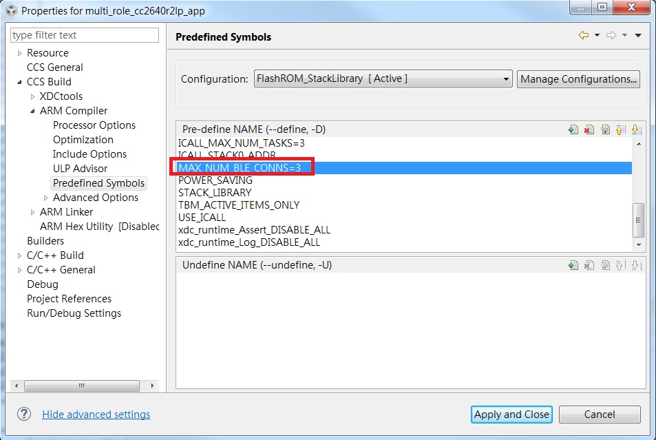

  • I test multi-role example in simplelink_cc2640r2_sdk_2_40_00_32 connecting to simple_central and I can see the same issue as Mark raised. I see "Can't adv: no links" on multi-role UART output as in the following picture after multi-role connecting to simple_central. Can you help to verify and provide fix for this?
  • I find that after multi-role calls "GAPRole_StartDevice(&multi_role_gapRoleCBs, &maxNumBleConns);", maxNumBleConns will change from 3 (the default value) to 1 and this causes the problem. I suspect this is heap issue. Can you help to verify this?
  •   I find MAX_NUM_BLE_CONNS in predefined symbol is set to 1 and causes this issue. After I change it back to 3 in predefined symbols. I can connect multi-role to simple_central and SimpleLink Starter APP simultaneously.
    @Mark Please check if MAX_NUM_BLE_CONNS in your predefined symbol is set to 3. If not, change it and test again.
  • Hi YK,
    Seems like you found the solution. Mark, please confirm.
  • yes, it works.
