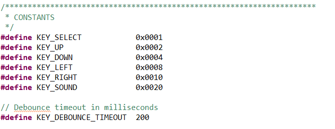

    Thank you for your response. I referred to the SimpleLink Academy and a few other tutorials. I made a few modifications to the multi-role program to interface my sound sensor. My aim is to connect the signal output of the sensor to GPIO pin 0 in CC2650 LP. Once the sensor detects a sound impact, it sends a pulse in PIN 0. On receiving this signal, the GATT write operation should send a unique value (I just hardcoded it as 255) to the Master device (which is another CC2650). When I did this setup, my peripheral device sends the unique character irrespective of whether there is a sound impact or not.
    Modifications made:
    1. Created a new variable "KEY_SOUND"  with value 0x0020 in board_key.h

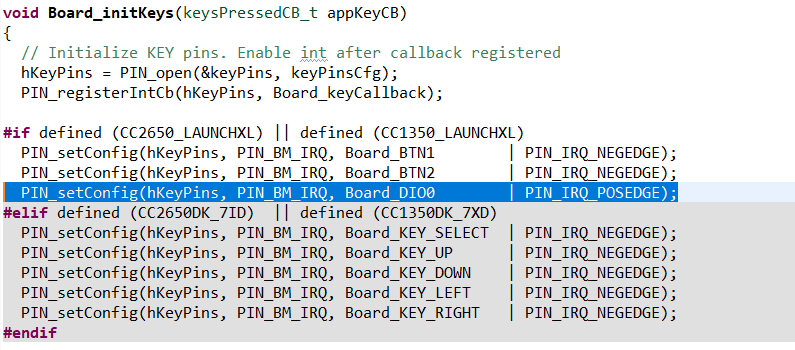

    2. Added the GPIO pin in the Board_InitKeys function - PIN_setConfig(hKeyPins, PIN_BM_IRQ, Board_DIO0        | PIN_IRQ_POSEDGE);

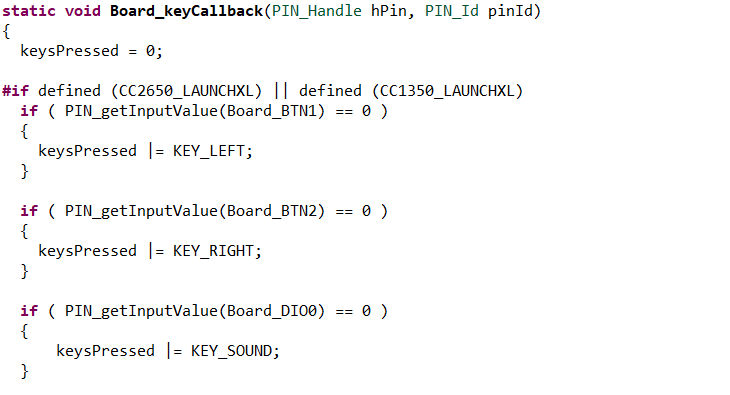

    3. Added the GPIO pin in the Board_keycallback function
    if ( PIN_getInputValue(Board_DIO0) == 0 )
    keysPressed |= KEY_SOUND;

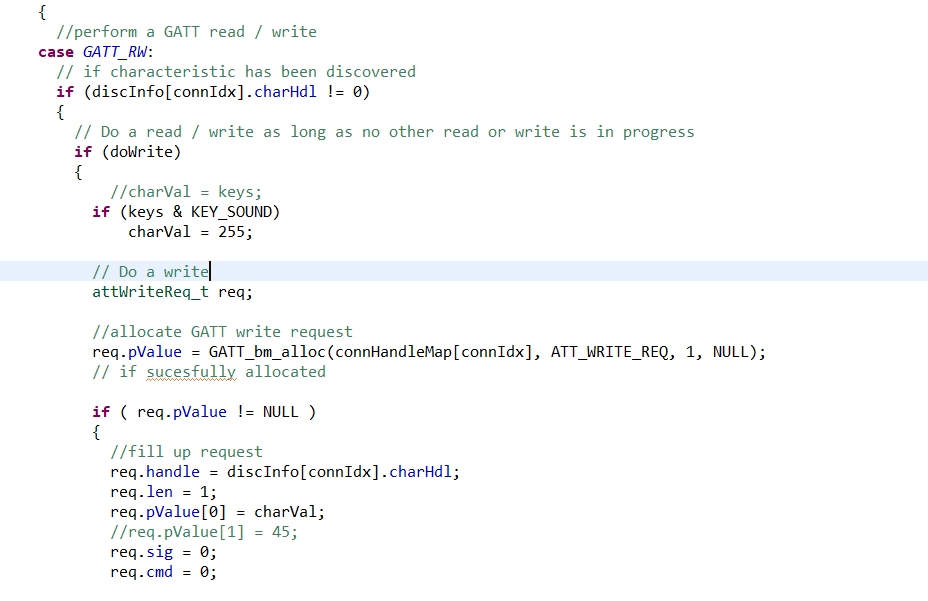

    5. Added an if condition in the GATT_RW case under CONN_MENU: (in multi_role_handleKeys function)
    My approach is almost similar to the method used in multi-role program for BTN_RIGHT and BTN_LEFT.  When I remove the sound sensor connection to the GPIO pin 0, My if-condition fails which is expected, but when I connect the sensor to the GPIO 0 pin, my if condition passes irrespective of whether the sensor produces output or not.

  • I figured out the mistake, It is in board_key.c file, I performed keysPressed |= KEY_SOUND; when the GPIO pin gives 0, which it always does when the sound impact is not detected. On changing this to 1, the behavior is as expected.
