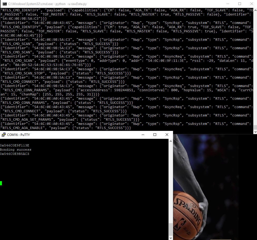

We are getting results for a tag then terminate link and connect the second tag then get results for the second tag. When we just run the python script it takes ~30 seconds to get results for the first tag.
Then we connect to the second tag and we wait again to get results. After the first time, it only takes ~2 seconds to get the result. We terminate link, connect new tag and get the new results very quickly. When the new tag comes in the test environment and master connect it too, again we wait for ~30 for the first time, then it gives results quickly too.
This process is same for every time so why does first time take so long?
Why does it happen? If there are 20 tags then we will wait for 10 minutes to get results from all. How can we solve this problem?

    We tried both of those, but we couldn't see raw data. Then we sniffed connections and we saw empty PDU s are coming from slave to master as expected. But passive can't see this and don't give us results. Sniffed data is here
    withoutPairing.zip
    Are the changes we did correct? If yes, why we cant get the raw data? And what we should do to get raw data?
    Thanks.

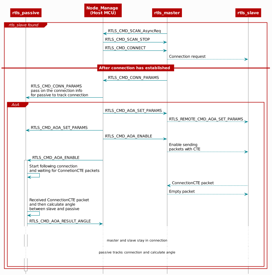

  • Thanks for the reply. Without enabling bonding or disabling pairing system is working fine. Then I enabled bonding and run it again, slave gave "Bonding saved" message after pairing, also it gave the raw data. Then I terminate the link and rerun it, slave said "Bonding success" but it doesn't give us raw data. I tried many times and I saw same thing always. What should I do?
    This is likely because the rtls_master currently doesn't support bonding and thus it isn't the L2CAP connection oriented channel (CoC) between master and slave which is used to comunicate AOA start.
    Please see: RTLSMaster_processPairState().
    I would add handlers for GAPBOND_PAIRING_STATE_BONDED and GAPBOND_PAIRING_STATE_BOND_SAVED to open the CoC using RTLSMaster_openL2CAPChanCoc() and inform of connection using RTLSCtrl_connResultEvt().
    You can essentially copy the logic that is already there for GAPBOND_PAIRING_STATE_COMPLETE
  • That resolved everything, thank you so much, we can also get data without pairing. Reason of duplicate question is that sometimes reply time takes too long and I don't know if you have a reply or not, please put a little comment under the question that says "we saw that, don't worry" then I won't ask a new question. Also when TI mark it as resolved, and it doesn't solve my question then I ask a new question under that question. Most of the community members don't look at it because they think its resolved. Anyways thank you.
