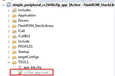

  • You should not be touching the linker.cmd file. This is automatically generated during the RTOS build. The linker file can be found under the TOOLS folder. Here is an example from the default simple_peripheral project:
    In any case, you should be putting your bootloader on the last page; not the first page because:
    - the CCFG section is enforced to be placed on the last page. You can therefore use the remainder of this page for you bootloader and not need to consume an entire new page (i.e. the first page)
    - there are RTOS symbols that are hardcoded (due to ROM) to certain locations in the RTOS linker.cmd.
    Currently, in cc26xx_app.cmd, the last page is reserved and the CCFG is placed here. However, you should have the bootloader manage the CCFG similar to how it is done in the BIM (see cc26xx_bim_r2.cmd).
    So you should remove the following line from SECTIONS in cc26xx_app.cmd:
      .ccfg           :   >  FLASH_LAST_PAGE (HIGH)
    You should then be able to use the cc26xx_bim_r2.cmd file for your bim
