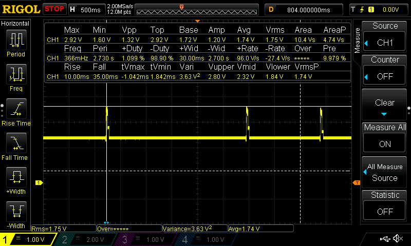

I designed an own device with a CC2650. Some devices with this design were made. After few months some of these devices stopped working.
The CC2650 is powered from a 3V3 regulator and works with internal DC-DC regulator and external 24MHz and 32.768kHz crystals with the recommended layout. In addition, the device works near a NFC transponder (maybe it's important to know).
I have tried to access them for reprogramming but it is not possible, the microcontroller is dead.
When turn on the power, the device advertising for milliseconds sometimes and other times not.
Also I have measure the voltage on internal DC-DC output (pin 17). At startup the value is correct but immediately go down.
Any idea what the problem is?
Thanks in advance.
Jose.

  • Hello Jose,
    I don't know if this field will be strong enough to induce ESD damage, altghoug it seems like the device might be damaged in some way.
    Can the transponder affect the CC2640 power supply or voltage on any IO pin to go above max ratings?
  • Eirik V said:
    Hello Jose,
    Can the transponder affect the CC2640power supply or voltage on any IO pin to go above max ratings?
    I attach the measure of VDDR (from the DCDC output) in a functional device, other IO signals are normal. The peaks are induced every reading of the NFC transponder (every 5 minutes in normal use) probably helped by the required coil. The only idea is that after some time it may have caused damage.
    What is your opinion? Any idea is welcome. Thanks again.
    Jose.
  • Hello Jose,
    Is the device running any BLE connection or other processing or does the peaks simply correspond to NFC reads (induced field)?
    How does VDDR look without any NFC communication?
    According the the plot VDDR peak is 2.92 Volts, correct?
  • Hello Eirik,
    The device is running a BLE connection with a smartphone but peaks appear only when an NFC reading occurs. For the remaining time VDDR has a stable signal without interferences.
    Yes, peaks are around 2.95V in VDDR.
    Thanks for the help.
    Jose.
  • Hello Jose,
    That is far above max ratings for VDDR and might cause damage to the internal circuits that are powered from VDDR. For DCDC regulator mode VDDR should remain stable on 1.68 V all the time.
    Have you connected anything else to VDDR (to draw power from VDDR externally)?
    You need to figure out if this comes from the transponder or is due to the NFC field directly.
    Transponder:
    Review if there are any connections from the transponder that might cause voltage above max ratings on the CC2650 Supply voltage or on any other pin. In that case you might find a way to redesign the board. Try to measure voltages on the other CC2650 pins as well.
    NFC Field:
    You can try to check if the NFC field induced on the CC2650 antenna cause the spikes by disconnecting the antenna and measure. The max ratings for RF input is given in the data sheet. Maybe additional ESD protection on the antenna or a redesign can mitigate the issue.
  • Hi Eirik,
    VDDR is not used to power external circuit. I think problem is NFC field. NFC antenna is too close to VDDR strip. It will be necessary to modify this in future.
    Many thanks for your help.
    Jose.
