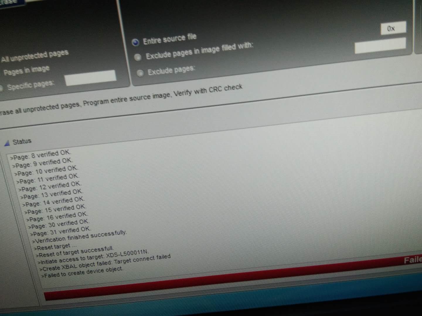

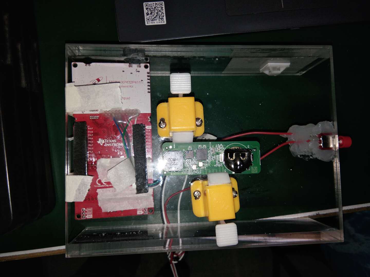

Dears
My customer meet 5% programming failure rate in their CC2640R2F product MP procedure, the failure report information as below picture.

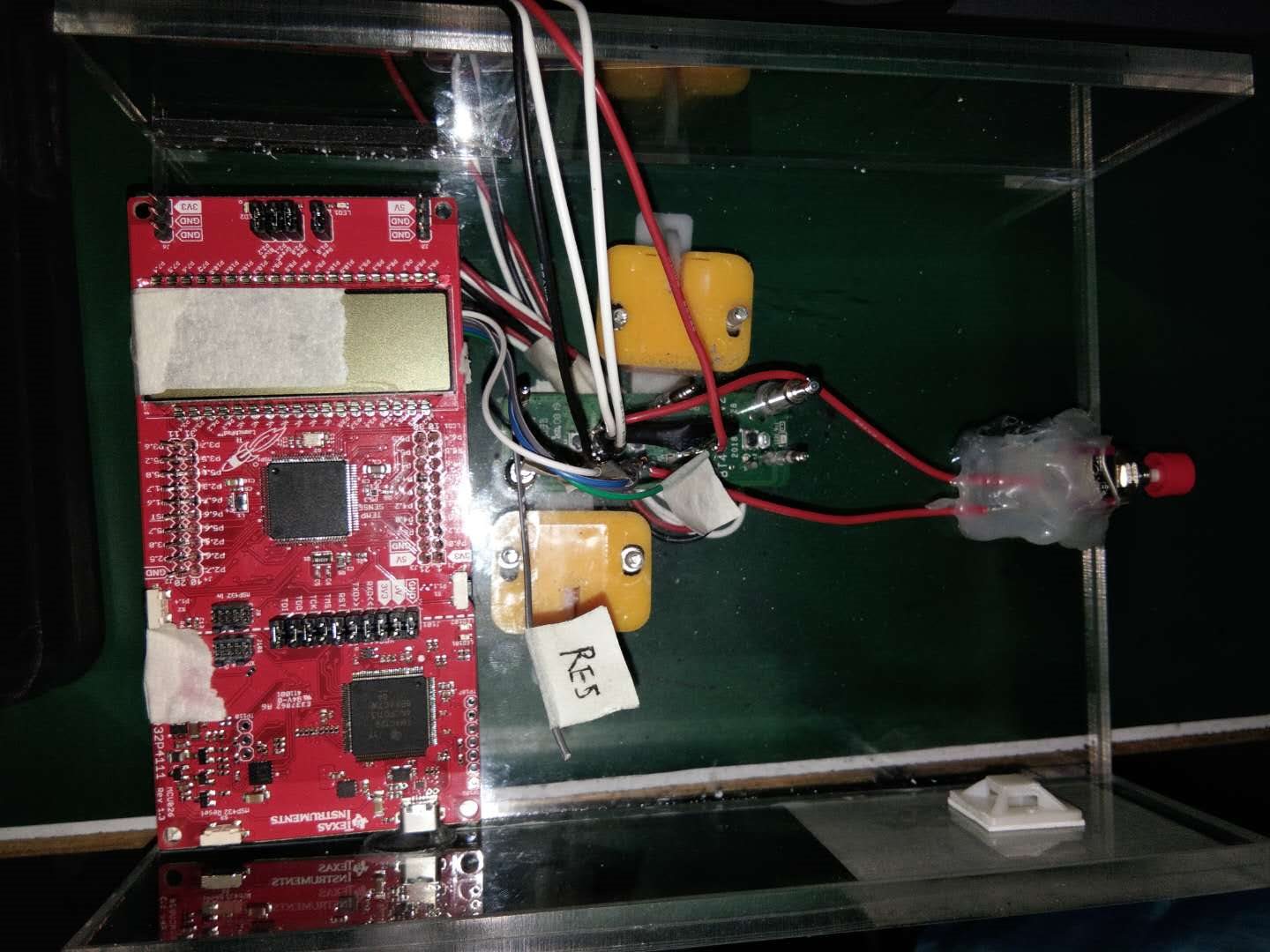

The programming hardware is CC2640R2F Launchpad Emulator JTAG connection with customer socket board, programming software is Flash Programmer SW.
After happen the programming failure, some device can be re-program again, but few device will lock forever even if mass erase can not restore.
