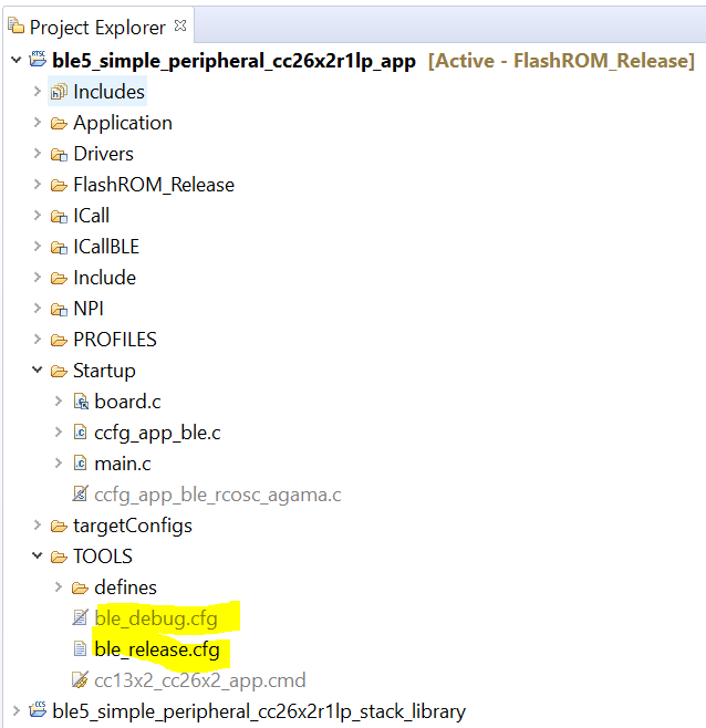

  • Hi Marc,
    The easiest thing is to use the Debug kernel project (instead of the Release) kernel project. Please refer to the SimpleLink User Guide for details on how to change the kernel project.
    If this is a BLE example that has the .cfg in the application project, please un-exclude the ble_debug.cfg file and exclude the ble_release.cfg file. Rebuild and run and you should get more information.
  • Oh, my bad, I didn't give details on my setup. This is not a BLE project (yet) it's the
    uartecho.c project with a bunch of demo/eval/test code added for I2S/I2C audio play.
    I have CCS 9.0, fully updated, etc...
    I didn't see the above defines folder in my project (no BLE)...
    Where else to look, and thank you,
    Marc Y.

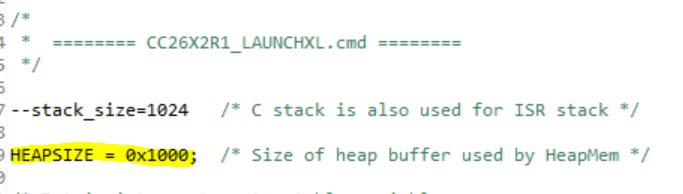

  • First things first, let's try to help you figure out the initial problem. My goal was to have you use the debug kernel. This adds lots of debug features like giving the name of the file that an error occurred in. We don't have that enabled in the release kernel project to save footprint.
    It sounds like your heap is too small. Task_create allocates up to 1 or 2 things: Task_Object (to store the state information of the new task) and optionally a Task stack. If you supply the stack in the Task_Params in the Task_create, that stack is use instead of allocating one. So either make your heap larger or supply a stack in the Task_Params used in the Task_create. Note: make sure the stack is the same size as the size specified in the stackSize parameter field.
    The UART Echo example specifies the heap size in the linker command file.
    Note: ccfg.c has nothing to do with the kernel .cfg file.
    Todd

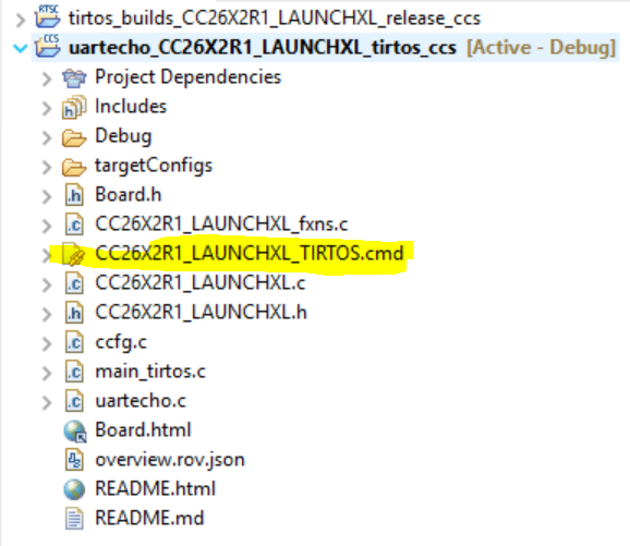

    So, the dang ".cfg" file issue, there isn't one in a new empty project or in the UartEcho I started with.  As I understand
    from you, I switched to the debug kernel and it is healthy for data mining info as you said.
    I also see the kernel build has a ".cfg" file that it is using.  Can I simply copy that to my work space, rename or what
    ever and use it to make settings?   I don't see an implicit heap size in that .cfg file, rather found a setting in the linker
    file that came with UartEcho project example.   I change it to 8K but didn't see any change in the run time?  I added
    code to print out the Heap(free/alloc/etc) from another example and it still is 4K?
    I think I see how to increase the stack size for each task when created.  Does the stack memory come out of the
    heap too?  It seems like it as I set on to 2K and hung up in the error(eb) spin loop right off the bat.
    If i copy debug.cfg from the kernel source code to my work space is there any issue with duplicate defines ???

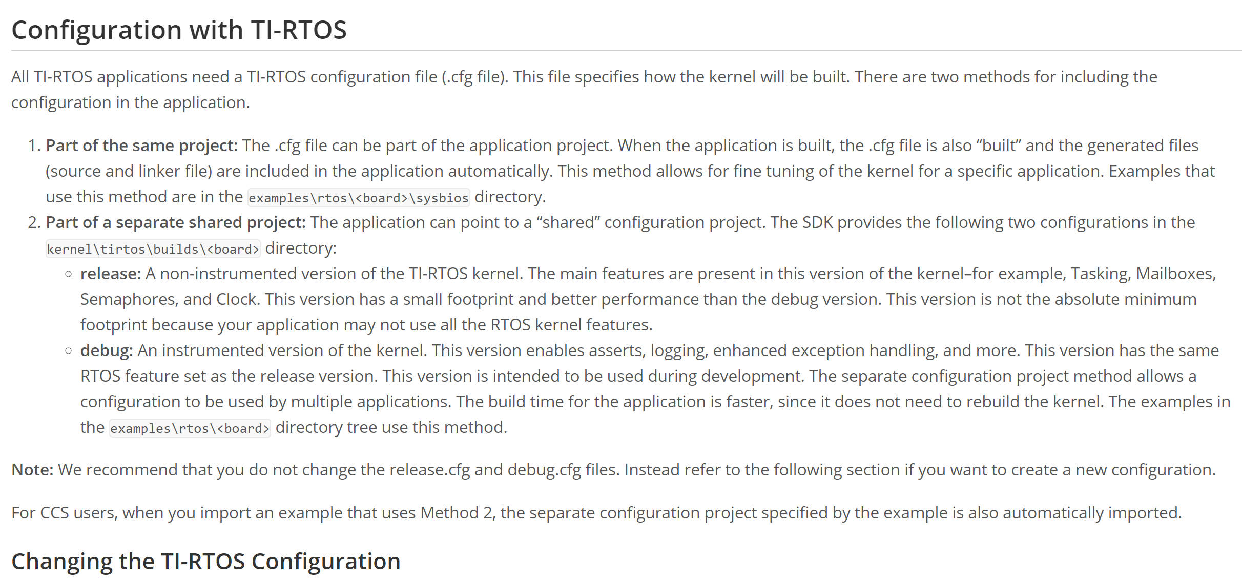

  • Hi Marc,
    The majority of the examples have an application project (e.g. driver's empty and UARTEcho) and a kernel project. The kernel project contains the .cfg file. The application project is "dependent" on the kernel project. There can only be one .cfg in the example. It can be in the application project (and remove the dependencies on the kernel project) or in the kernel project.
    You have four options in changing the .cfg file
    1. Move the dependency to the debug kernel project (which is sounds like you did)
    2. Change the kernel project (release or debug) as needed
    3. Create new kernel project and modify it as needed (and point the application project to be dependent on it)
    4. Add the .cfg to the application project (and remove the dependency on the kernel project). Here are instructions for this: dev.ti.com/.../node
    I recommend doing a combination of 1 and 2.
    To change the heap size, you need to adjust the HEAPSIZE variable in the linker file. We placed this in the linker file to allow different application projects that share a common kernel project the ability to customize the heap size. Note: the .cfg* contains the following which allows for the customized heap size
    var HeapMem = xdc.useModule('ti.sysbios.heaps.HeapMem');
    HeapMem.primaryHeapBaseAddr = "&__primary_heap_start__";
    HeapMem.primaryHeapEndAddr = "&__primary_heap_end__";
    var heapMemParams = new HeapMem.Params();
    heapMemParams.usePrimaryHeap = true;
    * assuming the out of the box release and debug kernel projects.
    You should be able to increase the HEAPSIZE variable in the linker file and assuming you have the above in the .cfg file, the can look at ROV->HeapMem to see the correct size. Make sure you are rebuilding everything after the change.
    Todd
    I did change the linker to 8192 and still my run time reports only 4096?
    In that code you show, I have found that too, where is the "size" set if using that method?
    I see a start and end labels, and a couple of other settings but not size?

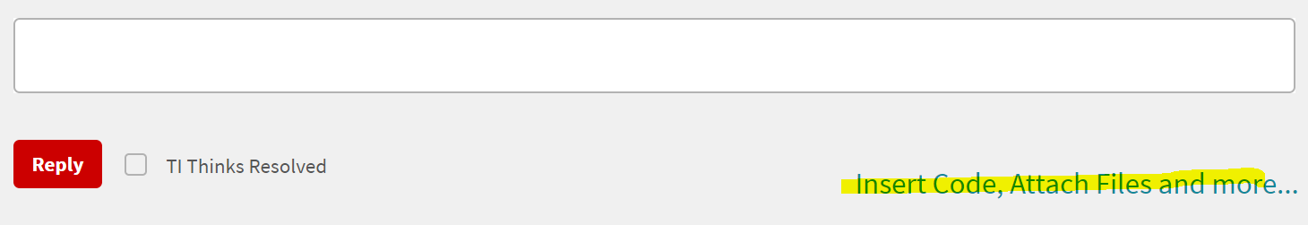

  • Hi, I don't see an "attach file" button in this dialog to reply?
    I'll do the "insert file" perhaps that is what will attach a file.
    The makefile and map file are from the project directory (debug build).
    The debug.cfg is in the TI-RTOS kernel (debug) build source, I haven't touched it.
    Here goes, after I click upload all I see is a strange graphic in this
    message entry dialog box, not sure if that means they are attached?
    Thx,Marc
    OK, that didn't work, the paper clip thing (insert file) when added
    and "POST" clicked either spins forever or pops up a red warning
    card that says something about the file extensions...
    Give me a clue how or what to click to attach a file, dumb question
    as it should be obvious?  I just don't see it?
    Maybe attache only works in the "Ask new question" button dialog
    and not from the "Reply" button in the message reader screen?
  • When you hit reply, click the yellow link
    Then click the paper-clip
    and browse to the .cfg file and insert. It may look weird, but that is fine. Do the same with .cmd. I've done that for a .cfg and .cmd below as an example.

  • Change the HEAPSIZE variable in the application linker file.
    Note: I'm not sure which board you are using, so the application linker file might have a different name.

  • You have to have a linker file in the application project. Here is the UART Echo that I imported. There is the kernel project on top and the application project below it. See the linker file I high-lighted in the application project. I'm using the TI compiler. If you are using GCC or IAR, the linker file has a different suffix. Again your board name (i.e. CC26X2R1_LAUNCHXL_TIRTOS) will be different if you are using a different board.
  • Ok, crap, I just found what you were saying in that last post. I changed that to 0x2000 and got my 8K heap finally!!!
