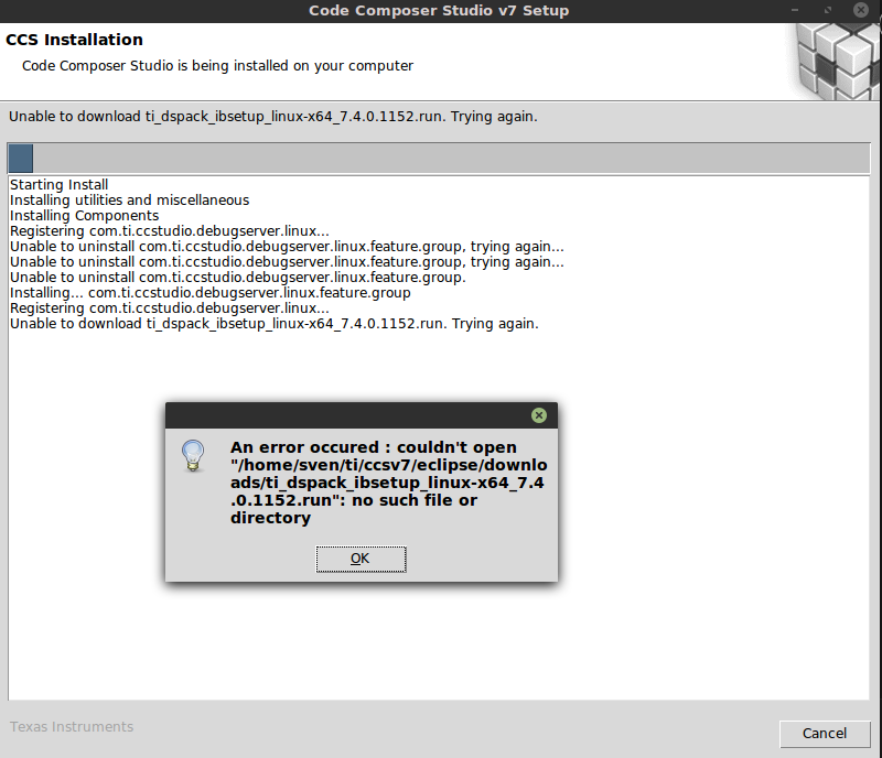

  • Thanks Marie,
    CCS 7.4 fails during installation:
    I cannot seem to locate the download myself.
    Br,
    Sven
  • I don’t think you need to install this package.
  • Perhaps, but the installation prematurely halts and exits at that point.
  • Do you select that package when you run CCS installer?
  • No I don't. I'm installing over 7.2 however...
  • I suggest you to download CCS 7.4 offline installer to install it.
  • Thanks for your persistence!
    Unfortunately I have this error using the offline installer.
  • Maybe try to install CCS 9 and TI ARM Compiler 16.9.4.LTS to build BLE Stack 2.2.2 examples.
