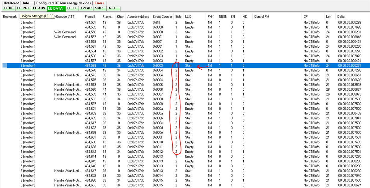

We're troubleshooting some issues causing disconnections between our peripheral (CC2642) and central device. I've seen some bizarre things in the sniffer traces (BPA Low Energy sniffer) that I can't explain, and was hoping to get a second opinion. The sequence of events in the screenshot below are throwing me for a loop, my best theory is timing issues on the central side that might be causing the sniffer to display things incorrectly. "Side 1" is supposed to be the central and "Side 2" the peripheral. Starting at frame 464,570, the sniffer displays a long series of connection events where only side 2 is present. The signal strength is good enough that I think it's unlikely the sniffer missed that many packets in a row from the central side.
I'm wondering if the timing is off in the central, and frame 464,570 is actually coming from the central, because the next frame after it is a notification from the peripheral. The Delta between frame 464,566 (first packet in the previous connection interval) and frame 464,570 is ~7.9 ms. Our connection interval is 7.5 ms. Is it possible that the central started connection event 0x9004 later than it should have, and the sniffer software is assuming it missed the central's packet and interprets it as a peripheral packet?
On a more general note, it's not possible for the peripheral to send a packet in a connection event if the central doesn't send a packet, right? I thought this was just how BLE worked, but maybe I'm mistaken?

  • Hi Joshua,
    You're right, the peripheral device waits for the packet from the central device, then transmits its own packet. So if there's no central device packet, the peripheral device will not transmit a packet either.
    Some sniffers will indicate whether a packet is a retransmission or not, can you check for this?
  • Hello Marie,
    Thanks for the quick response. I spoke with tech support from the company that makes the sniffer and they pointed a few things out about the tool that I didn't know. On the "unfiltered" tab I can now see that the master device is initiating, and continuing connection events, the packets just have CRC errors. These aren't displayed in the screenshot of the LE Data tab I posted because of the CRC errors. This makes it look like the slave device is initiating it's own connection events.

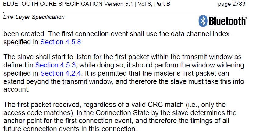

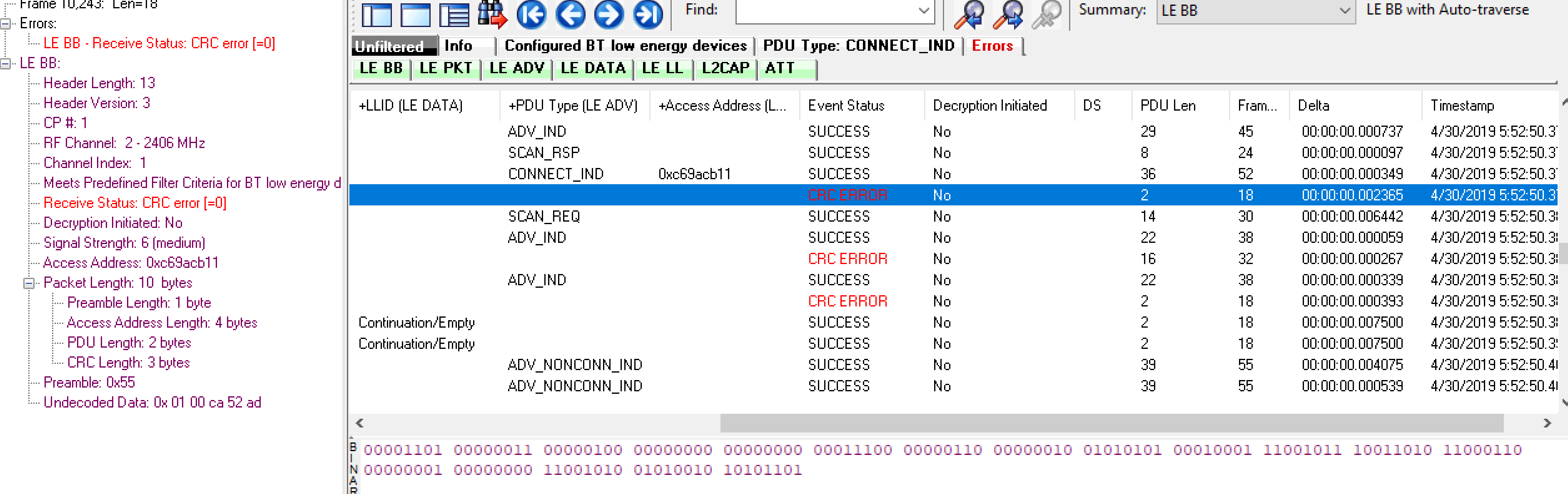

  • Hi Tim, I am taking over the CONNECT_IND issue from Josh and have new information to add.  This issue has been logged using the 3.1 and 2.2 stacks so it doesn't appear to be related to stack version.   What we are seeing is that the next packet after a CONNECT_IND sent to the same access address has a CRC error as shown in the logs below.  When that occurs we never get connected to the peripheral device.   It appears to be sent within the timing window defined by the master as well so I have checked that avenue for potential issues.  We are using 1.25ms for the txWindowSize and 0 as the txWindowOffset.   The txWindow delay is 1.25ms per spec.  According to the BLE spec if that first packet has a CRC error, it still defines the anchor point.  We are wondering if the CRC error that occurs is possibly causing the TI stack to do something other that what is in the spec?

  • Hi. It looks like what you are point to can be explained by 2 scenarios:
    1. the scenario you decsribed
    2. the slave never saw the connection request
    I'm leaning toward the second explanation because it appears that the advertisement that the connection request was sent to in the frame you were referring to (frame 10243, address 0x806fb0eee059) continues advertising at its 100 ms advertising interval after the connection request is sent.
    It is normal for this to happen sometimes if there is a lot of interference or over-the-air traffic. That being said, it should not happen frequently in a clean environment.
    Is the central device your own hardware or is this a TI board?
  • Hi Tim C., the hardware is custom hardware in this case.
    Let me see if I understand scenario 2.   Since the next advertisement from the peripheral is at the 100ms interval in the log, this would suggest that the peripheral never saw the connection indication or the next advertising interval is not likely to have been on the 100ms boundary correct?  If it had seen the connection indication, it would have then used the Link Layer connection supervision timer during connection establishment which the spec says is 6*connInterval (7.5ms in our case) before giving up and starting advertising again.  So in this case, it appears the peripheral was never looking for the master's connection attempts because it never received the CONNECT_IND.
    Tim W.
  • Yes, your understanding is correct. Perhaps you could try testing with a coax cable to rule out interference. You should still be able to use the sniffer either by using a splitter or maybe placing it very close to the devices.

    It would be good to get confirmation that the TI stack does use the first packet as the anchor event even if it has a CRC error since that was my original question.
