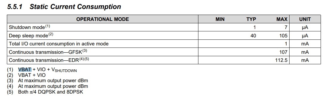

Hi Sir,
    What is the maximum current consumption for VBAT & VIO at 3.3V(VDD_IN) conditions ?
    thanks.
    Ex: EDR mode the maximum is 112.5mA, it is point to VBAT + VIO or only VBAT ?
          1. what is the maximum current consumption of VBAT ?
          2. what is the maximum current consumption of VIO ?
  • Frank,
    The continuous transmission current consumption values are only from the VBAT.
    This would be the 112.5mA for continuous TX in EDR modulation. However, please note that the current consumption in an actual BT/BLE use-case will be lower than this value.
    1mA according to the static current consumption table.
