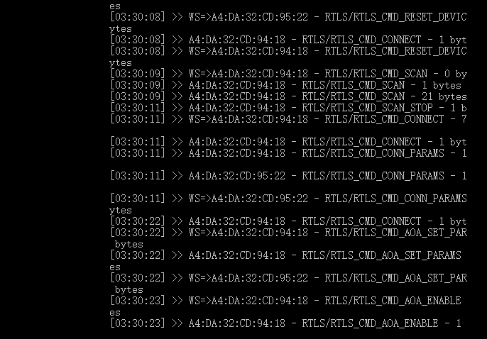

    I build and download the three hex to the board.And they is runing ok.
   when i use RTLS Monitor to get angels,and there are some errors.i dont know what how to resolve it.
  As below:
firstly i click on the connect button and then i click on the scan-slave button.i get the slave device.
when i click the connect button, and there are som problem, the device cant run.
the log is above.
how can l do?
thanks

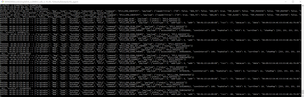

    so i try to do task 2 in document.And when i use python -u exambles/rtls_example.py ,this is track. it shows From-rtls-import-RTLSNode ,it cant find "rtls".
    Can u help me to finish it?
    l konw python ,but i dont konw why ur,s py cant find rtls dictory in C:\ti\simplelink_cc2640r2_sdk_2_40_00_32\tools\blestack\rtls_agent dictory.
  • Please make sure to open the git bash/terminal under the same SDK.
    Since you are using example from simplelink_cc2640r2_sdk_3_10_00_15, please execute the python from there.
    There has been some folder restructure between 2.40 and 3.10 SDK.
    Also after you install the module using pip install, can you post the msg so we can know what's going on?

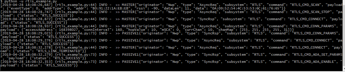

    the result is below:
     it cant get the angel.so i guess the default rtls_example.py is some bug.
    what i can do??

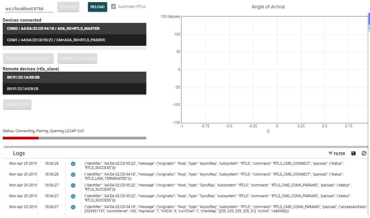

    i reinstall the the simplelink_cc2640r2_sdk_3_10_00_15  sdk .
    The task 1,the result is bad as below.The software stops somewhere i dont konw.
    And i gona finish task 2.the output is there as below.
    for task 2,that is a loop all the time as above.
    when the master connects to the slave,for a while the link is terminate.the message are showed as above.
    so how to solve the problem?
    thanks.

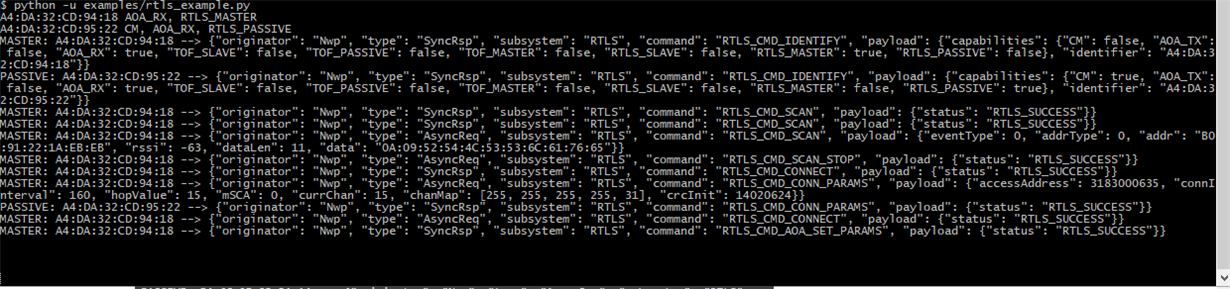

  • hi:
    in task 2,the problem is same like task1,s.
    if msg.command == 'RTLS_CMD_AOA_SET_PARAMS' and msg.payload.status == 'RTLS_SUCCESS':
        sending_node.aoa_initialized = True
        if all([n.aoa_initialized for n in all_nodes]):
        # Start AoA on the master and passive nodes
            for node in all_nodes:
                node.rtls.aoa_start(True)
    In rtls_example.py ,when the pc receives the rtls_cmd_aoa_set_params command, the if sentence is fail. i guess the pc does not  receive the rtls_cmd_connect command ,so the all_nodes list is null.
    how to solve this problem?
  • hi:
    Now,i can get the angels.Above the picture,as i explained.The program stoped when the pc show the RTLS_CMD_AOA_SET_PARAMS command.
    But i dont change anything about it.Today i try it again,and i can get the angels.
    I guess that there are some bugs about demo.
