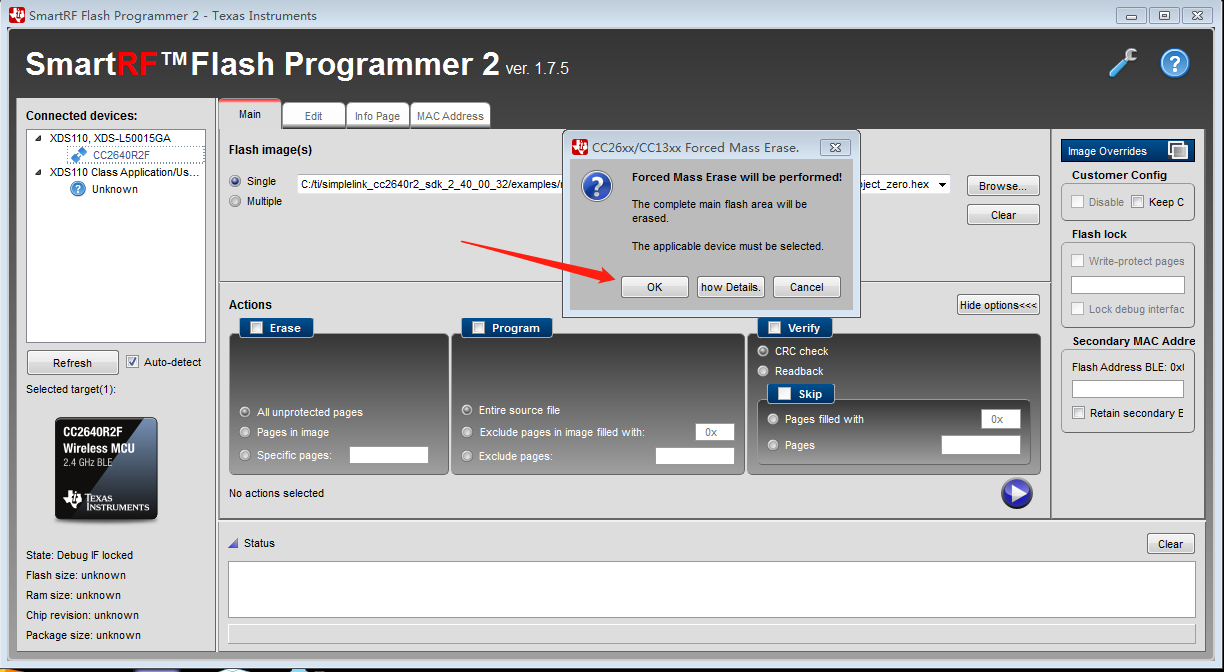

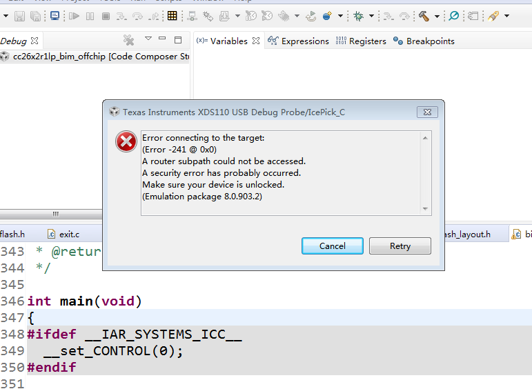

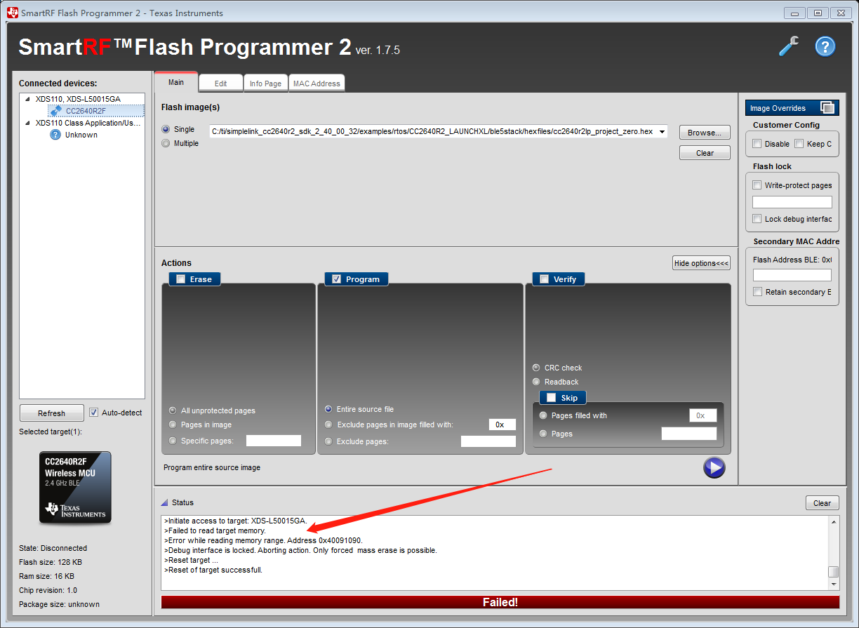

The CC2640R2f development board failed to download the program.

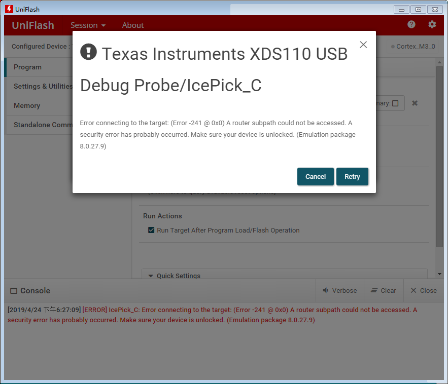

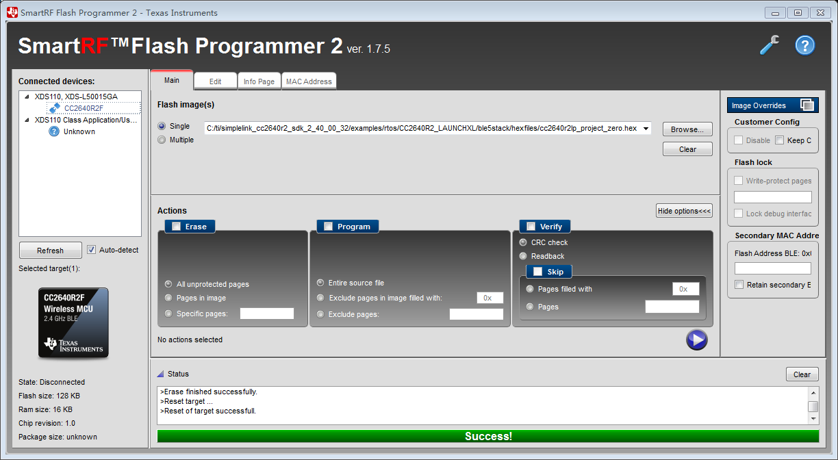

The use of Uniflash also failed. Using Mass Erase, the erase was successful, but the program could not be programmed, and the connect could not be connected.
I want to ask why I can't download it after erasing.
