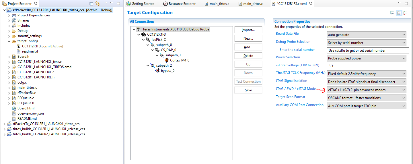

  • Could you check that the CCS project is setup to use cJTAG:
  • It is running cJTAG. But we tried lowering the JTAG TCLK clock frequency to 100KhZ, and it successfully talked to our board!
