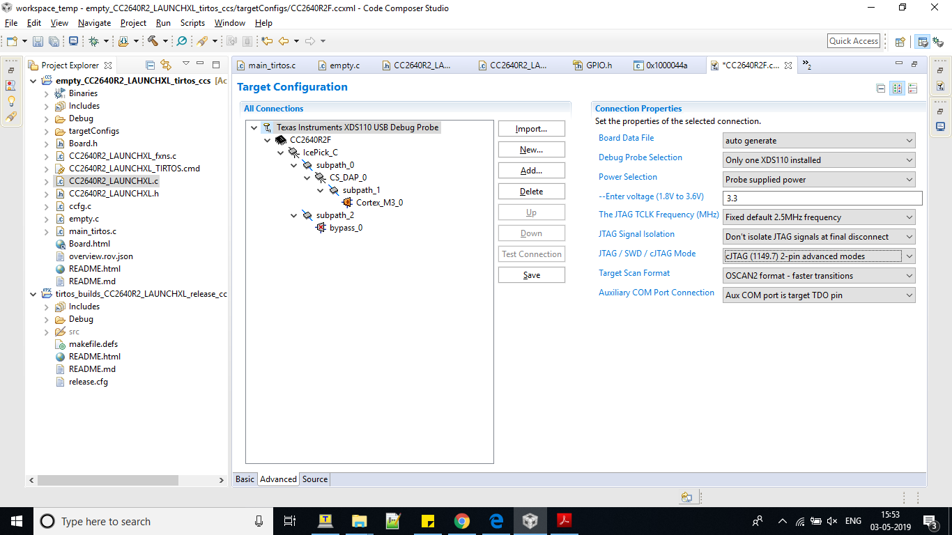

Issue : Unable to use TDI and TDO as gpio pins .
Form the document I came to know   that TDI and TDO can be used as GPIOs, and  TCK and TMS are JTAG only.
In CC2640R2F.ccxml file configures the cjag as 2-pins, find the image below
Software Changes :

Please clarify I am missing any thing .
  • I assume that your code didn't toggle the LED since you posted this question.
    Does your code work for the DIO pins except for DIO 16 and 17?
    Also see e2e.ti.com/.../711372 on how to add a new DIO.
  • Hi ,
    My Code works for DIO pins other than DIO 16 an 17 .
    I am able to toggle DIO 6 and DIO 7 . Except DIO 16 and 17 which are jtags TD0 and TDI .

    I think I am following the wright procedure . Kindly guide me .
  • How do you measure? Note that DIO16 and DIO17 are not connected by default to the pin row on the side on the LP, you have to use a 0 ohm resistor to do this.
    I got this to work adding the following changes to the empty project:
