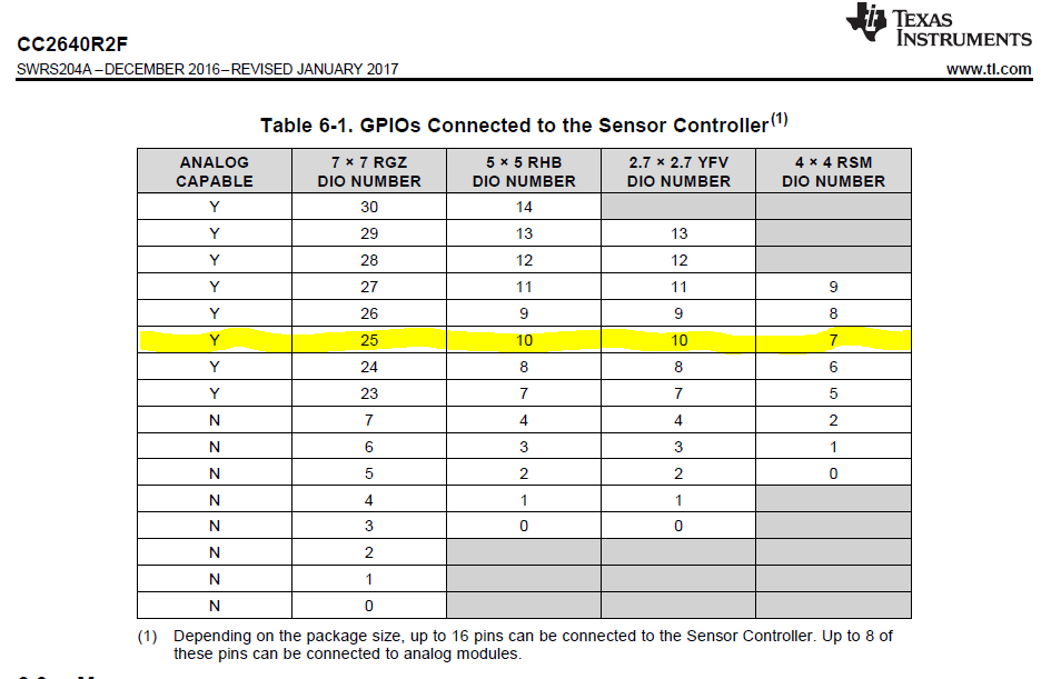

I'm having a hard time making the ADCSingleChannel example work with a 5X5 chip.
First, i made it work with a 7X7 with the launchPad without any problems.
To make it work with a 5X5, i have commented the pin table to make sur no pin above IOID_14 get used

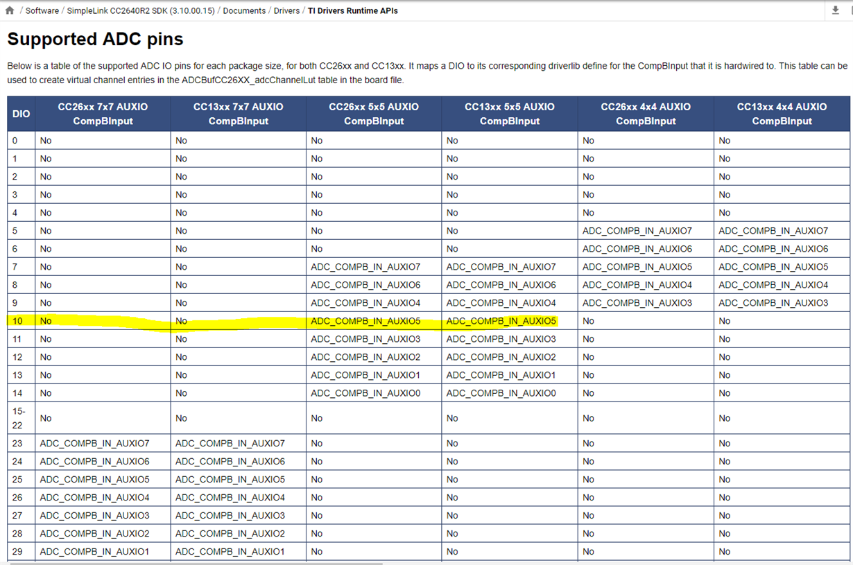

Then, i have updated the ADC Configuration as followed :
#include <ti/drivers/ADC.h>
#include <ti/drivers/adc/ADCCC26XX.h>
ADCCC26XX_Object adcCC26xxObjects[CC2640R2_LAUNCHXL_ADCCOUNT];
const ADCCC26XX_HWAttrs adcCC26xxHWAttrs[CC2640R2_LAUNCHXL_ADCCOUNT] = {
        .adcDIO              = IOID_10,
        .adcCompBInput       = ADC_COMPB_IN_AUXIO4,
        .refSource           = ADCCC26XX_FIXED_REFERENCE,
        .samplingDuration    = ADCCC26XX_SAMPLING_DURATION_2P7_US,
        .inputScalingEnabled = true,
        .triggerSource       = ADCCC26XX_TRIGGER_MANUAL,
        .returnAdjustedVal   = false
const ADC_Config ADC_config[CC2640R2_LAUNCHXL_ADCCOUNT] = {
    {&ADCCC26XX_fxnTable, &adcCC26xxObjects[CC2640R2_LAUNCHXL_ADC0], &adcCC26xxHWAttrs[CC2640R2_LAUNCHXL_ADC0]},
const uint_least8_t ADC_count = CC2640R2_LAUNCHXL_ADCCOUNT;
typedef enum CC2640R2_LAUNCHXL_ADCName {
    CC2640R2_LAUNCHXL_ADC0 = 0,
} CC2640R2_LAUNCHXL_ADCName;
When i run the code with this config, i don't have any crash, but all the values i read are 3.3V event though my IOID_10 pin is tied to ground ( or to any other values ).
I'm doing something wrong in my configuration for the 5X5 chip, but i have no idea what.
