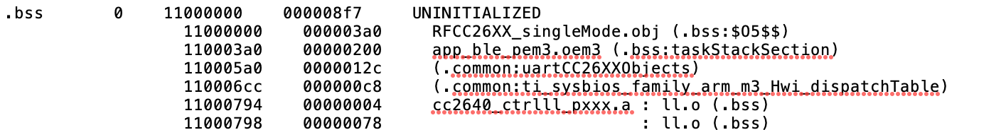

    In both cases, out-of-the-box unmodified ProjectZero and reconfigured to repurpose cache as GPRAM, cc2640_ctrlll_pxxx.a is being used.  The problem is that for the case where the cache has been reconfigured, the ram usage for ll.o has been moved to GPRAM.  According to the docs, this is incorrect.  Referring to the instructions for reconfiguration section 5:
    "...5. If your project is based on a BLE-Stack project, this will move as much of the .bss section that the SRAM can fit, from SRAM to GPRAM. The exception is ll.o and, if you’re using the BLE5-Stack ll_ae.o. The RF driver requires ll.o (and if applicable ll_ae.o) to be placed in SRAM...."
    Here is one entry in the map file before cache reconfiguration:
    ll.o is in the .bss segment at memory address 0x2000_xxxx which is SRAM.
    Here is the same entry after reconfiguration:
    Still in .bss but in GPRAM.
    So the docs say that this isn't going to work...
    I don't know the relevance of the linker warning message but the above is wrong, assuming that the docs are correct.

  • Hi Andrew,
    I'm not sure I understand - I took your screenshots to be configuration as described in the documentation, not the change I suggested. If you change the linker file to refer to a different library name for ll.o/bss, does that _not_ change where ll.o gets placed in the map file?
    I'll try to reproduce and have a look tomorrow if this did not help you.
    Aslak
  • Hi Aslak,
    The confusion was on my end.
    Changing the filename as you suggest has resolved the problem. The warning is no longer issued and the project runs just fine.
    Looking at the .map file, however, I see that ll.o is being placed in GPRAM which leads back to the comments in para. 5 of the docs being incorrect.
    ac
  • Hi Andrew,
    I could not see that the .bss section of ll.o was still in GPRAM when I try to replicate. Glad it worked.
