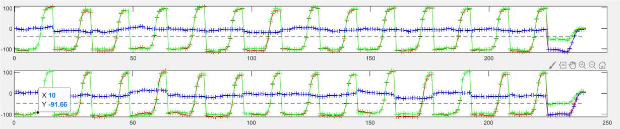

Recently,we calculate the angle between receiver and sender based on the  SimpleLink CC2640R2 SDK (2.30.00.28),using RAW IQ datas sampling by two antennas(A1.1 and A1.2)。
Results in the blow picture:
red line: angle resluts;
blue line: the phase drift across one antenna repetition;
green line: Correct for angle drift / ADC sampling frequency error;
from the picture, we find that the datas from 0 to 10 is correct, but 11-15  may be error ,just as the code segment only use the 0 - 7 IQ data,not 8 - 16:

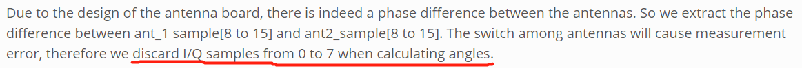

But the document(http://dev.ti.com/tirex/content/simplelink_cc2640r2_sdk_2_20_00_49/docs/blestack/ble_user_guide/html/localization/index.html#angle-of-arrival):
tell us:we need discard I/Q samples from 0 to 7。who can  explain this question?
