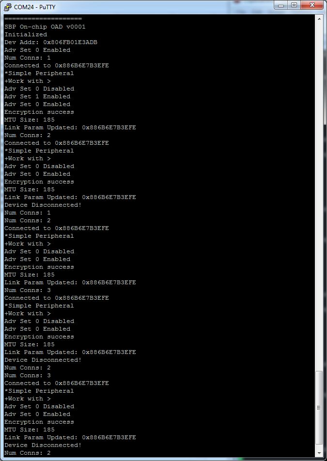

I'm adding HID service and the issue happens when my IPhone auto connect to a single BLE device.
I see in the UART terminal that number of active connections increases with the same MAC address.
But I have only one BLE device. How is it possible?
I'm working on the HID device, so iOS auto connects if it was paired. HID works fine unless the new phantom connections occur.

    So, I added my modified Multi-HID code to ble5_simple_peripheral_oad_onchip_cc26x2r1lp_app for CC26x2 LaunchPad.
    The HID service works fine and I can get connections with iPhones and all of them receive HID keyboard commands.
    But sometimes I see GAP messages that new connections are established and they have MAC address of devices that have connected already.
    if I turn off advertising, it doesn't happen. When I turn on advertising to connect a new iPhone, I see messages that the previously connected iPhone connects again and again.
    Although the real link was not terminated.
    Just pair a single iPhone to the LP and you will see in the terminal that "Num Conns" increases and decreases chaotically.
    Looks like there is a bug for devices that can auto-connect to iOS, like HID devices. CC2652 doesn't understand that it is connected already and stack send new GAP messages and take new slots in the "connList"  up to the MAX_NUM_BLE_CONNS.

  • You see the same MAC address and "Num Conns" increases and decreases. It happens immediately when the device resetted.
    The initial the very first BLE connection with IPhone is not terminated. I see that it is connected all the time. There are no other paired IPhones around.
    But something strange happens...
    I also tried to add output of the "pPkt->connectionHandle" in the "case GAP_LINK_ESTABLISHED_EVENT:". It increases and decreases accordingly to the "Num Conn" too.
    I tested it on IPhone 5s ios 10.3.3 and IPod touch ios 10.3.3
    Note: I changed the -DBOARD_DISPLAY_USE_UART_ANSI=0 setting in the opt file to don't lose the terminal messages. So ANSI is off.

    Regarding the issue at hand, it is certainly strange what you are describing. My initial guess is that the central device is actually sending multiple connection requests but it is hard to say anything more without a sniffer capture. Is it possible for you to get a sniffer capture?
  • It looks exactly same.
