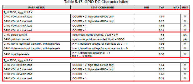

Looking at P27 "Table 5-17 GPIO DC Characteristics" of the data sheet (swrs194c), the value of "GPIO VOH at 8mA load" is the same value "1.58V" at VDDS = 1.8V and 3.0V.
I think the value at 3.0V is too low, is it a mistake?

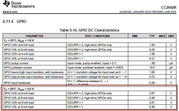

In the following datasheet (Japanese version: jajsek9a), "GPIO VOH at 8-mA load" at VDDS = 3.0 V is Typ 2.57 V.
Is this value correct?

  • Hi Clément san,
    I am sorry that I can not explain well.
    What I wanted to confirm is that
    - GPIO VOH at 8mA load (VDDS = 1.8V) is 1.58V
    - GPIO VOH at 8mA load (VDDS = 3.0V) is 1.58V
    both is same value.
    Furthermore, the red frame in the figure below is all the same.
    Is this not a mistake?
    By the way, in CC2640R2F, there were the following differences at VDDS = 1.8V and 3.0V.
    - GPIO VOH at 8mA load (VDDS = 1.8V) is 1.54V(Typ)
    - GPIO VOH at 8mA load (VDDS = 3.0V) is 2.68V(Typ)
    CC2640R2F also has built-in DC-DC, but both have different values.
    I can see that CC2640R2F and CC2642R are separate devices. However, will VDDS = 1.8 V and 3.0 V have exactly the same value as in the above figure?
    Takashi
  • Hi Takashi,
    That is indeed a mistake in the datasheet and we are currently working to correct it.
    For now, you can assume the performance will be very similar to CC2640R2F.
    Fredrik

    Is contents of "GPIO VOH at 8-mA load" at VDDS = 3.0V is 3.05 Typ 2.57V listed in the Japanease datasheet (jajsek9a) of CC2642R which I first asked was correct?
    The contents of CC2640R2F's Datasheet also seem to be slightly different.
    Takashi
  • Hi Takashi-san,
    Those numbers are pretty close to the actual values. The new values going into the datasheet for 3.0 V are:
    * 2.59
    * 0.42
    * 2.63
    * 0.40
    Fredrik
