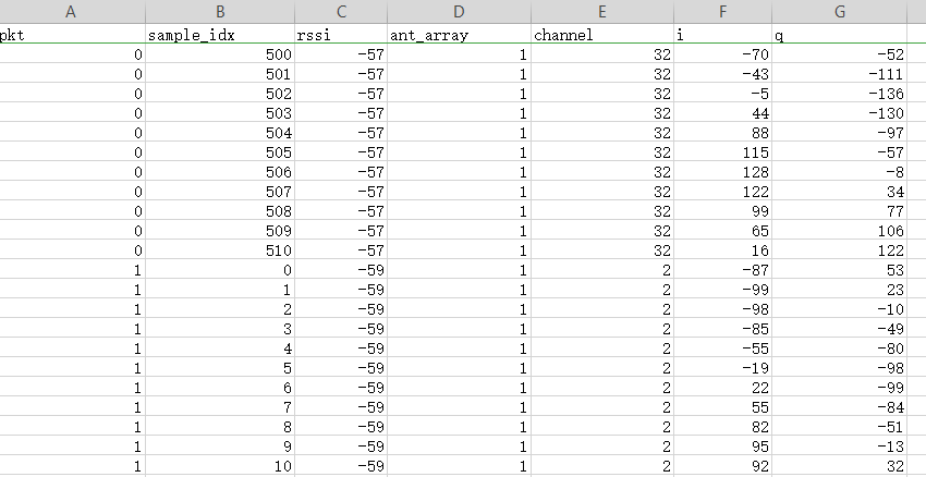

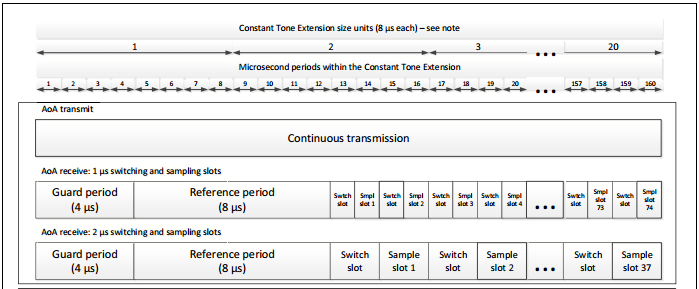

  • hi:
       thanks u for ur reply.
      As above,this is picture about core 5.1 spec.Right now,i see that the meaning of all kinds of parameter is defined by ti.
     But the out-file showed as below is wired in some place.
    i only use the two antennas of one array.why the sample index is 510 not 511?
    l,ll also try to see the py in details and find the reason.
  • Hi Lenli,
    I'm afraid I don't fully understand what you are asking.
    Could please clarify your question?
    Yuval
  • hi,
    thank your reply.
    According the situation right now ,RF core works 128 ms . And i configure the parameter that is the two antennas of only array to use.
    So That s should be 512 pairs of I and Q value all together.But it,s 511 pairs of I and Q value right now in rtls_raw_iq_samples.csv file as above.
    So this is my misunderstanding or a error ?
  • Hi Lenli,
    Did you change any part of the script? Of the C code?
    Have you tried to debug the python script and see if this is a python script issue?
    Yuval
