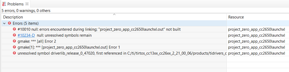

here is my console:
driverlib_release_0_47020 C:/ti/tirtos_cc13xx_cc26xx_2_21_00_06/products/tidrivers_cc13xx_cc26xx_2_21_00_04/packages/ti/drivers/lib/drivers_cc26xxware.aem3<PINCC26XX.oem3>
error #10234-D: unresolved symbols remain
error #10010: errors encountered during linking; "project_zero_app_cc2650launchxl.out" not built
>> Compilation failure
makefile:183: recipe for target 'project_zero_app_cc2650launchxl.out' failed
gmake[1]: *** [project_zero_app_cc2650launchxl.out] Error 1
makefile:176: recipe for target 'all' failed
gmake: *** [all] Error 2
here is the Problems:

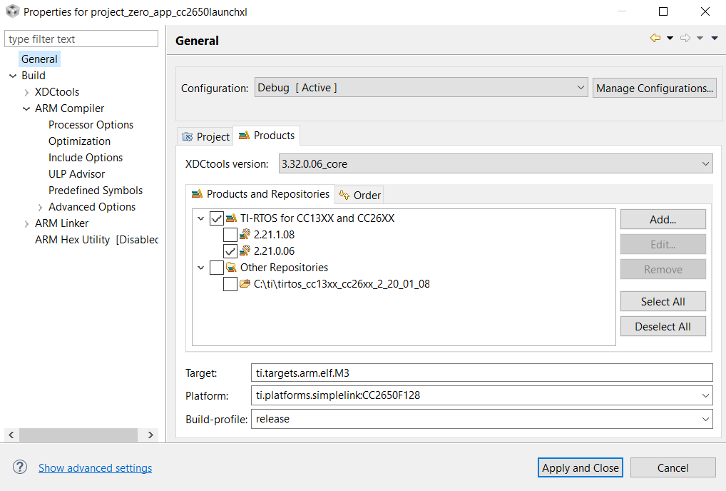

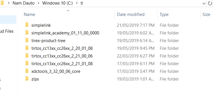

here is my ti rtos ( i installed ble stack 2.2.1 and 2.2.2)

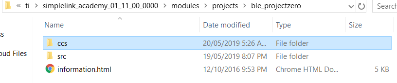

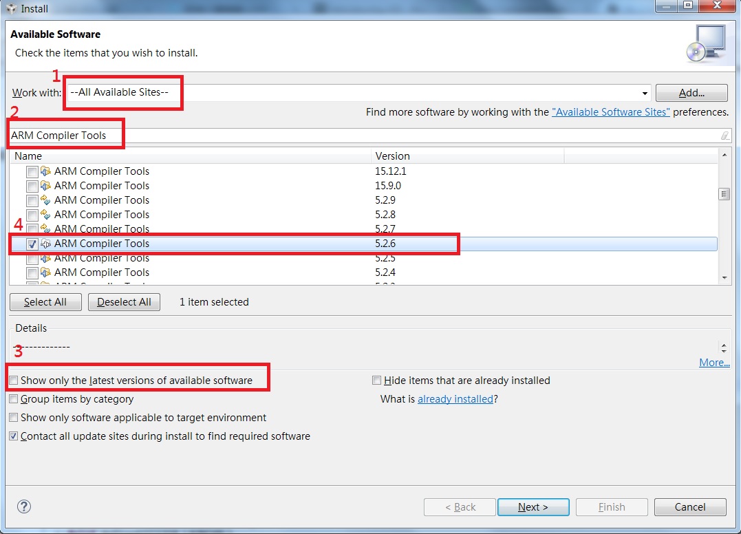

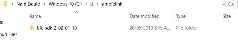

  • I do the following steps and I can build project_zero in simplelink_academy_01_11_00_0000 without problem.
    1. Install ble_sdk_2_02_01_18 under C:\ti\simplelink\ble_sdk_2_02_01_18 and simplelink_academy_01_11_00_0000 under C:\ti\simplelink_academy_01_11_00_0000

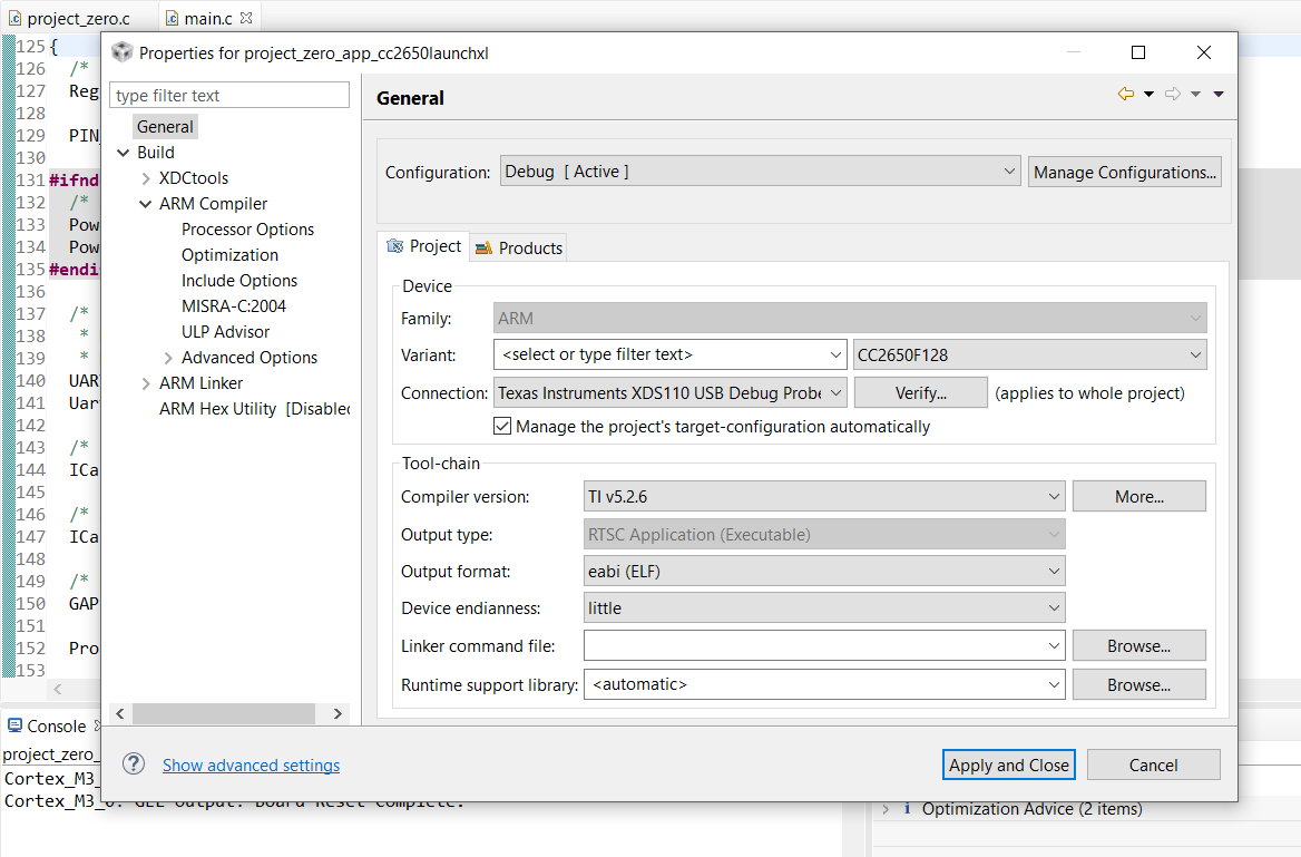

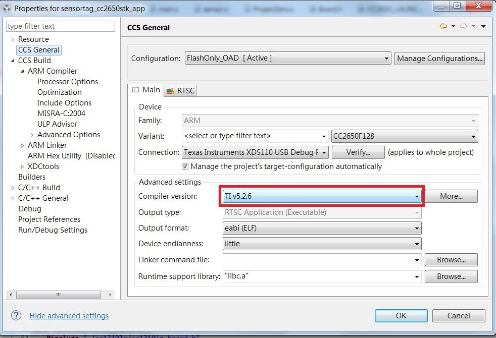

    2. Install ARM compiler version 5.2.6 in CCS.
    3. Import ble_projectzero from C:\ti\simplelink_academy_01_11_00_0000\modules\projects\ble_projectzero
    4. Build project.

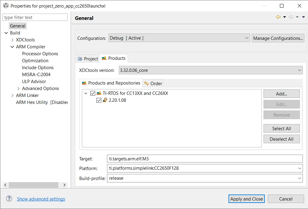

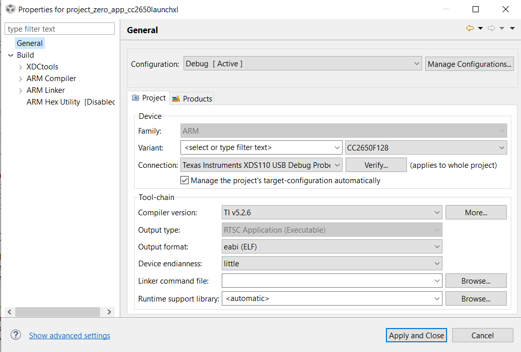

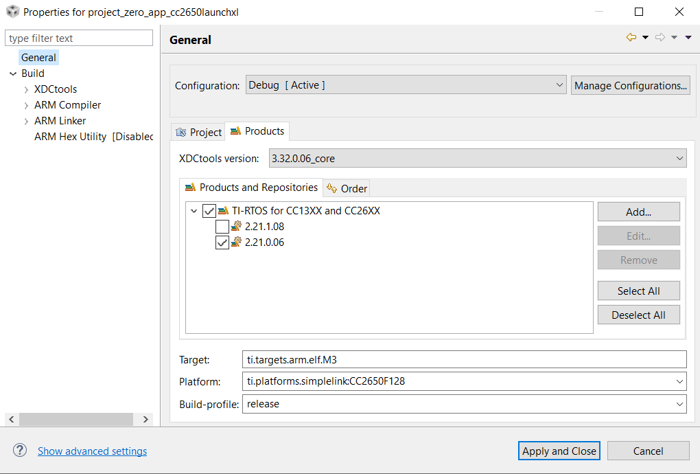

  • If everything is correct, TI RTOS version should be 2.20.1.08 not 2.21.0.06 in your screenshot. I would suggest you to uninstall all of your BLE Stack and SimpleLink Academy and reinstall everything to test from scratch.
  • hi YiKai
    thanks for your help, i try again and i found TI-RTOS 2.20.1.08

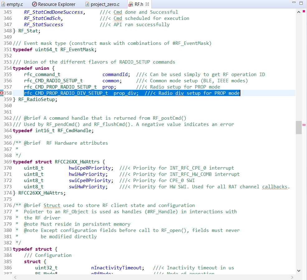

    it's in RF.h
    /// Union of the different flavors of RADIO_SETUP commands
    typedef union {
    rfc_command_t commandId; ///< Can be used simply to get RF operation ID
    rfc_CMD_RADIO_SETUP_t common; ///< Common mode setup (BLE, IEEE modes)
    rfc_CMD_PROP_RADIO_SETUP_t prop; ///< Radio setup for PROP mode
    rfc_CMD_PROP_RADIO_DIV_SETUP_t prop_div; ///< Radio div setup for PROP mode
    } RF_RadioSetup;

  • maybe i got a mistake when i delete folder ble_sdk 2_02_02_25, im not run file uninstall.exe in this folder, im only delete it. am i wrong?
    On ble_sdk_2_02_01_18, i run uninstall.exe then reinstall it by running ble_sdk_2_02_01_18.exe which i downloaded before

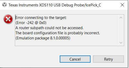

  • i'm just restarted my laptop and debug again. but this error come again:
    IcePick_C: Error connecting to the target: (Error -242 @ 0x0) A router subpath could not be accessed. The board configuration file is probably incorrect. (Emulation package 8.1.0.00005)
  • Try to use CCS 9.0.1 to see if it works for you.

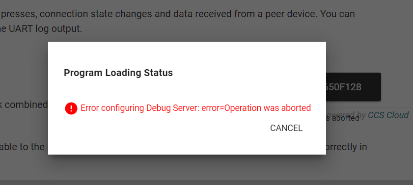

  • yes im reinstalling ccs. but i mean, about 2 days ago, i still load the project Zero ( from source in TI-Explorer ), it loaded complete and i can control led - read button. then i load project to CCS for learning, then the error appear. now i can’t load the project like before i do. i think, error come from my lauchpad, not from CCS...
  • this is my first loaded program,
    first, i can download and build the project in SOURCE into launchpad
    but now it cant be. this error:
    so i think the launchpad has problems..
  • Where does this error come from?
  • this error come when i download project 0 from dev.ti.com/.../index.html in source area
    2 days ago, it done, no error
    now it cant be done

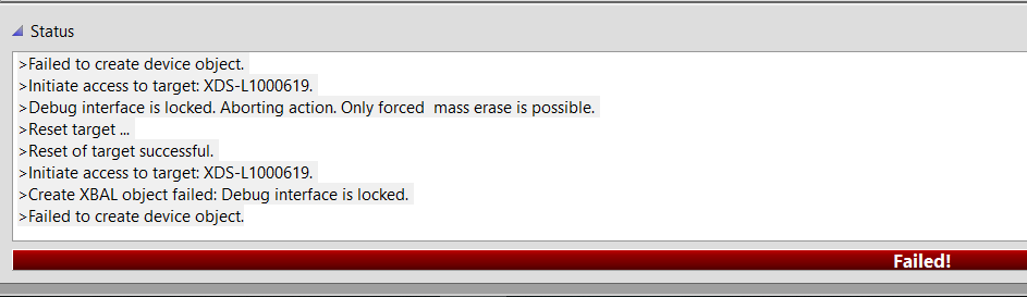

    maybe my debug interface be locked, maybe cause i'm try to load and reload project many times and it make a mess

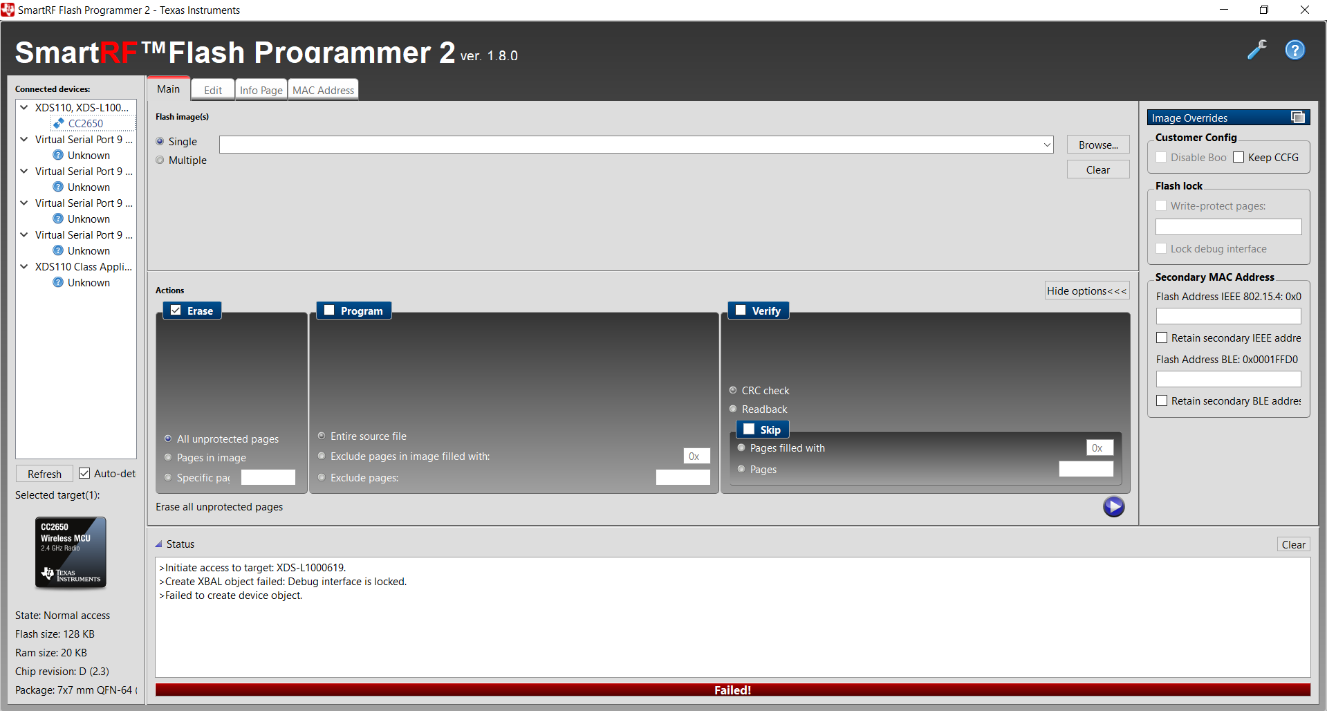

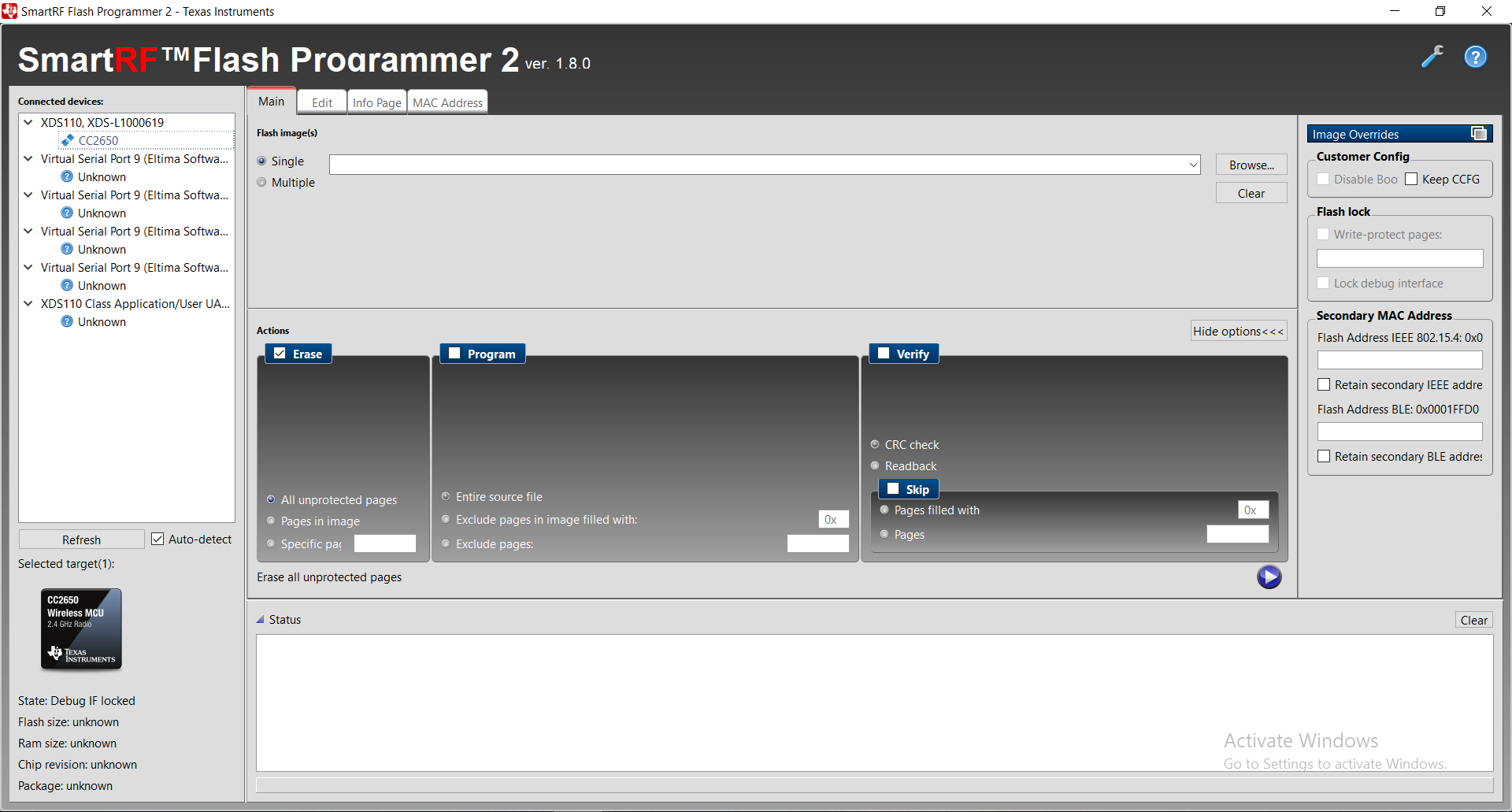

  • Try to use Flash Programmer 2 to do mass erase first and test again.
  • hi YK Chen
    i'm downloaded Flash Programmer 2 yet. but i can't connect or do mass erase.
    >Initiate access to target: XDS-L1000619.
    >Create XBAL object failed: Debug interface is locked.
    >Failed to create device object.
    try again
    which steps should i follow now?

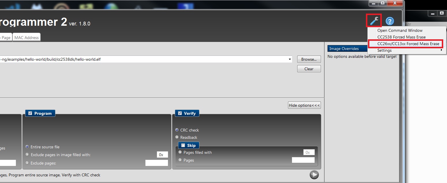

  • Do you click the wrench icon on top-right of Flash Programmer2 and select CC26xx/CC13xx Forced Mass Erase?
  • hi YiKai Chen, sorry ‘cause i’m late yes i click this, and click forced mass, but it can’t be done. the error i have posted in my reply. it said can’t connect to device, debug interface locked : (( >Initiate access to target: XDS-L1000619. >Create XBAL object failed: Debug interface is locked. >Failed to create device object. what should i do now?
  • Start a DOS cmd console and witch to C:\ti\ccs_base\common\uscif\xds110. Then, try to use xdsdfu.exe to update XDS110 firmware using the following commands to test again.
    xdsdfu -m
    xdsdfu -f firmware.bin -r

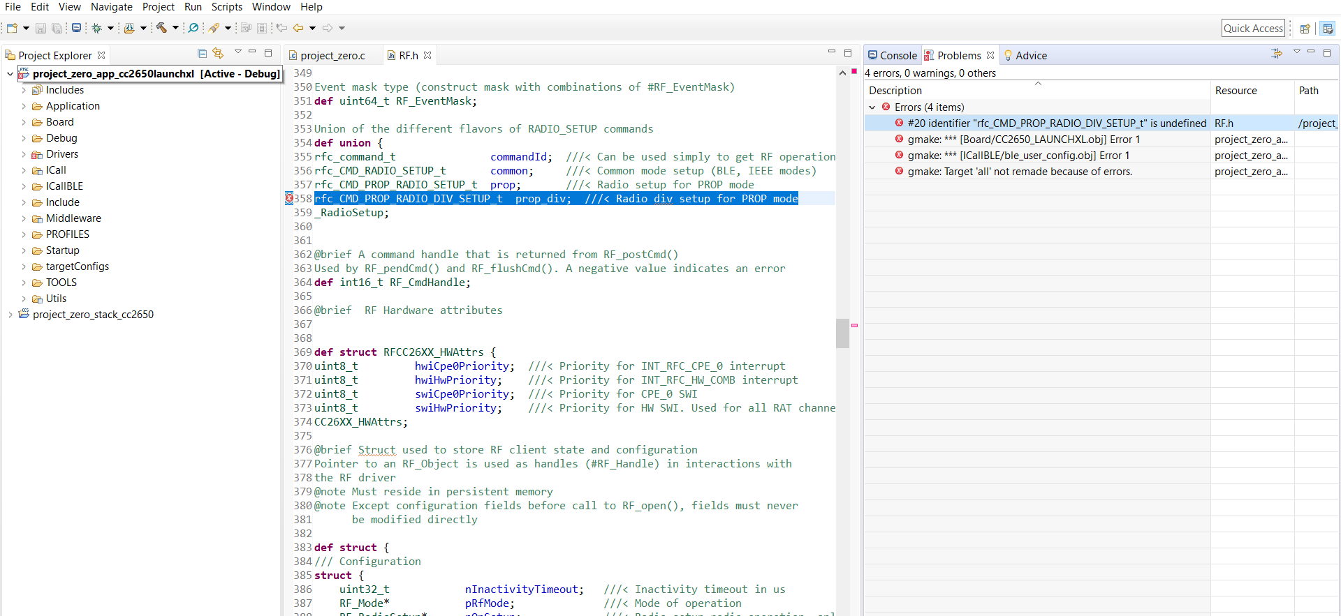

    which is here in RH.h:
    i'm using CCS 901 ( i'm just uninstall the old one and install the new one ), BLE_SDK 2_02_01_18, TI-RTOS 2.20.1.08 and Ti v5.2.6 compiler tool ( all as your suggestion before )
    But this error still appear.
    How can i fix this? i'm try to delete the line 358 ( line got bug ) then build okey, but when run project not active ( i can't see Project Zero on my Smart Phone, can't find the project )

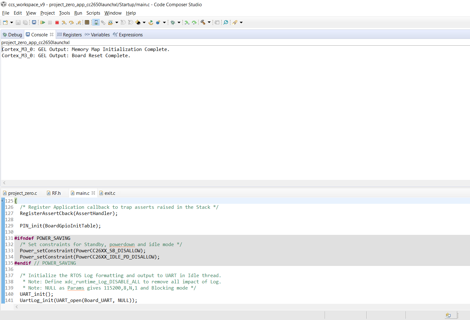

    then on my cc2650lp, the red light and green light next to TM4C129 ( I think it is debug chip ) turn on
    then on CCS i hit project > connect target ( first option )
    then the red light turn off, the green light still on
    then i open BLE Scanner app on my phone, but i can't see any Project or BLE Project Zero

  • typedef union {
    } RF_RadioSetup;
    i'm find out that
    rfc_command_t, rfc_CMD_RADIO_SETUP_t, rfc_CMD_PROP_RADIO_SETUP_t  was defined on rf_prop_cmd.h and rf_common_cmd.h, which are located in ti_rtos_2_20_01_08/products/...

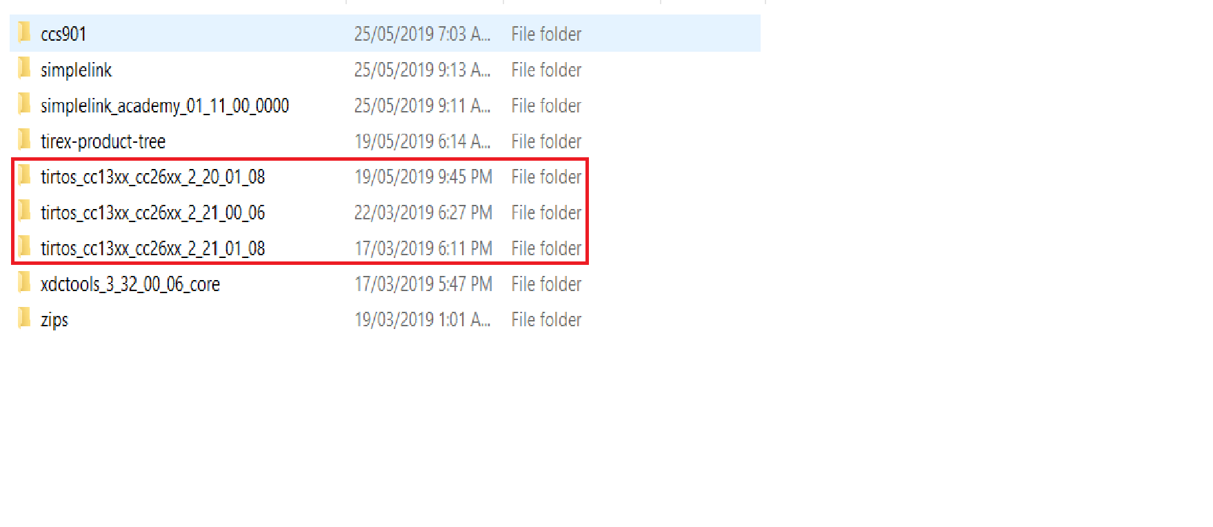

    so maybe my ti_rtos not true, it hasnt .h file for define  rfc_CMD_PROP_RADIO_DIV_SETUP_t which is make bug in here. so how can i retry? i dont know how to uninstall and reinstall ti_rtos, can u help me, any links or steps?
    and should we use 2_20_01_09 tirtos? i see three tirtos in my C>ti
  • I suppose you can delete TI RTOS folder directly and reinstall BLE stack will also install related TI RTOS back.
  • should i delete all 3 ti_rtos and run the ble_stack.exe i downloaded yet? should i download a new ble_sdk? and still setup 2_02_01_18 right?
  • Yes, I would suggest you to do what you described.
  • i can't fine ble stack 2.2.1, i'm just find 2.2.2 at www.ti.com/.../ble-stack
  • You can download BLE Stack 2.2.1 from BLE-STACK-ARCHIVE

    when i load project zero in CCS, the line make bug was gone: RF.h
    typedef union {
    } RF_RadioSetup;

    does RF.h of my project normal? can u check lines 352-258 on RF.h in your Project Zero? same like me or not?
    help me pls, it doesnt work...
  • My RF.h looks exactly the same as yours.
    typedef union {
    } RF_RadioSetup;

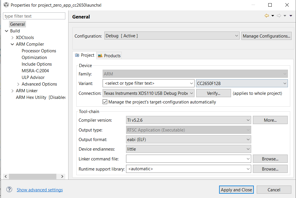

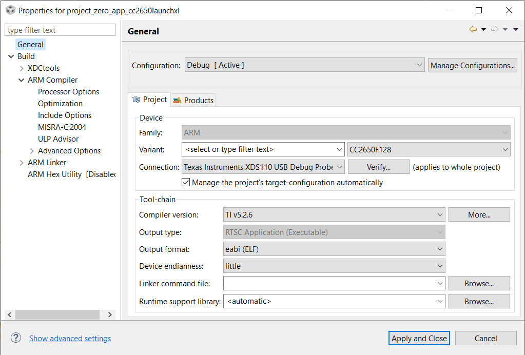

    Are you sure you use ARM compiler v5.2.6 when you build both of your ProjectZero app and stack project?
  • hi YK Chen sorry for my late
    I think i correct at config build, same as yours
    i dont know i build and debug complete without bugs or errors
