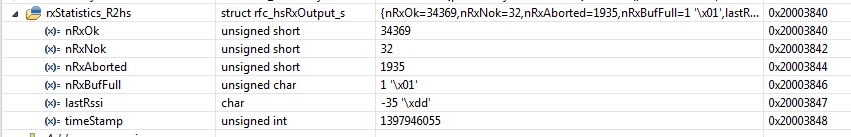

    Yet more information.
    In the CC2640R2F Technical Reference Manual, section 23.6.4.7 (Generic Receiver Command), it states "If the packet being received did not fit in the RX queue, the packet is received to the end, but the received bytes are not stored. If the packet would normally not have been discarded from the RX buffer, the operation ends.". This is what we are seeing, but there are a full compliment of RX queue entries available.
    Further, nRxBufFull element of the rfc_hsRxOutput_s structure is incremented on each RF_EventRxBufFull event, and after 9 minutes on our test rig, it reached the value of 65. 9 minutes equates to 27000 receive commands, of which in this instance, 65 were terminated early, with a claimed "buffer full" status.
    In this instance there was no deliberate perturbation, so the "buffer full" event causing receive commands to stop, just seem to happen sporadically.
    Some test code was also written to keep a history of all call back event bitmaps, and there were no packets with bad CRCs immediately prior to the "buffer full" event.
    Is this a bug in the radio code which erroneously thinks there is no space remaining in the RX queue (or buffer, or FIFO, depending on terminology)?
    Kind regards

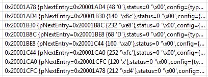

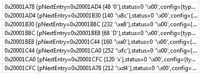

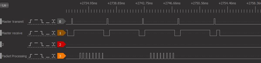

    Here is an example of early termination of a receive operation
    The trace, “Master Receive” is a timed receive window, and at the end, there is a short (early terminated) receive which triggers a break point when the call back event RF_EventRxBufFull occurs. The “Packet Processing” traces shows packets being processed under a separate task (activated via a counting semaphore).
    Under the same event, debug information was captured showing all 8 radio FIFO queue entries were empty (status = 0).
    Kind regards

    Could you share the complete RX cmd settings used (as seen in the RF settings file? In addition to this is would be helpful to know where/how you start a new RX operation (seems that there is RX windows without any processing at all).
    Would it also be possible for you to add the output structure to the RX command (pOutput assigned to a rfc_propRxOutput_s object) and share the information from this as well (this include for example nRxStopped and nRxBufFull)?

    Firstly, a quick word about the trace capture of LNA/TX lines. There was meant to be only data on one half of the receive windows, as I didn't have a full compliment of kit at the time. It was also beneficial in that it shows there was not an issue with callback and processing latency, as all previous packets have been processed well before the "buffer full" event, which appeared to occur on reception of a new packet.

    The "receive statistics" structure, on capturing a "buffer full" event is :
    If there is anything else you need to isolate this problem, please just ask.
    Kind regards#
  • Thanks Gary,
    Checking around internally, it seems like this should be related simply to the data entry size, what size are you using exactly? A colleague of mine recently discovered that there is an extra byte being appended on the length byte (we are still looking into if this is excepted or not), can you try to account for one or two bytes more in your buffers and see if that changes anything?

  • Hi Garry,
    "buffer full" in this case would only really apply to one specific scenario which is that the packet payload (not including any header, length fields or other appended data) is within the "maxLen" value but the buffer size is not large enough to handle maxLen + appended bytes.
    In this case there is a few things to consider with the HS when setting the "maxLen" and actual buffer size. For example buffer size should to be maxLen + length of appended data (such as 2 bytes for length field etc) + 1 byte if maxLen is odd. The last one is due to the padding done by the radio in order to facilitate the HS commands as it work on half-words only in this mode.
    This would mean that if you set maxLen to 255 and expect length to be appended, the buffers need to be 256 + 2 in order to receive the packet. If the buffer would also be 255 (buffer == maxLen) then a TX of 255 would be filtered out (as it is larger then the maxLen due to padding) and a packet of length 254 would case a "buffer full" as 254 + 2 lengthbytes = 256 (it passes the maxLen test but fails to fit into the buffer).
    Hope this is somewhat clarifying for your use case. You would need to make sure that maxLen != buffer length and that the buffer length is large enough to fit both the maxLen + appended bytes as these are not taken into account in the length check in the radio. Also note that maxLen should be EVEN in your application due to the padding, so if you expect up 255 bytes in your application, it need to be set to at least 256.
