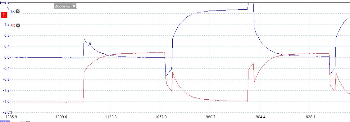

Trying to opposite-phase-synchronize two PWMs, using the PWMTimer driver in combination with the Timer from device driverlib.
I've included a scope shot of the waveform output (this is feeding a piezo, thus the capacitive coupling). This is the same regardless of whether the TimerSynchronize is there or not.
TimerWaitOnTriggerControl also doesn't seem to be working.

  • I should note that the output is measured on the piezo buzzer, not on the output legs of the MCU. So that's on the other side of the resistors from MCU. The waveform only demonstrates that the PWMs are not synchronized, and are otherwise quite expected. The red trace scale is not visible on the screenshot, but it is nicely settling on the expected 0 and 1.8 V.
    HW: Custom board, PWM outputs, drive strength high, 360K resistors to either leg of the buzzer. IO voltage 1.8 V.

  • First of all: I noticed the "||" where there ought to be "|" in TimerSynchronize. Fixing that didn't make a difference.

  • I tried it, and it didn't fix the issue. However, the documentation for TimerSynchronize explicitly states that one must use GPT0_BASE, and going to the source file in the SDK folder, it is even supposed to ASSERT that GPT0_BASE is used (as far as I can tell, the register is mirrored at all GPT blocks, but as it can synchronize across blocks, it shouldn't actually matter).
    That's another weird thing however: The assertion did not get triggered, when I used GPT2_BASE (though now I can't recall if I tried it on a debug build or not).
    Perhaps I'm missing something regarding the use of the Timer driver? Does it need any explicit initialization? Looking at the driver, it would seem to be a plain register access, with no preconditions.

    I switched the piezo to use GPT0 (no point waking it up just to synchronize), and tried again. Still no dice, the waveform remains unchanged.
