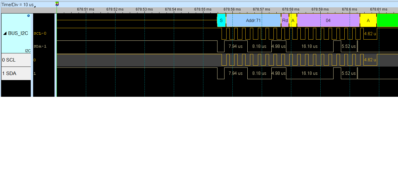

Our customer use CC2640R2 to connect I2C slave device. Sometimes, CC2640R2 I2C will hang and cannot recovery.
Below show the waveform when i2c transaction fail.
(1) The failure transaction is shown as below.
(2)  After the i2c transaction failure, cc2640 perform the i2c transfer and the waveform is shown as below.

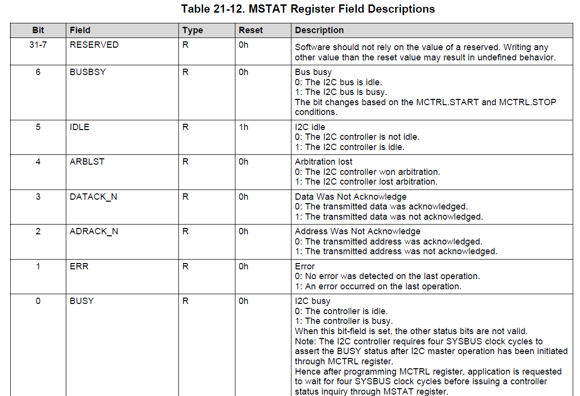

We found the MSTAT register (below Table) and the DATAACK_N bit keep to report 1.
May I know how to clear this bit by setting i2c regisgters? Thanks

    Please focus on why the MSTAT register and the DATAACK_N bit always keep to report 1 when we recovery I2C.
  • Hi Jerry,
    The register indicates that the data sent was not acknowledged. There is also a clock pulse missing during the ACK, so these are probably connected. Have you looked into why the clock pulse is missing? Is the slave doing clock stretching for some reason?
    Could it be that the signals are distorted somehow? What pull-up values are you using, and what I2C speed?
    I do not fully follow your explanation of what happens. In logic analyzer capture 1, the CC2640 is trying to write data to the keyboard IC, right? And the DATACK bit is set after the data byte has been transferred? What happens in the I2C driver code at this point?
    Fredrik
  • Have you looked into why the clock pulse is missing? Is the slave doing clock stretching for some reason?
    ==> I am not sue why the clock pulse is missing. The clock is generated by cc2640 and I2c hardware should generates 9 clocks when we perform the R/W operation on I2c registers.  From waveform,the signal keep high after 8 clocks so it's not stretching by slave.
    ==> yes, cc2640 is trying to send 32 bytes but the signal is corrupt at writing the second byte to device.
    ==> yes, the DAYACK is always set after data byte has been transferred.

    My point is that why the DATAACK always report "1". We have tried to send the all of commands (as below)to 0x804 Master control register by JTAG
    but the DAYACK Bit is always set.

  • Hi Jerry,
    The DATACK bit means that the data was not acknowledged by the slave. This is most likely connected to the missing clock pulse somehow.
