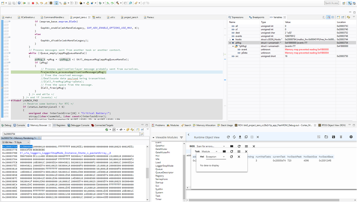

I'v having trouble debugging my application. First a few specifics:
My application is expanded upon the Project_zero Bluetooth 5 project using the CC2642R1F Rev C. chip on a LAUNCHXL-CC26X2R1 Dev kit. (Rev B.) on the 2.30 SDK.
As a note i do have access to the Rev E. CC2642R1F chip and the latest SDK (3.10)
I am using CCS 9.0.1 on Windows 10.
The specific issues is that my App Msg queue in the Project_Zero Task appears to be corrupted after a long running computation. In detail, it appears that a message (of type pzMsg_t) had been de-allocated and is now pointing to memory outside of the memory map declarations.
Here is watch in the debugger:
Whats more interesting is that if i remove this for loop from the execution loop, my AppMsg queue is not corrupted:

  • Hi Brett,
    It looks like the Queue is corrupted as you say. Or rather the queueRec_t that util.c uses, that contained the pointer to the to pMsg.
    If you find on repeat runs that the addresses are always the same you could use a Hardware Watchpoint to break when the contents of queueRec->pData is overwritten, to see why/where this happens.
    You could also use HeapTrack instead of the regular heap provider, it includes more checks and things for heap corruptions, and should also break on double frees. See the cfg file and/or the debug guide in the User's Guide.
    I suppose you have checked that the task heaps are not near full? Near full (as seen by the watermark bytes) could still mean that another stack frame overran the stack but just didn't use the allocated watermark bytes for anything.
    It's very strange that a simple 1024 count loop should be the hair that breaks the camel's back, except of course if the float *extended pointer is not long enough :p
    Aslak

    Thank you for the debugging tips. That specific issues was that i was never allocating data for the message and always sending Characteristic updates with bad data!. See code below:

    This works great with the Busy and ClocksRunning flags. However when those flags are removed and events are allowed to process during my long-running/heap intensive operations i receive ICall_malloc exceptions probably due to the fragmentation of the heap. I am allocating large sections of the heap for arrays, ~8000 bytes. Heap fragmentation is understandable and its probably prudent to not address non priority events during intensive/large heap operations.
    I think the bottom line here is that i am taxing my Heap intensively. Perhaps for smaller variables the stack is better to use?

  • Hi Brett,
    It's not impossible that you are taxing the heap and indeed getting fragmentation issues. If you switch to the HeapMem heap manager (see the cfg file) you can use the ROV to look at the FreeList and see if it's fragmented. With HeapMem you should also be able to make a secondary heap that you can use through the Memory_ APIs in the kernel.
    See the User's Guide and the runtime APIs of the kernel: dev.ti.com/.../node
