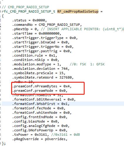

Dears:

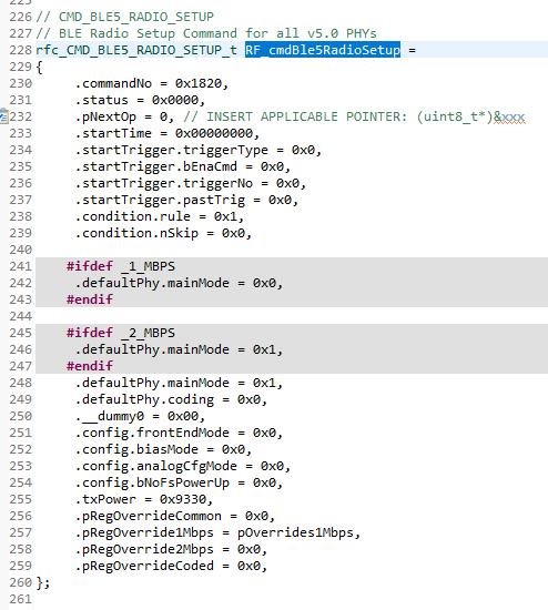

Could you kindly help to set the premconf under 1M with the Private Protocol?
And only find the premconf under 100K referred the below pictures:
  • When using the BLE PHY the preamble is given by the BLE spec and is not configurable, as it is when using a proprietary PHY. Also note that the BLE5 PHY that you are referring to is not supported by the CC2650.
