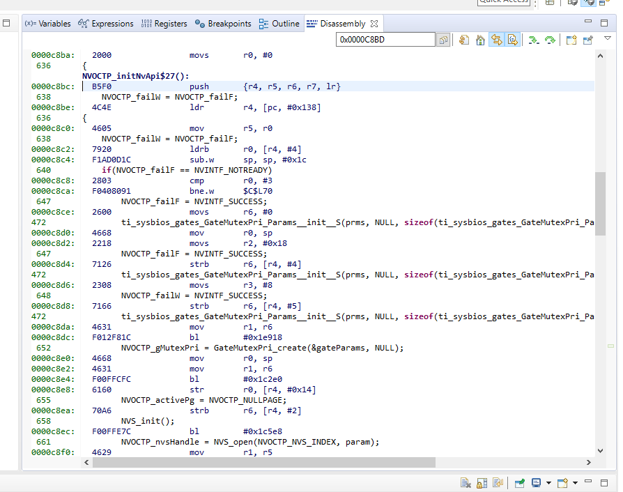

osal_snv_init seems to get called somewhere, at least nvFptrs is filled:
Any hints? Any help appreciated.
