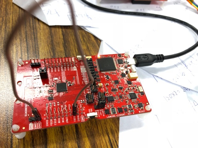

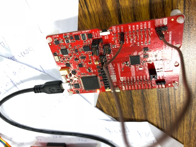

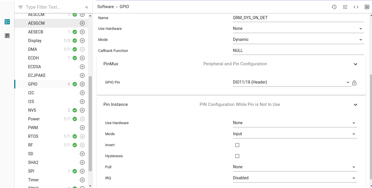

We use the project_zero to develop our application on latest SDK(syscfg_preview version).
We would like add the input pin(DIO11) into project_zero, but we always got high level for DIO11(we already connect DIO11 to ground). please see the following photo.
For SYS_CFG setting, please refer to following photo:
For modification code:

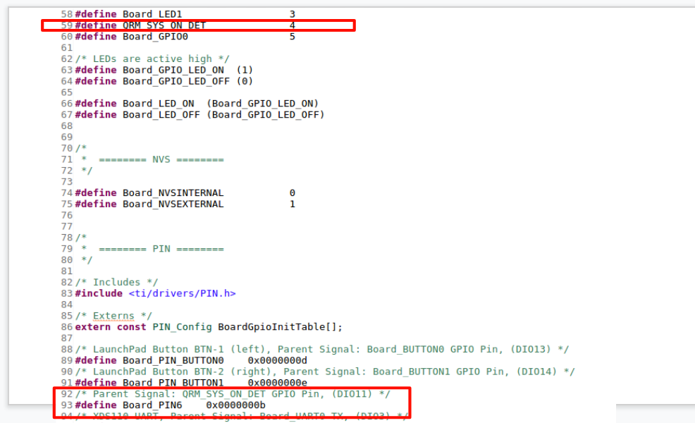

    Did you build the project in order to trigger SysConfig to generate the configuration code? Can you check the gpioPinConfigs array in Board.c/.h (and share a picture) to ensure that the gpio was configured correctly?
    Alexis
  • Hi Alexis,
    About Board.c/.h, please see the following photos. in this example, it uses the PIN module(not GPIO module). I also found one thing that it doesn't contain PIN module driver example in SDK exmpale(ti/simplelink_cc13x2_26x2_sdk_3_10_00_53/examples/syscfg_preview/rtos/CC26X2R1_LAUNCHXL/drivers).
    For Board.h
    For Board.c
    Thanks.

  • Hi Trevor,
    I'm glad you were able to get your project working with the GPIO module.
    As for the pin module...have you tried using the BoardGpioInitTable[] created by sys_cfg in Board.c/.h instead of the one you created when performing your Pin_open() function call?
    Do you get any errors?
    Alexis
  • Hi Alexis,
    Thanks for your reply, about the following code, if I replace QRM_SYS_ON_DET with Board_PIN6, the PIN module will work.
    But I think the "QRM_SYS_ON_DET" macro is more readable than "Board_PIN6", how to configure the macro name in SYS_CFG(for example: Board_PIN_Button0 and Board_PIN_GLED)?

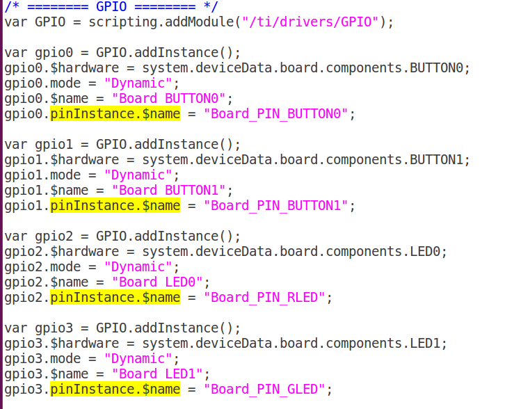

  • Hi Trevor,
    Using SYS_CFG, no this isn't really possible. To do this, you would have to add it to the defines in Board.h
     *  ======== GPIO ========
    #define Board_BUTTON0          0
    #define Board_BUTTON1          1
    #define Board_LED0                  2
    #define Board_LED1                  3
    #define Board_GPIO0                4
    But any changes you make yourself to Board.c or Board.h will be overwritten next time you build SYS_CFG.
    Basically, if you want to change this you would have to remove SYS_CFG from your project and configure your Board.c or Board.h yourself.
    Alexis
  • Hi Alexis,
    If you open the SYS_CFG file with a text editor, you can see the macro name is defined in pinInstance.name field. So I think TI should add this field in System Configuration Editor(Just a suggestion).
    Thanks.
    BR
    Trevor
