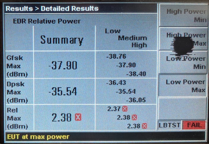

  • Hi Vihang,
    for the result is shown below:
    DUT at Min. Level:
    DUT at Max. Level:
    specification for EDR relative power is (P GFSK  - 4dB) < P DPSK  < (P GFSK  + 1dB)
    I think DUT at Max. Level has enough buffer for the Spec but  DUT at Max. doesn't.
    i tried to modify power level 0 or 8 in 2MB table, but not help.
    Kevin

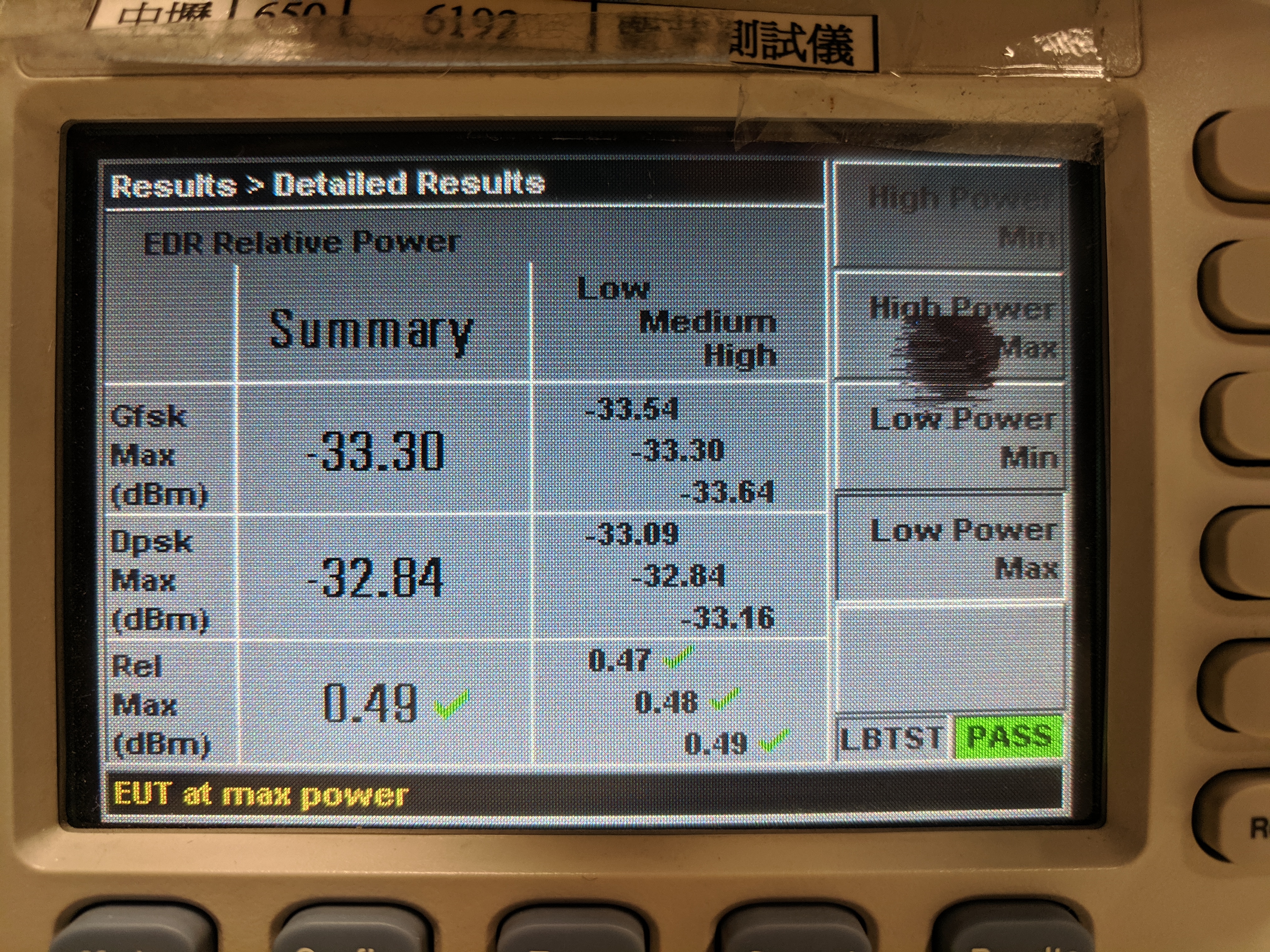

  • Hi Vihang,
    here is what I experiment:
    #1 ERD power = BR value + 2

    In the first modification, the difference in DUT at Min. Level is pass.
    but in second modification, the test result is still the same with #1. I'm wondering whether experiment#1 is the best setting.
  • Kevin,
    Sorry for the delay.
    Typically, the max EDR power is kept several dB less than the max GFSK output power. Additionally, I also noticed a large step size in your settings that might be responsible for such failure.
    Please start with the following settings and reduce each step, half a dB at a time, if needed for certification.

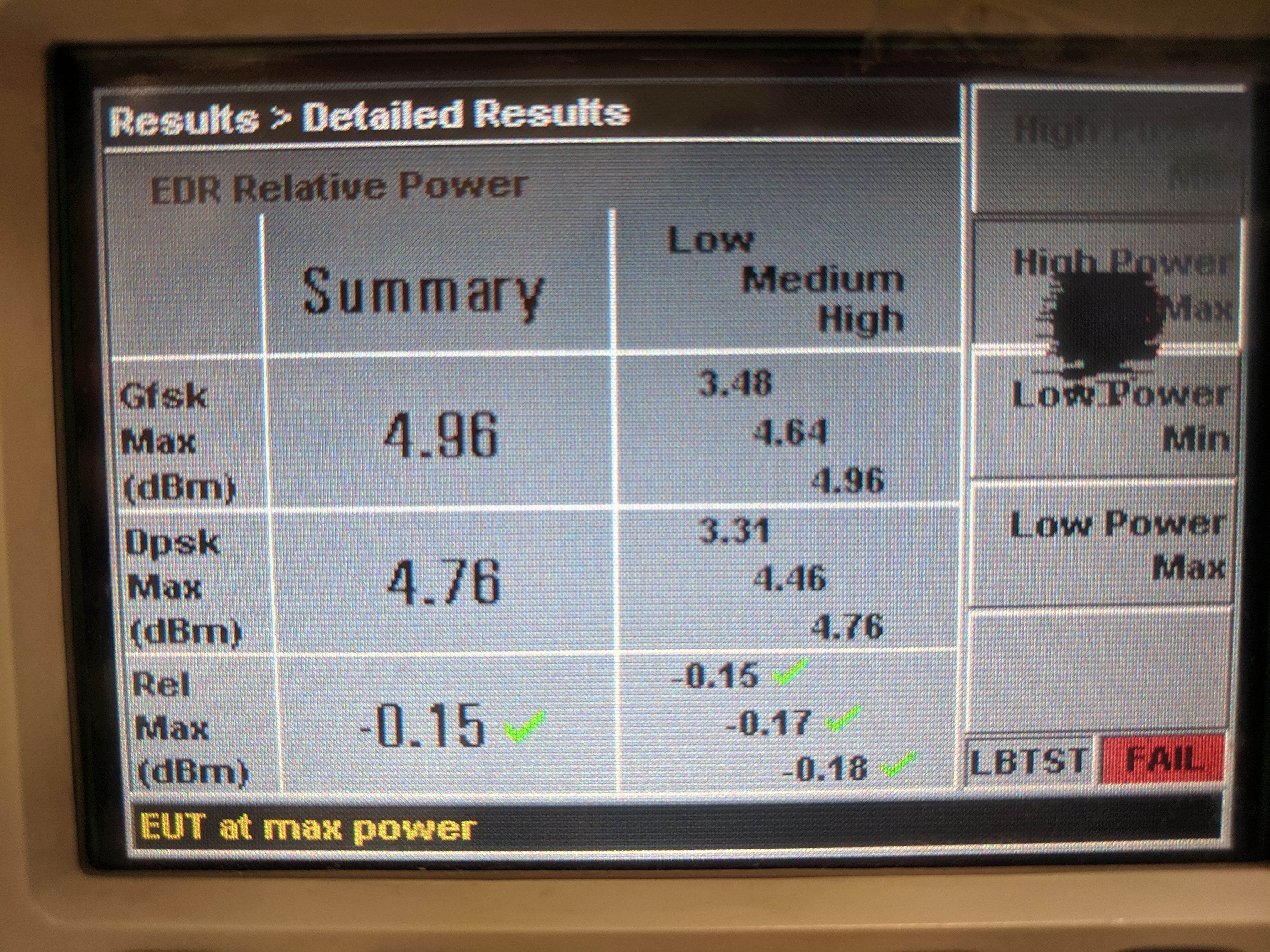

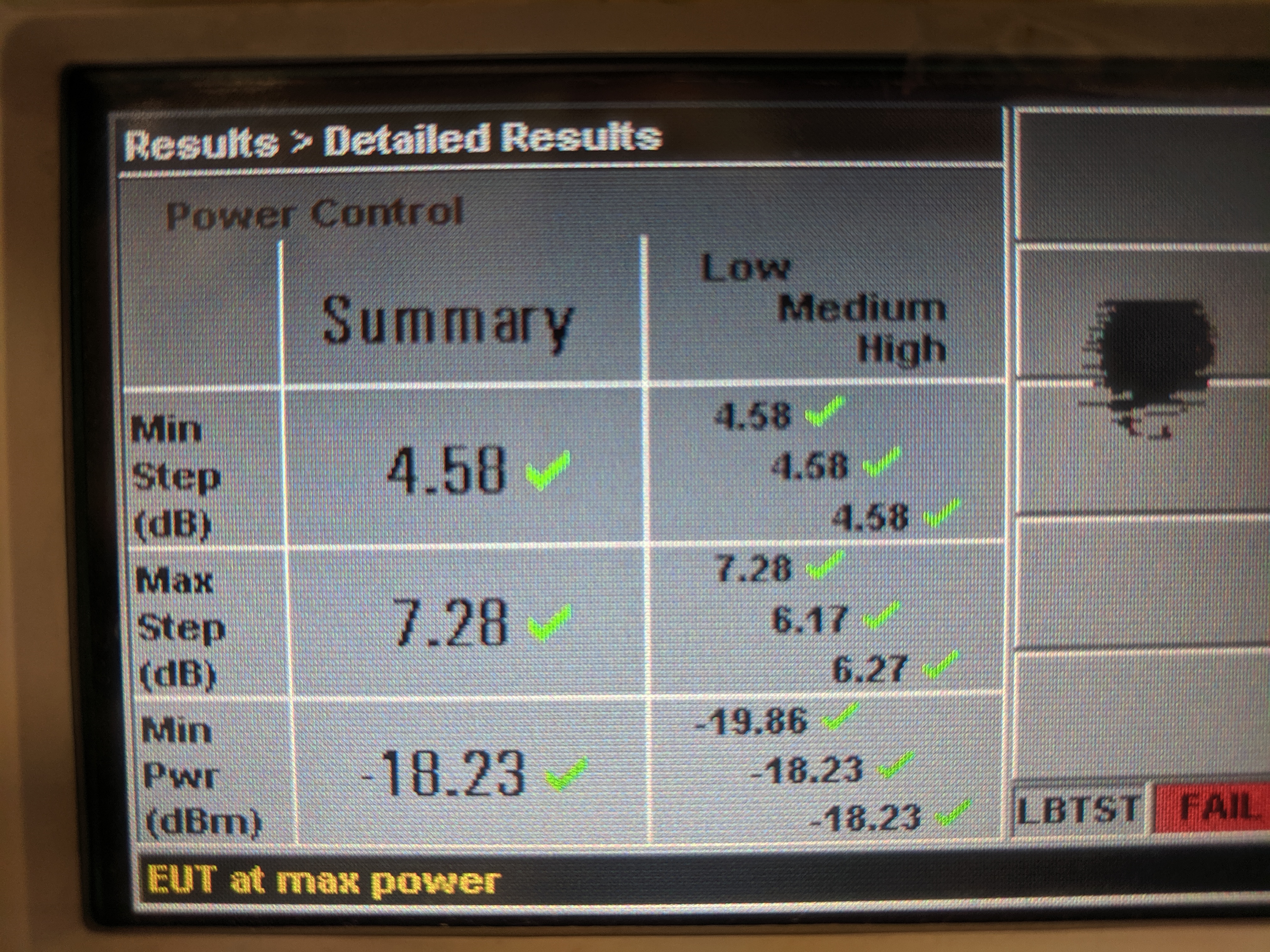

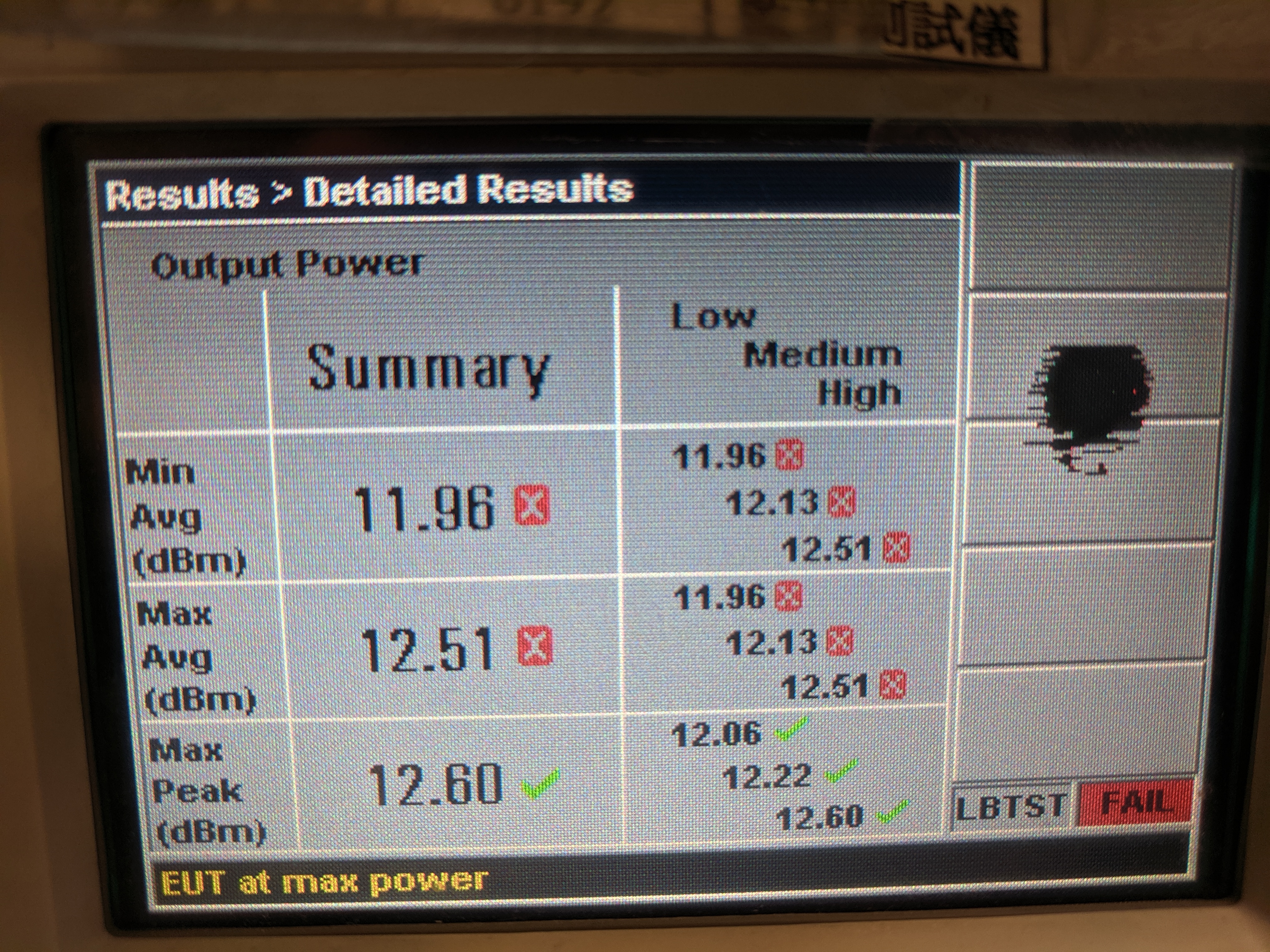

  • Hi Vihang,
    I retest the item with new parameter you provide, and the results get better although output power is too large.(shown as below)
    output power for BR(GFSK)
    power control for BR
    EDR relative power (Max difference for high power)
    EDR relative power (Max difference for low power)

    1. Is the output power in BR around 12 dBm defined by power level 15 value in "Send_HCI_VS_DRPb_Set_Power_Vector" ( real power value*2 and convert in Hexadecimal)? so,in EDR 2MB, maximum output power is around 5.5 dbm (0x0b) ?
    2. Does power control result come from the difference  between each the GFSK power level value of Send_HCI_VS_DRPb_Set_Power_Vector?
    3. In TP/TRM/CA-10-C, EDR relative power is define as "(P GFSK  - 4dB) < P DPSK  < (P GFSK  + 1dB)". Doesn't that mean the difference is between same power level setting ?(e.g.  result = (power level 15 value of GFSK) - (power level 15 value of DPSK))
    4. if I want to decrease BT output power to meet Bluetooth power class 2, should I subtract  a constant for every power level value in three Send_HCI_VS_DRPb_Set_Power_Vector or I just modify Send_HCI_VS_DRPb_Set_Class2_Single_Power?
    5. In chip WL1833, does it keep the same dB less between the max EDR power and the max GFSK output power for BT setting?
    Kevin
    That is correct.
    Yes.
    The test spec refers to the average power. Due to the PAPR difference between the two modulations, the 12dBm and 5.5dBm peak powers are still within spec. To be on the safe side, you can lower just the GFSK power accordingly (all power levels as mentioned below).
