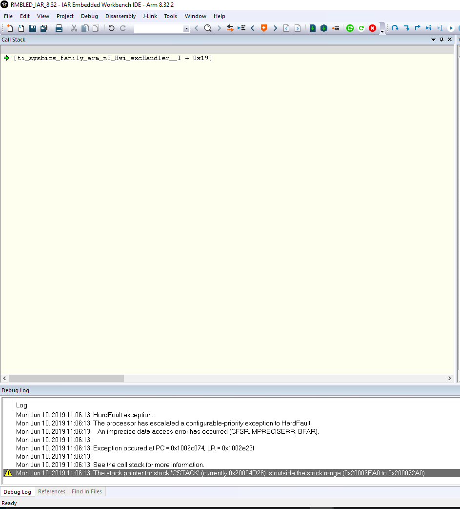

I used Mutex to lock critical variables form being interrupted, but after call GateMutex_enter, MCU will be dead. i don't know why
This was used in CC2640R2 SDK V1.40, and is OK. But failed in CC2642R SDK 3.10.00.53
code as:
GateMutex_Struct SendmutexStruct[DATA_SEND_DIR_NUM];
GateMutex_Handle SendmutexHandle[DATA_SEND_DIR_NUM];
IArg SendmutexKey[DATA_SEND_DIR_NUM];
                                GateMutex_construct(&SendmutexStruct[TO_AIR], NULL);
                                SendmutexHandle[TO_AIR] = GateMutex_handle(&SendmutexStruct[TO_AIR]);
                                GateMutex_construct(&SendmutexStruct[TO_UART], NULL);
                                SendmutexHandle[TO_UART] = GateMutex_handle(&SendmutexStruct[TO_UART]);
                                #if SEND_MUTEX_EN
                                SendmutexKey[dir] = GateMutex_enter(SendmutexHandle[dir]);
                                #endif
