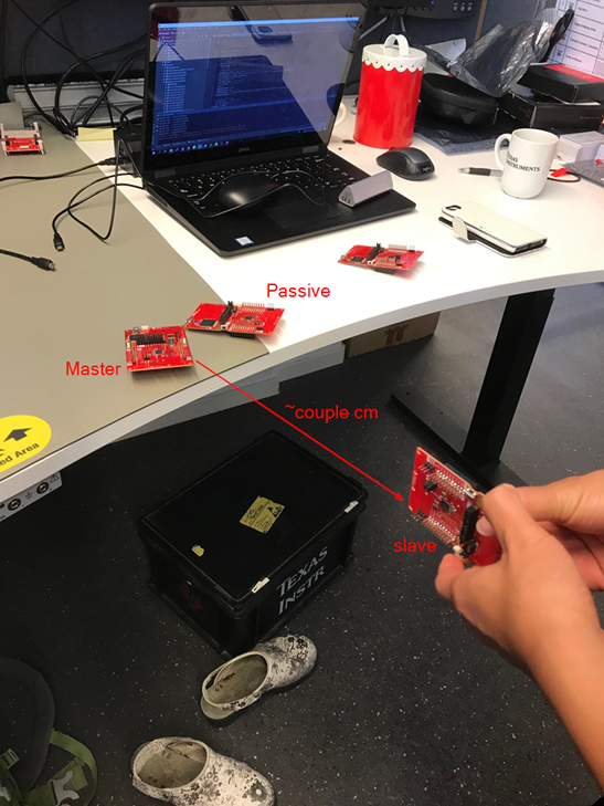

    As a general note, while the SDK uses 1m calibration distance by default it is best to use 0m (keeping the boards only a few cm apart to prevent RF saturation). You can orient the boards as shown in the picture below.
    It is recommended to calibrate outdoors with the boards laid in the grass.
