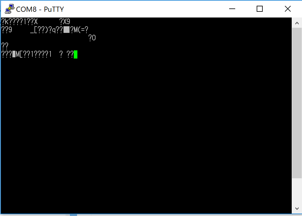

    But when I started PuTTy and pressed the reset button, an error occurred.
    The attached is the screenshot of the PuTTy and CCS.
    Would you help me to resolve this?
    Tom.Liu
  • What is the baudrate you use on Putty? Is it 115200?
  • Hi Chen,

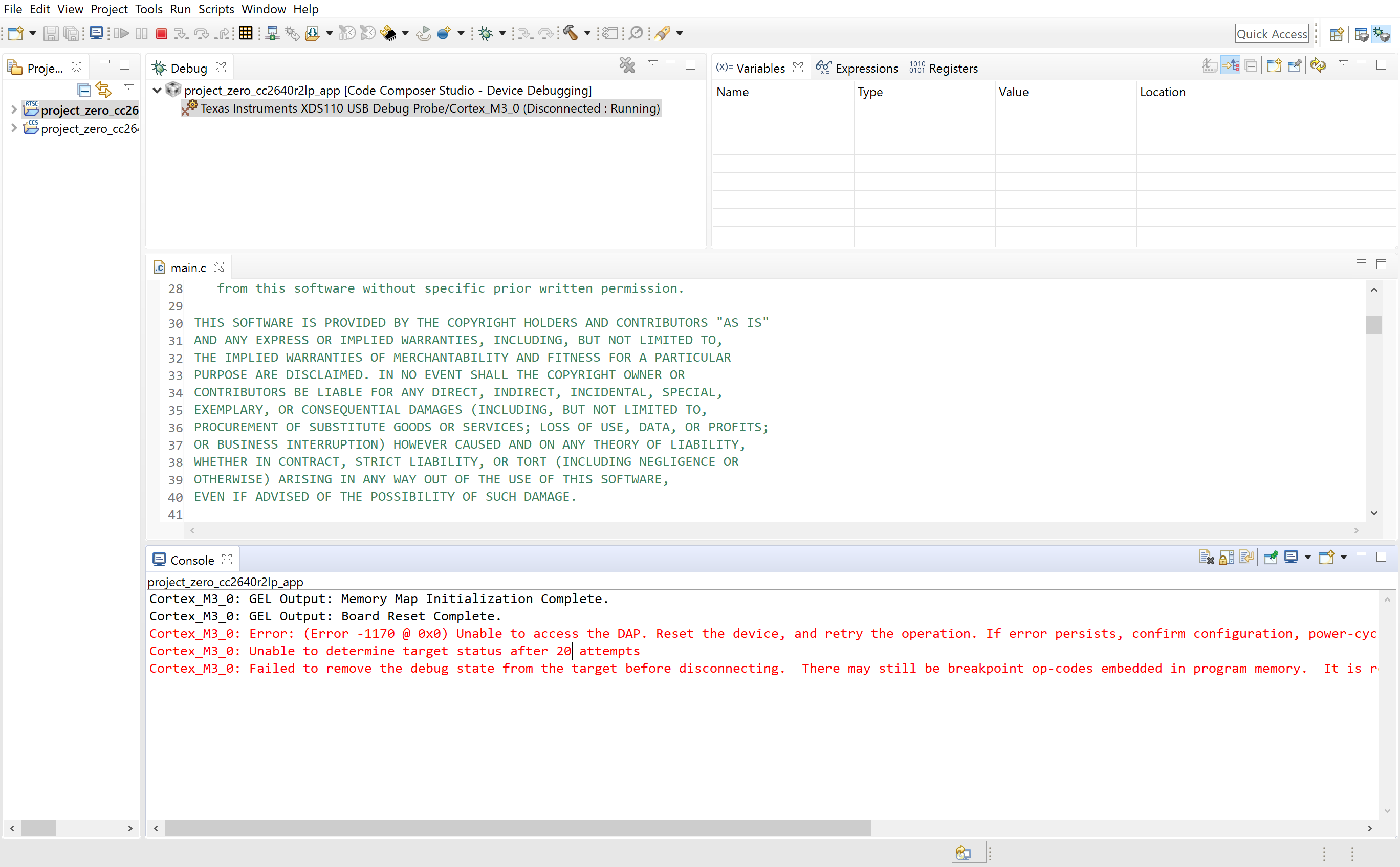

    It was "9600". After changing to "115200", logs are now output to Putty each time the Reset button is pressed. However, when I pressed the device's Reset button, the phenomenon that an error was output to the CCS Console remained. I reset the device many times, but the situation is not improved.
    The error message is as follows.
    Cortex_M3_0: Error: (Error -1170 @ 0x0) Unable to access the DAP. Reset the device, and retry the operation. If error persists, confirm configuration, power-cycle the board, and/or try more reliable JTAG settings (e.g. lower TCLK). (Emulation package 8.1.0.00007)
    Cortex_M3_0: Unable to determine target status after 20 attempts
    Cortex_M3_0: Failed to remove the debug state from the target before disconnecting. There may still be breakpoint op-codes embedded in program memory. It is recommended that you reset the emulator before you connect and reload your program before you continue debugging
    Tom.Liu
  • When you press reset button, it's normal to see JTAG disconnected.
