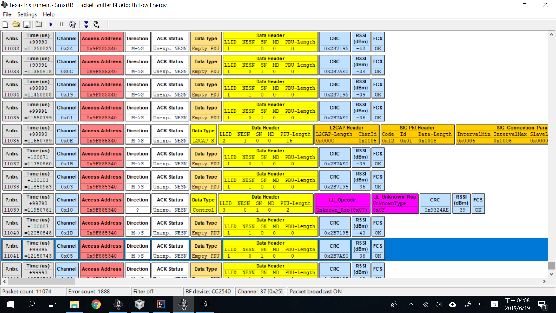

When I want to exchangeMTU (GATT_EXCHANGE_MTU)by btool, it would end up MSG_BUFFER_NOT_AVAIL.
If I don't do any operation with btool. it would disconnect 7 seconds later after connection establishing.
It ends up the situation like the following screenshot.
any idea to figure out what happen?

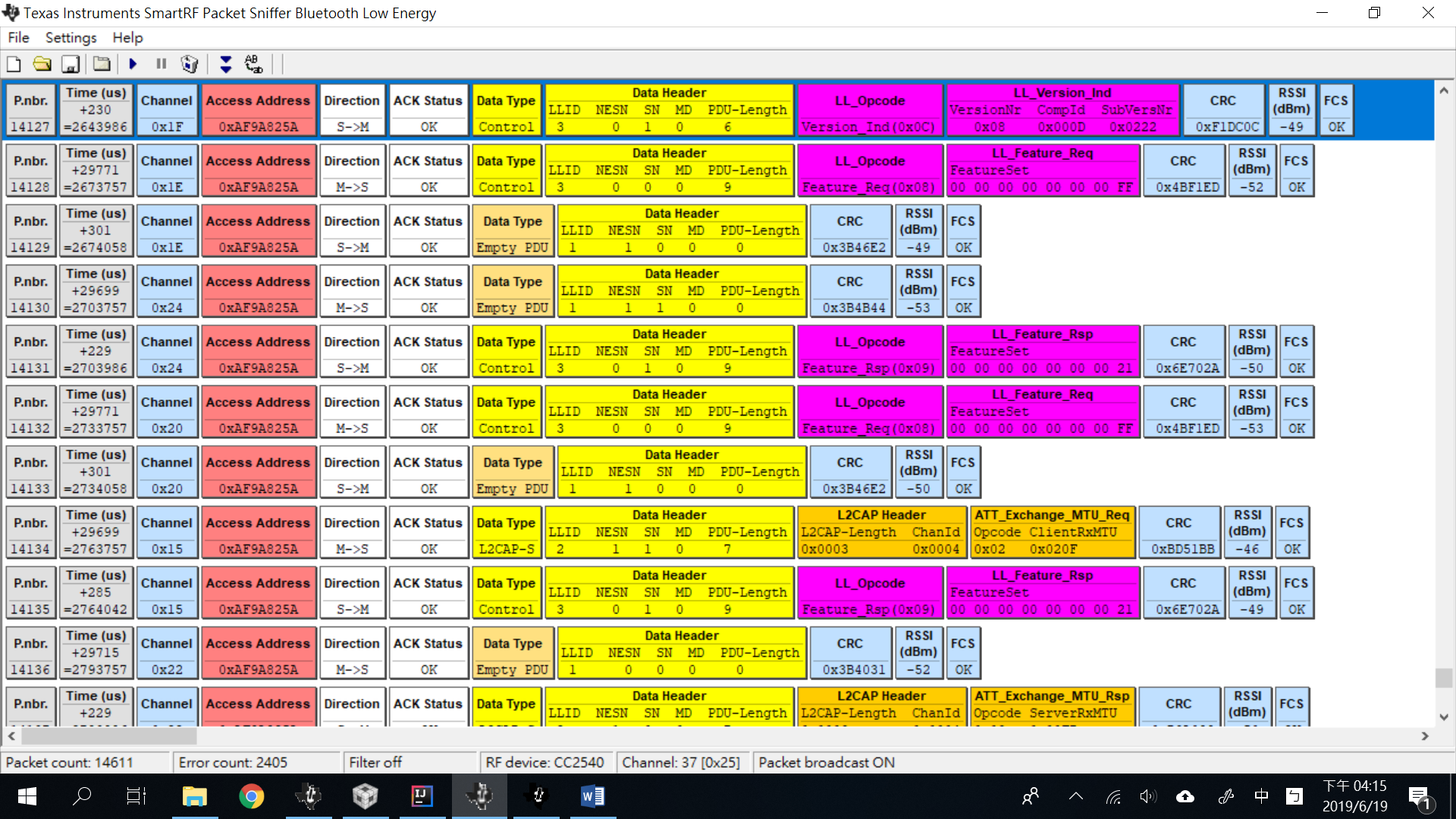

  • for some experiement with packet sniffer.
    I don't see any data length extension procedure which is done over air.
    another question about LL_feature_set_meaning , acorrding to official document of bluetooth , page 2653 feature support.
    It looks like my simple peripheral don't support data length extension. How come?
    condition : cc2650(host_test with btool ) connect to cc2650(simple_peripheral)
    condition 2: IPad (BLE scanner) connect to cc2650(simple_peripheral)
    if the feature set is little endian, we can find that simple peripheral do not support LE Data packet data length extension according to
    specification of bluetooth system, v5.0 page 2653 feature support.
    If i make some mistake about its meaning or I follow the wrong procedure?
    into my application?

        there is some problem with host_test,
    if I uncomment /* -DBLE_V42_FEATURES=EXT_DATA_LEN_CFG */  in host_test_stack config.opt
    from btool, the connection will disconnect right away.
    if i want to send gatt_GATTWriteCharValue , there is an error occur because of msg buffer is not available.
