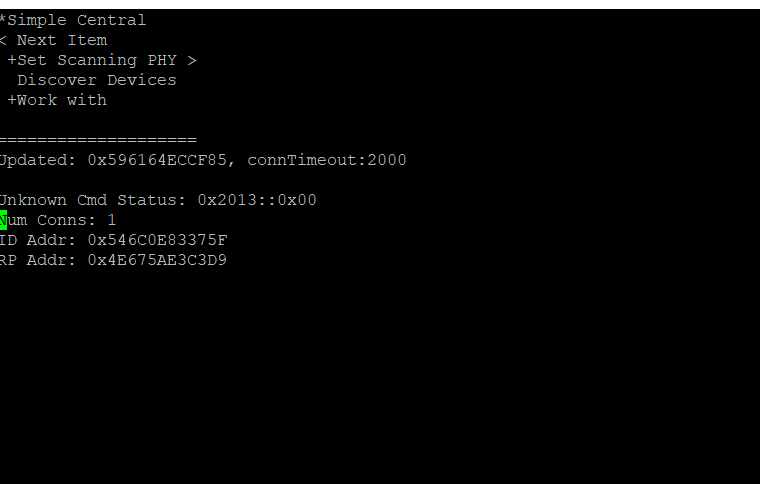

I'm trying to connect to my Bluetooth beacons through the simple central project. I'm able to discover some devices but in the *Connect to menu I'm not sure if I'm even seeing the beacons. Are the values that you discover the devices Bluetooth address? I'm not seeing my beacon's Bluetooth address on the list if that is the case.
Also when I try to connect to any of the devices, I get a Paring fail: 5, then this:
and then the device disconnects and I can't even do any of the +Work with menu stuff.
Any advice? Do I need to configure my beacons or the code in some special way so it doesn't disconnect after a few seconds?

    I'm able to connect to a beacon, and if I'm quick enough I'm actually able to view some RSSI values.
    Every time though, after just a few seconds of being connected, I get a message on the console saying "Param update: 0" then it disconnects and the message says "Disconnected: Reason 19."

  • Hello Aaron,
    Disconnect reason 19 means LL_STATUS_ERROR_PEER_TERM (ll.h). This means that the beacon issued a disconnect possibly due to undesired connection parameters. I cannot guess without a sniffer log of the connection.
    You can try to adjust the connection interval settings for connection paramters update request (DEFAULT_UPDATE_MIN_CONN_INTERVAL, DEFAULT_UPDATE_MAX_CONN_INTERVAL). But a sniffer log can help.

  • You were right with your initial assumption. The program and beacons are both functioning correctly. I contacted the company and the beacons are the ones issuing a disconnect. Thanks for the help!
