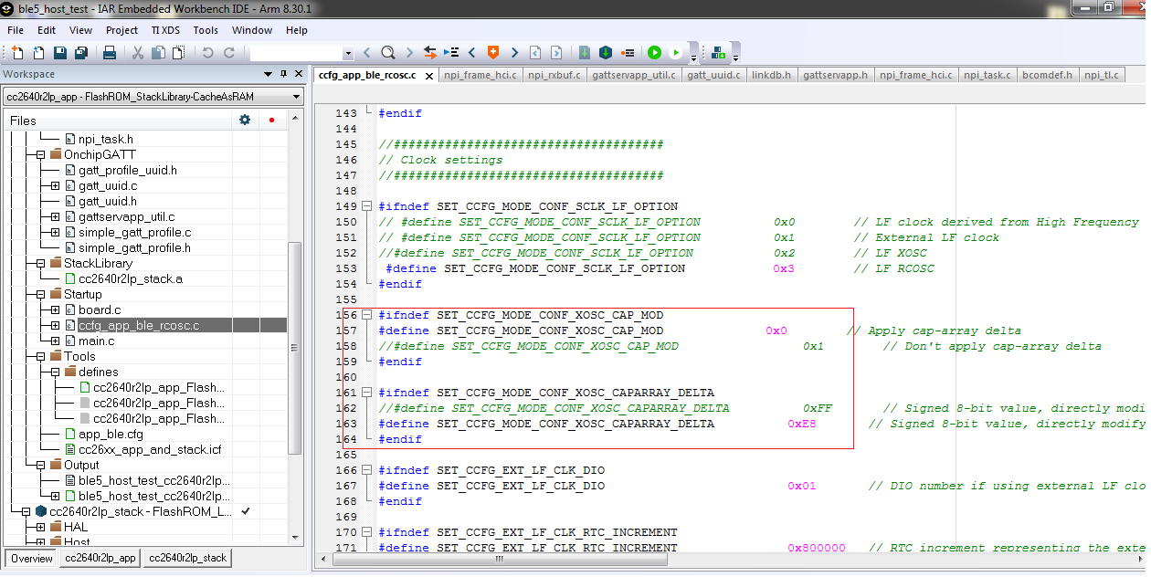

    In SDK cap array enable or disable setting is available for RC_OSC setting. Kindly find the following screenshot.
    Bhavin
  • Hi Bhavin,
    CCFG fields are fixed, all options are always available. Anyway, based on the screenshot, I assume you mean that you are talking about the low frequency (32 kHz) clock. You are still using a 24 MHz crystal, right?
    The cap-array is used to tune the 24 MHz crystal oscillator, it has nothing to do with the LF clock. More details about crystal tuning can be found in www.ti.com/lit/pdf/swra640

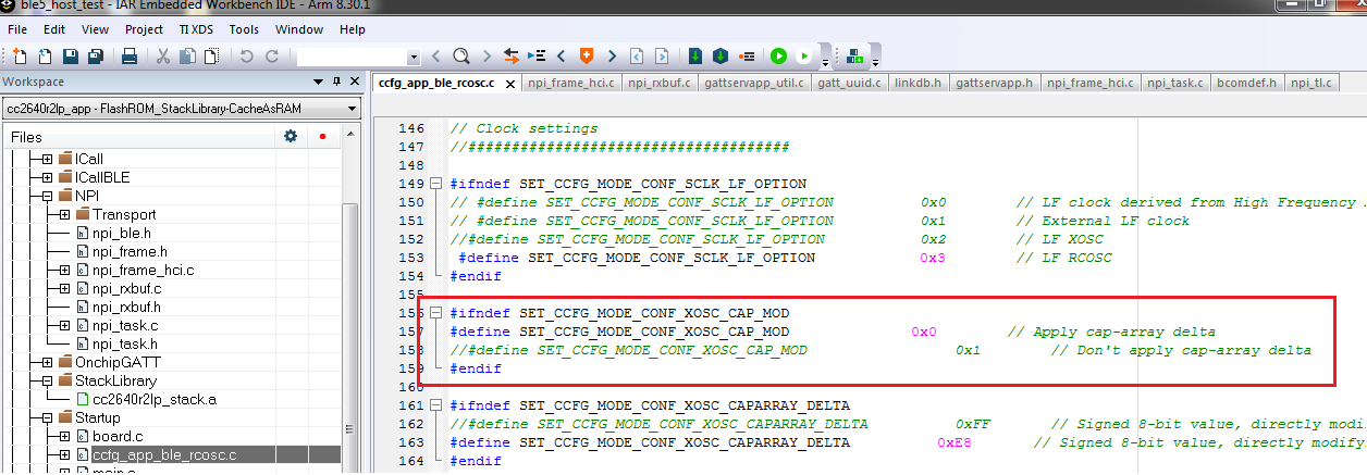

    Crystal Oscillator enable/disable means cap array enable disable you are talking about ?
    As per following screenshot.
    Bhavin
  • Hi Bhavin,
    No, I mean whether the actual crystal oscillator is running or not.
    Fredrik

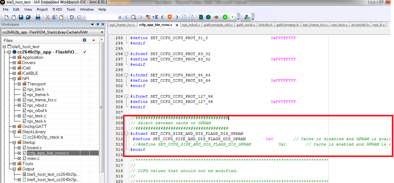

    I just wanted to modified host test(SDK simplelink_cc2640r2_sdk_2_30_00_28) example earlier which was configured as cache_as_RAM and used ble module with external 32 KHz crystal but now for module without 32 KHz still want to used cache_as _RAM but with internal RC.
    So instead of selecting direct RC_OSC configuration i just modified already used cache_as_RAM setting to internal RC as per following steps listed in doc

    And one more setting as per following.
    Bhavin
