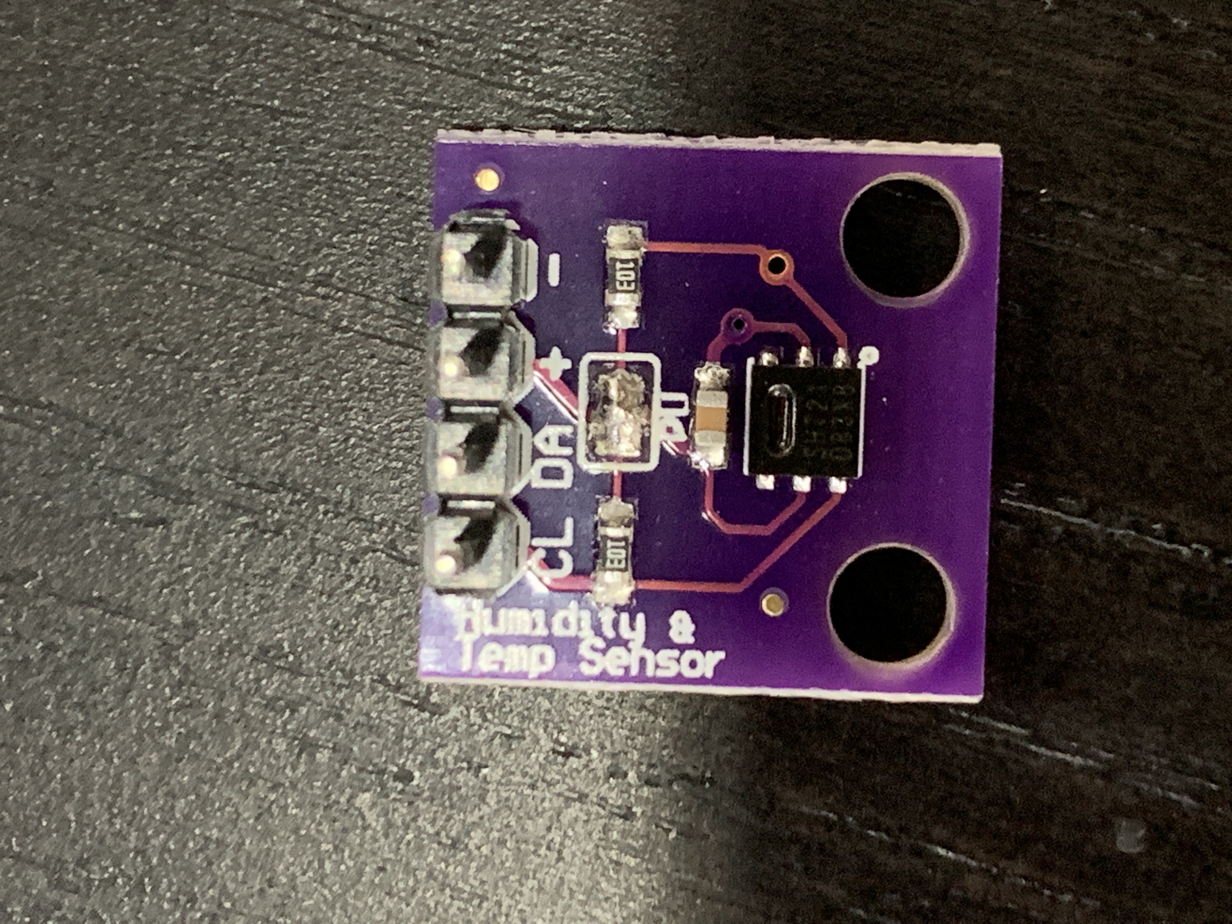

CCS/CC2650: Cannot obtain values for temperature and humidity using CC2650 launchpad with sensor SHT21 when calling func. I2C
Part Number: CC2650
Other Parts Discussed in Thread: HDC1000
I've developed in CC2650 launchpad using project (SensorTag ).
and use ble_cc26xx_2_00_00_42893 version sdk.
C:\ti\simplelink\ble_cc26xx_2_00_00_42893\Components\ti-rtos\boards\sensortag\Devices\sensor_sht21.c

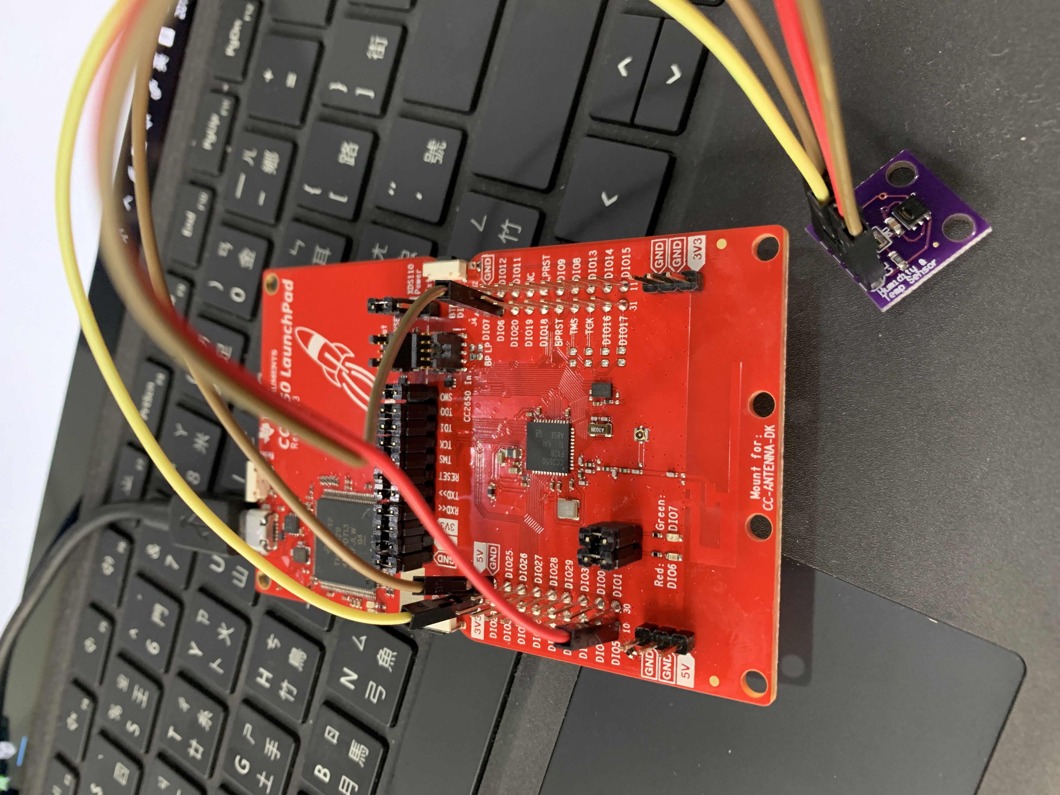

Pin assignment below,
SCL -> DIO6
SDA -> DIO5
Getting values for temperature and humidity using simple code named 'sensor_sht21.c'.
I called the function for getting values as below:

Unfortunately, it can't return the values, and I found a problem when tracing code
bool sensorSht21Init(void)
if (!SENSOR_SELECT())
return false;
// Set 11 bit resolution
success = sensorReadReg(SHT21_CMD_READ_U_R,&usr,1); // Always return false HERE
if (success)
usr &= USR_REG_RES_MASK;
usr |= USR_REG_11BITRES;
success = sensorWriteReg(SHT21_CMD_WRITE_U_R,&usr,1);
SENSOR_DESELECT();
return success;
I cannot get values for temperature and humidity when calling function I2C using CC2650 SensorTag.
Besides, tried to use a module HDC1000 when calling I2C, and it works.
Can you help me for cairlfy where is the problem?
