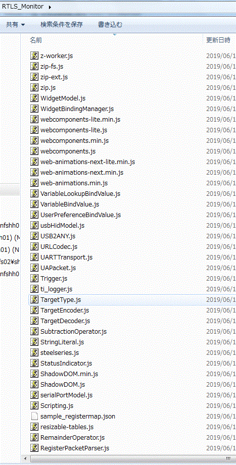

I'm trying to save a log of RTLS monitor(AOA) in the form of csv by clicking "Save events" button.
(See the following image)
However, the Recorded Time of the saved csv file is 2-3 minutes early than Actual Time of clicking "Save events" button.
Thus, I'm in trouble because I cannot get log data in exact timing.
E.g.) I clicked "Save events" button at 13:54:30 and clicked "Clear event" button at 13:54:40.
But I have gotten the saved csv file from 13:52:34 to 13:53:12.
Why is the offseted Time recorded in csv file??

  • Hi Shoko,
    Either way, the time stamps that you are receiving are not the actual radio core time stamps of the samples taken, just the time stamps for when the GUI received the data.
    If you'd like to get a more accurate time stamp I would recommend editing the source code on the embedded side to include time stamp data.

  • Hi Shoko,
    The GUI is an example implementation, in order to demonstrate capabilities and show how it could be done.
    I would recommend using the CLI and run the python example where you can tweek or change the time stamps to fit your requirements.

  • Hi Yuval,
    Thanks fot reply. I understand that the GUI is just an example.
    I want to revise the program of the python example that you say.
    Please let me know which files in "simplelink_cc2640r2_sdk_3_10_00_15" folder should I revise.
    Or
    I want to revise the Javascript file in "guicomposer" folder that I installed.
    Please let me know which files should I revise.
    Please advise. Thank you.
    Shoko
  • Hi Shoko,
    Take a look at the SimpleLink Academy in regards to running the rtls_agent from source:
    dev.ti.com/.../rtls_intro.html
    There, I would start by taking a look at rtls_example.py, and taking it from there.
    Yuval

  • Hi Shoko,
    Any general python code to get a time stamp will do it. For example:
    import datetime;
    ts = datetime.datetime.now().timestamp()
    print(ts)
    You can add it under:
    identifier, msg_pri, msg = subscriber.pend(block=True, timeout=0.05).as_tuple()
