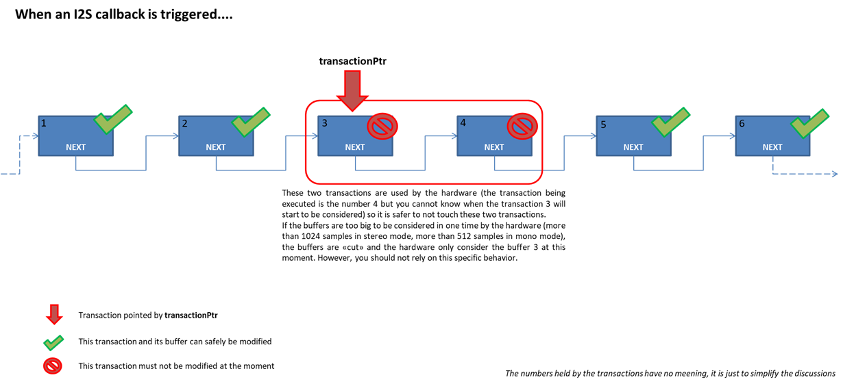

  • Hi Clément,
    Could you help to clarify the issue?
    You can see that I have eight I2S_Transaction (i2sTransaction1 -i2sTransaction8) and I set the i2sTransaction1(buf1) as the first read-transaction. In readCallbackFxn(), I have confirmed that the first transaction is i2sTransaction1(buf1),  but I can't deal with this transaction, I must to use the previous one, otherwise it will generate noise.
    Thanks.
    BR
    Trevor
    When you receive a read/write callback, the transaction (buffer) pointed by transactionPtr is *NOT* the transaction finished but the transaction that just began.
    In other word, if you access the data in the transactionPtr’s buffer you have good chance to run into problems. To avoid this, the data that should be used is the data stored in the buffer of the transaction before transactionPtr.
    I enclosed a small picture showing this:
  • Hi Clément,
    I got it, thanks for your detailed explanation.
    BR
