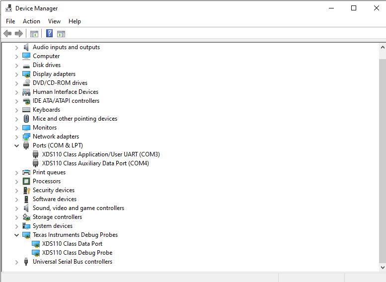

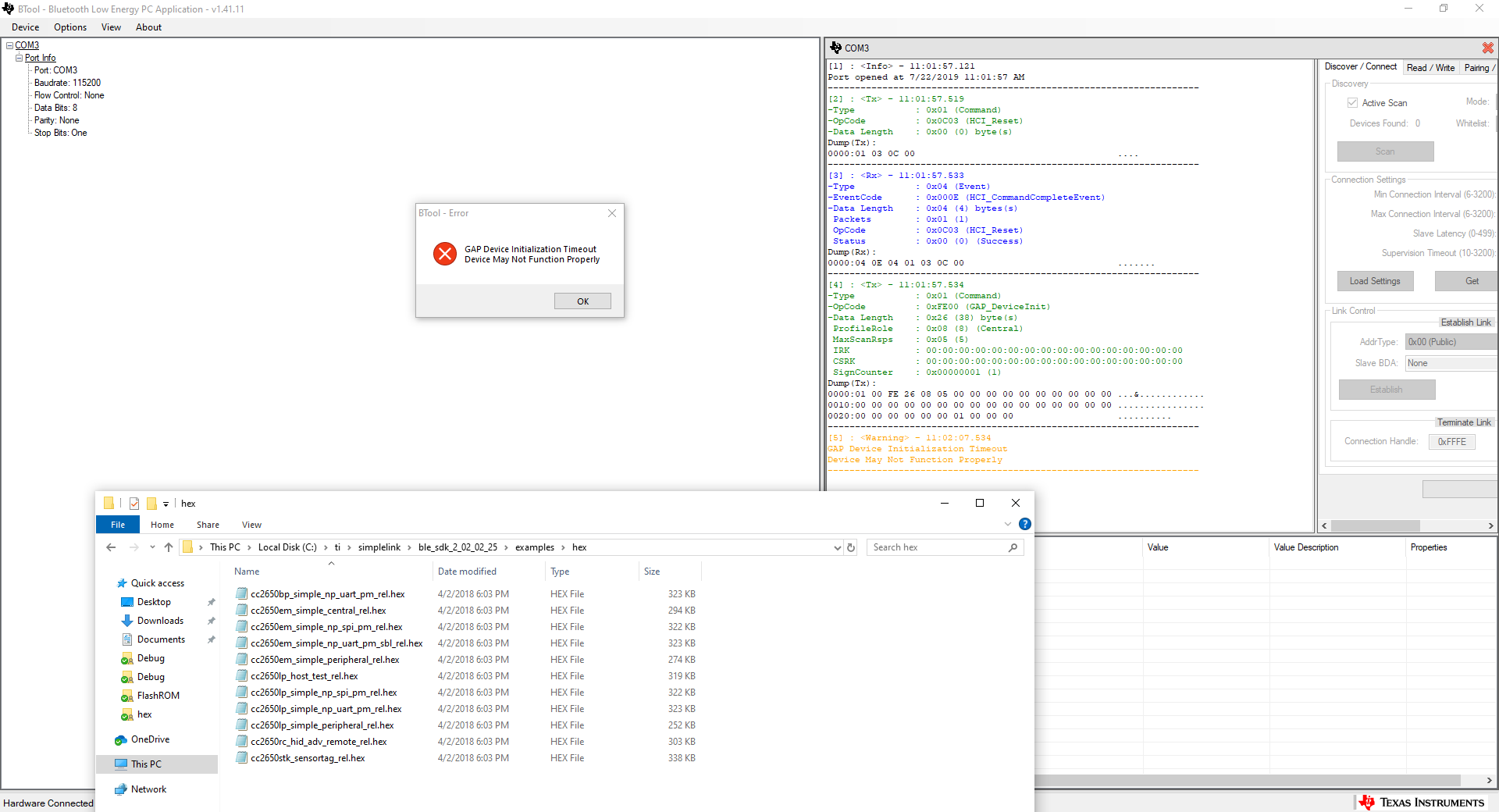

  • As you can see in the screenshot, I tried with the same versions
    My apologies that this is not working for you. I will ask some followup questions to help you verify further.
    Can you verify that you are using a CC2650 LaunchPad? What is the version or revision number?
    Can you confirm that you are not using the CC2640R2F? Have you attached BTool to the user/UART COM port of the LaunchPad?
  • Can you verify that you are using a CC2650 LaunchPad? What is the version or revision number?
    Yes. Revision no is Rev:1.2
    Yaa Its at com 3.
