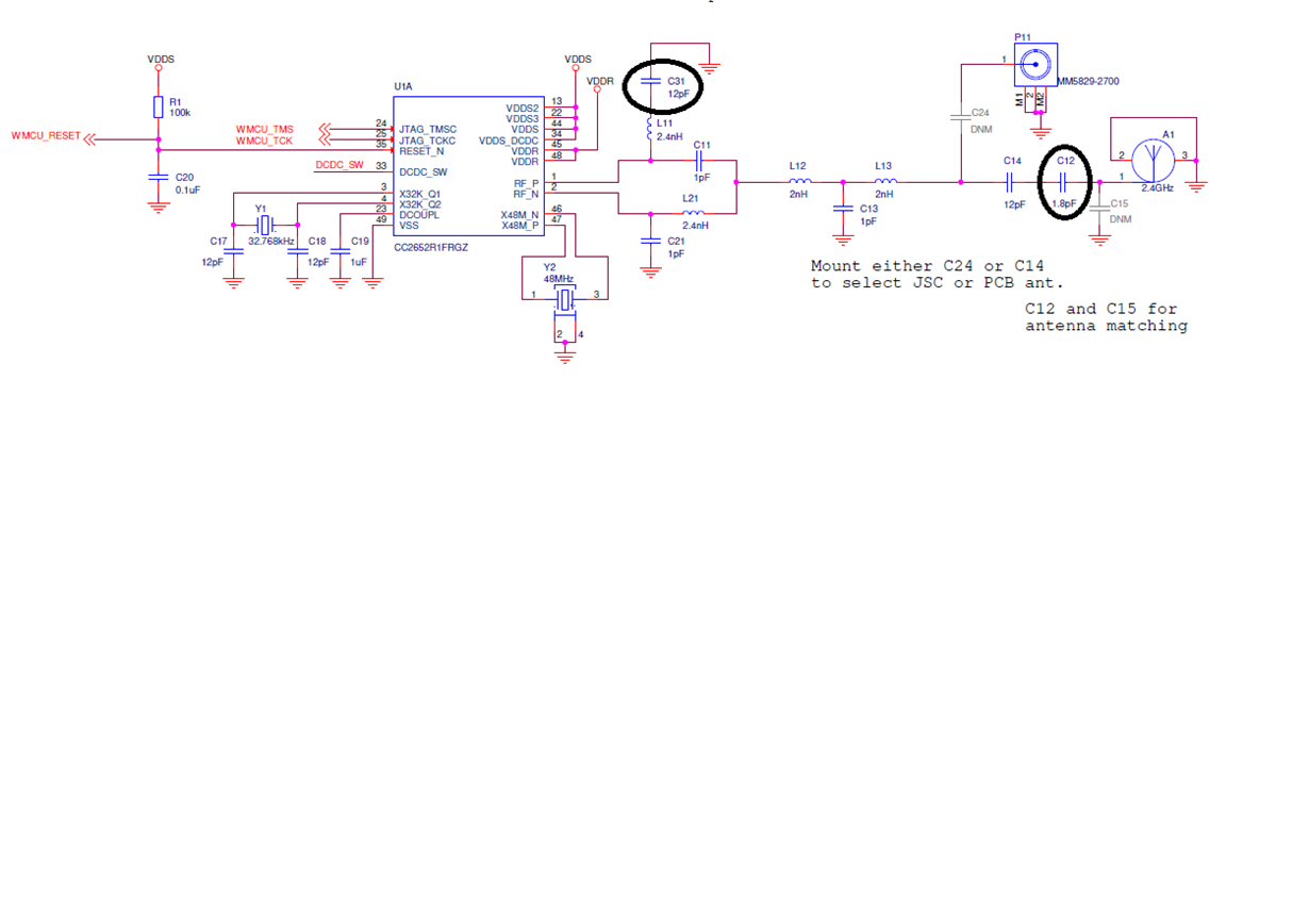

Presently I have a custom board based on CC2640R2F. I want the same board to work with CC2642R as they are pin compatible and I just have to change some passive components values.
But according to the below reference design of CC2642R I have a couple of doubts.
1. In my current design of CC2640R2F the value of C31 is 6.8pF and in the below design of CC2642R it is 12pF. Is it mandatory to use 12pF for CC2642R design ?
2. The C12 capacitor in the below design is not present in my current design. Is it mandatory to have C12 in CC2642R design ?
