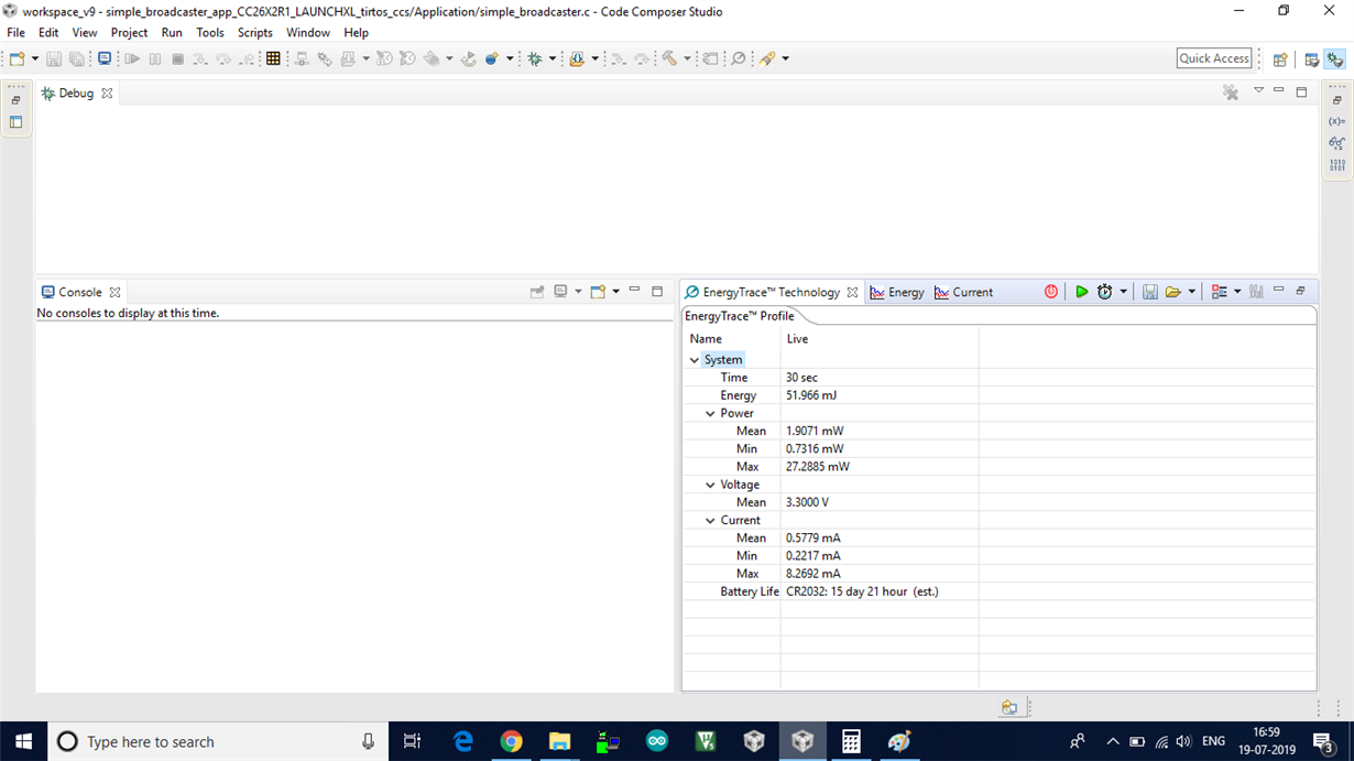

We are struggling to find the right BLE product from TI portfolio which can provide us a stable BLE beacon product.Our concerns- Battery Life and Stable code.

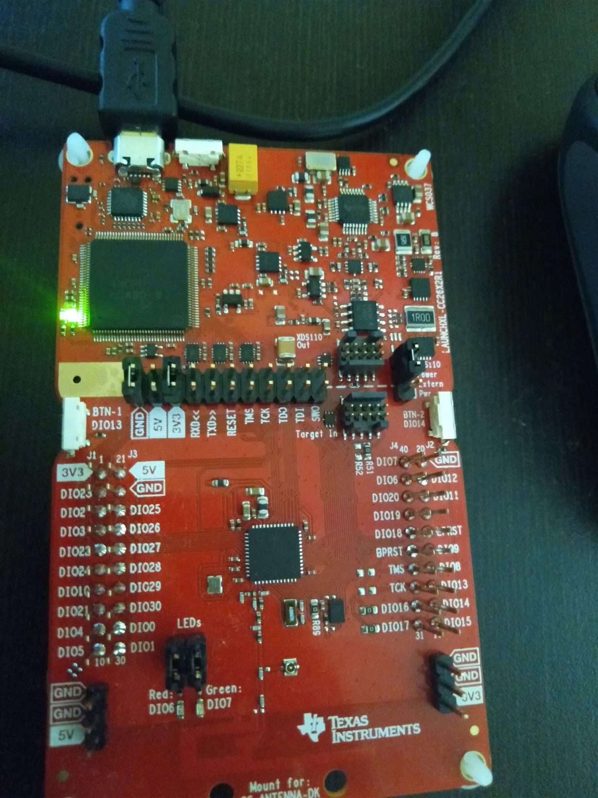

We have already spent 4 months working with 2650,2640,2640R2f, As per industry standard BLE beacons are supposed to work for a year atleast with CR2032 battery. Energy trace as per below screenshot shows 10- 15 days. Energy trace, launchpad used in standalone mode and debugger is OFF
How can we move forward with our design, with this.. Await your prompt help...
