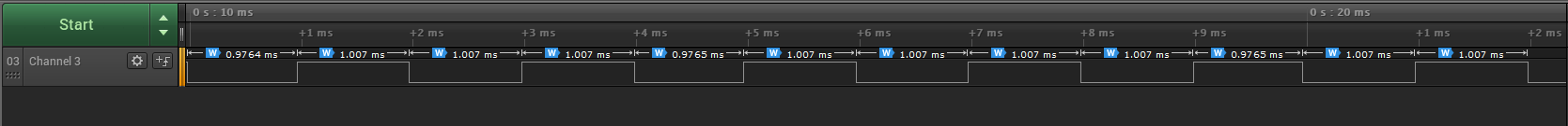

  • In my application, I'm running a periodic clock of 1 ms timeout continuously. For each timeout, I toggle a GPIO pin and I have traced the output in Logic Analyzer.
    I see that Timeout value is always not the same. Sometimes it is 1.007ms, in some cases it is 0.9765ms.
    Since I'm using crystal EPSON FC135 for RTC, I expect  ~20uS deviation at room temperature.. But this is nowhere matching with the logic analyzer output. Can you shed some light why we see 1.007ms/0.9765ms for 1ms Timeout. ?
    If suppose, this additional delay happened because of Gpio toggling, it should be constant all the time. But its not happening so.
    I see, the periodicity always follows a pattern.
    T0 - 1.007 ms
    T1 - 1.007 ms
    T2 - 1.007 ms
    T3 - 1.007 ms
    T4 - 0.9765 ms
    T5 - 1.007ms
    T6 - 1.007ms
    T7 - 1.007ms
    T8 - 0.9765ms
    T9 - 1.007ms
    T10 - 1.007ms
    T11 - 1.007ms
    T12 - 0.9765ms
    and again this sequence repeats.
    Kindly detail me with reply why we see this behavior.
    If some calibration done in software, can you detail me how this calibration works.

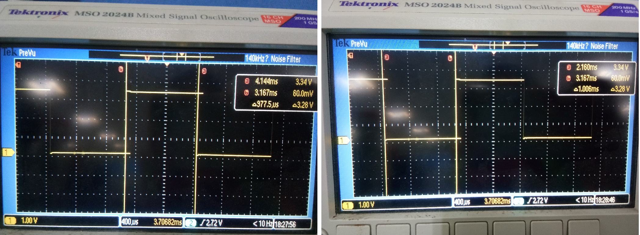

  • Btw, before I look into the code, are you sure you are measuring this correctly? I have had issues before with limited samplings rate on the logic analyzator, have you calculated the error you will have with the settings you are using?
  • I haven't calculated the error.
    But I have cross verified the results using an oscilloscope.
    I have attached the screenshots. Kindly have a look.

    Fyi, I have disabled Gaprole and BLE tasks as I dont need them.
    You need to replace main.c file, and trace IOID_2 output in logic analyzer/oscilloscope.
  • - Any reason why you are using a fairly old SDK?
    - Have you tried to do this based on the empty example? Not sure how the stack impact the timing.
  • - It is quite old project which uses the SDK version what I mentioned in previous comments.
    Can you ensure that these delays wont be seen, if we use latest SDK.?
    - Yes, I have tried to run below code alone in main. But still I see same behaviour with timings
    #define TEST_PIN IOID_2
    static const PIN_Config GPIOPinList[] = { (TEST_PIN | PIN_INPUT_DIS | PIN_GPIO_OUTPUT_EN |  PIN_GPIO_HIGH | PIN_PUSHPULL | PIN_DRVSTR_MAX), PIN_TERMINATE };
    static PIN_Handle GPIOPinHandle;
    static PIN_State GPIOPinState;
    static Clock_Struct periodicClock; /**< Timer handles for Periodic measurements */
    volatile bool toggle = TRUE;
    static void App_init(void);
    int main()
      PIN_init(GPIOPinList);
      App_init();
      /* enable interrupts and start SYS/BIOS */
      BIOS_start();
      return 0;
    static void ClockHandler(xdc_UArg arg)
      toggle=!toggle;
      PIN_setOutputValue(GPIOPinHandle, TEST_PIN, toggle);
      GPIOPinHandle = PIN_open(&GPIOPinState, GPIOPinList);
      Clock_Params clockParams;
      Clock_Params_init(&clockParams); /*Setup parameters*/
      clockParams.startFlag = TRUE;
      clockParams.arg= NULL;
      clockParams.period=((1) * 1000) / Clock_tickPeriod;
      Clock_construct(&periodicClock, ClockHandler, ((1) * 1000) / Clock_tickPeriod, &clockParams);

    I built the application using IAR. I have traced out IOID_2 GPIO output from Hardware in logic analyzer. Hope this information helps.
  • The file name is main.c and not 8015.main.c. Somehow number got appended to file name while attaching the file.
  • I have looked some more on the code and also run some measurements.
    If your task is to measure the impact of the ppm of the 32 kHz xtal this is not the ideal way to do it for several reasons:
    - You will have a jitter equal to 1 clock tick (10 us)
    - The clock module is software based meaning that you get TI-RTOS dependent delays in the transition between HWI to SWI and how the SWI is handled
    - The callback will not be started on a deterministic time, this will dependent on what else is going on in the system.
    - The software dependencies will increase if you run the BLE stack compared to running it in an empty example with only one task.
    The preferred in this case is to use the GPTimer which is a hardware module. You can also mux a timer event directly to a pin meaning that you can measure without the CM3 impact the timing.
